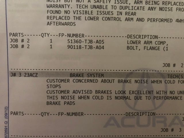

Will do. The only thing I have heard back is that they were able to reproduce the creaking from the steering wheel and fixed it (I'll ask what it was when I get it back), said they are not addressing the squealing brakes and it is considered normal, and they were able to reproduce the front suspension noise and it was likely control arms/bushing (which they will tell me about availability). They were not able to reproduce the rear suspension noise but there would check the suspension components. I'm not surprised by the last part because that only happens intermittently.

Parts replaced

Originally Posted by fogdoctor
thats a left arm?
Old Mar 20, 2020 | 01:11 PM
  #179
russianDude's Avatar
Joined: Jun 2001
Posts: 6,928
Likes: 853
A05 might be yet another revision, wow

  #180
fogdoctor's Avatar
Joined: Feb 2020
Posts: 156
Likes: 37
From: Philadelphia
thats a left arm?
Yes. Left.
I had to wait a week for it. Back ordered.
Old Mar 20, 2020 | 03:55 PM
  #182
Joined: Jun 2001
Posts: 6,928
Likes: 853
yep, found my invoice from November, and I got A04. Thats a 3rd revision. Mine works good, but perhaps it will go bad again given thar you have undated part

The dealer I took it to fixed everything that was reproducible except the squeal, which they are no longer fixing. The alignment was also slightly out of the left rear, which they also fixed.
I just finished giving it a good drive and there are no noises from the left front suspension at all at any speed. I took it over bump that would make the noise and it's gone for sure. The noise from the steering wheel is also completely gone (lock to lock). The steering wheel had some kind of spacer installed to correct fit that had no part number. The noise from the rear suspension was intermittent and has become less frequent so did not expect a fix. They noted checking the components and going general maintenance but no issues were found.
Curiously, the brakes have not squealed since I brought it back today but it has not had an overnight with me as the first driver. I'm sure the squeal will be back.

Cant believe they had to make 3rd revision for the part. That means all the replacements they did before will fail sooner or later

Hmm, I can't find 51360-TJB-A05 on oemacuraparts.com, or on other acura parts sites. They only have 51360-TJB-A04, was it A05 released just recently?

First they had A03, then A04, now A05?
When they replaced mine few month back I got A04, and so far its good, but I wonder if it will last since A05 is out

Got it out of the shop today, both lower control arms replaced with the A05 parts and an alignment. We will see how long it lasts. Fingers crossed!

at least you got latest part, I had both lower arms replaced with 2nd revision A04 couple month back. No noises, but if they made a new revision I am expecting mine will fail sooner or later. Hopefully while its still under warranty
