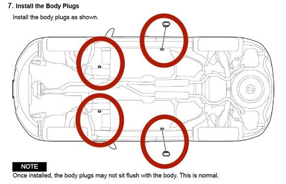

body plugs need to be installed by your dealer when they perform TQI.
for most people updated lower arms take care of the issue. RDX is a great car, couple visits to the dealer to take care of the minor problems is not the end of the world. You can take care of squeaking lower arms at any time, it’s not a safety issue
I really hope so, I want to love this car I really do. Could I have went Mercedes, Audi etc..sure but the features just are not there for the same price.
On your vehicle how many body plugs do you have installed. I have 6 installed right now 3 on each side. Just curious as the TQI shows either 2-4 spots to install but there are 6-7 holes depending if you have a spare tire

I only have plugs that are shown in TQI, we think that others should be left open by design
So do you have 2 or 4? It seems in the TQI photo there are two that have arrows pointing but if you look close towards the front of the vehicle there are two more bold black circles indicating maybe two more plugs should be installed there. Circled them in red.
