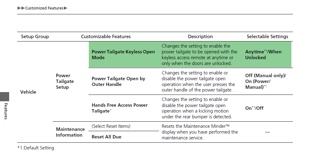

You can also try changing a setting in the car to require that the doors are unlocked before allowing the tailgate to open, then always lock the car when its in the garage. It should help prevent accidental opening by requiring the door unlock button to be pressed first and within so many seconds (before auto re-lock) of the tailgate button being pressed. Find it here: Settings -> Vehicle -> Power Tailgate Setup -> Power Tailgate Keyless Open Mode -> When Unlocked

If you want to discard the issue, change the settings to open liftgate only when vehicle is unlocked.
This happened to me, but never knew if the issue was the remote pressing onto something, after changing the setting, it never happened again.

Thanks! I found and changed the setting. Hopefully it won’t happen again.
