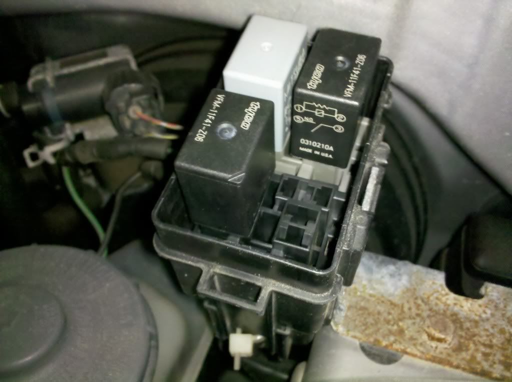

ALSO! None of my gauges' lights are coming on either except the little window under the speedometer, which has my miles to date, miles on the trip, the door (open) indicator. All my other gauges lights and my dash lights are all out (including audio, climate control)! here are the pics of what I think got burnt out or went out.
Am I right?

Just check the fuses. Look in your owner's manual. I believe there are 3 fuse boxes, 1 at ea. end of the dash & 1 under hood. If you have a meter check them with that if it's not obviously open when you look at them.

every fuse box has a diagram on the inside of cover
every electrical system will have a fuse and most run thru a relay now, those square things.
you can swap one with a matched unit for testing
harbor freight tools is giving away a multimeter free, ck your coupons in newspaper or mail
or spend the few dollars to get one and test the fuses
they control more than the item listed on diagram-
