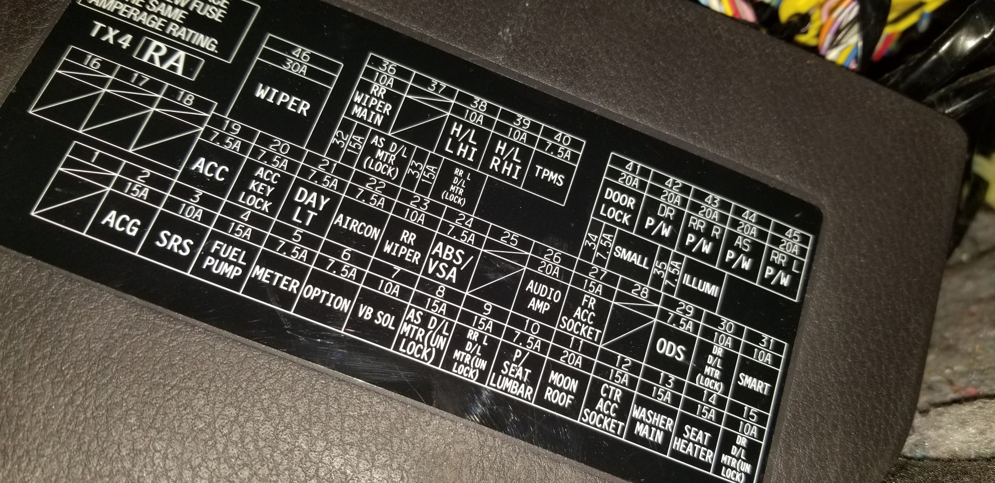

I didnt install or replace any led or standard bulb recently. If it was the fuse I have no idea which number fuse it will be.
Old Oct 14, 2019 | 10:45 AM
Posts: 48,313
Should be #34 (Small Lights) fuse or perhaps #35

If the wiring is the same for your 2014 as it is for my 2017, fuse 34 protects the tail lights, the brake lights, and the license plate lights in the rear, and also protects the front marker and turn signal lights. So based on your described symptoms it seems like something other than fuse 34 is wrong.

Look like is the 34 fuse have blow have to get fuse tomorrow morning to find out if that really is the one.

Just got it done. It is fuse #34. Thank you for helping.
