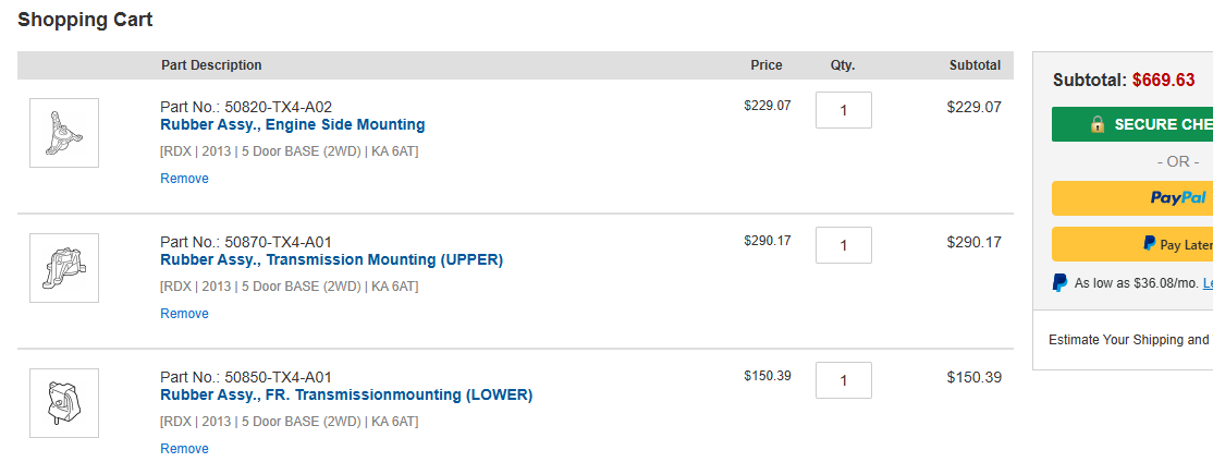

Find each mount OEM part # on the website below and shop them on RA.
Genuine OEM Acura Parts and Accessories Online - Acura Parts Warehouse
Yeah.. I mean I figured OEM is the way to go if possible. I just recently replaced my front with Beck/Arnley from RA since the OEM is ridiculously priced. I don't regret it. But I was told by mechanic that he also recommended that I replace the others as well minus the rear (he thinks I can put that off for now).
Do you have any experience with Anchor, DEA, or Westar brands and which ones I should buy from RA? I might end up going OEM for the side mount but aftermarket for the upper and lower transmission to save some money.

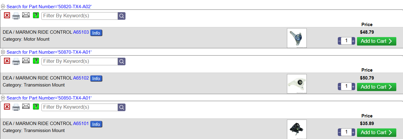

Yeah I mean the only choices from RA are Anchor, Westar, and like you said, DEA. Was there a reason you picked DEA or it was just a toss up 🤣
As you can tell, the price difference between going OEM and aftermarket is huge. Honestly after fixing just the front I'm already darn happy, even with going aftermarket Beck/Arnley. Doing the others will be cherry on top I guess. And yes, I am honestly debating about just having him do all but if he says the rear can wait.. I might just listen to him.. and like I said, the car feels fine? I have a 2013 with 107K miles.

When I searched those OEM part numbers above, on RA's part number search functionality, DEA was the only one's that came up?

Ahh you searched for specific OEM parts numbers. I did a search by drilling into the year, make, and model and it gave me other choices.
For the front Beck/Arnley was the most expensive one out of the other choices (mine was made in Malaysia btw) and I also read from another user they had a good experience so I went that route.
