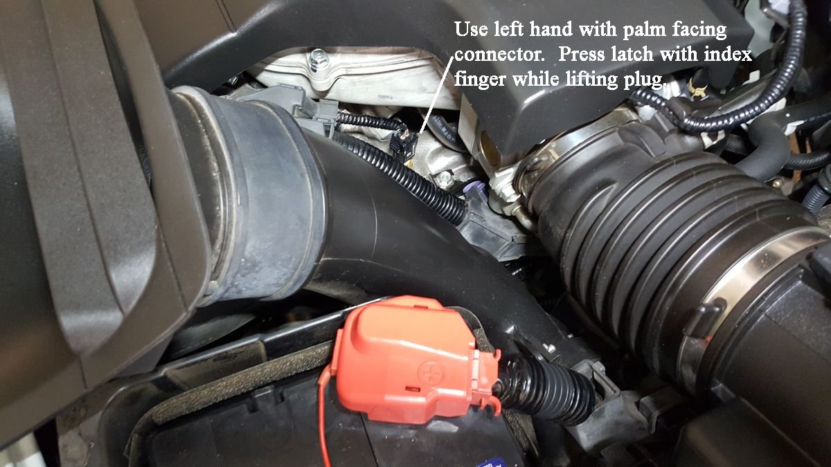

I don’t know about you guys, but I personally think the engine bay on RDX is just not big enough to work with, I ended up with several cuts on my hands. This was not the case on the YouTube instruction video, where the guy just casually installed the thing, like it was a piece of cake, the whole video was just 8 minutes long, which includes his voice-over product introduction. Guess I’m just not mechanically inclined. Anyways, 20 or so minutes later, the little box was resting behind the battery, and the ECT1 sensor had a new spouse.
Now, moment of truth, went all the way the the furthest bedroom to grab the key fob, which, according to the installation instruction, was supposed to be some 30 feet away from the vehicle. Ran down to the garage and started the car. NO CEL on, thank god! Cause the engine was still a little bit warm when I installed the thing, and I was honestly a little worried, because I don’t have an OBD scanner to clear the codes. Lucky me.

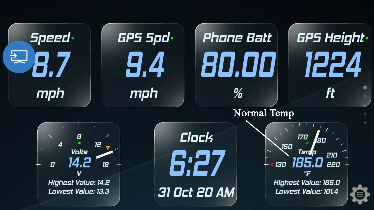

Now I did notice a couple of things. First off, the temp gauge was at the same position as prior vcmtuner installation. Seemed like nothing has changed. I thought it was supposed to be a little lower than usual, but on my car, it just sit right below the middle, about 2 marked lines below the middle line, which was exactly where it was at temp before vcmtuner. And second off, the idle rpm seemed a little higher than before. Attention to details is one of my things, I know that the car idles at 650rpm previously, now it’s somewhere between 680-700 rpm, is that normal?

only thing is, when installing the thing, it’s such a pain to get to the ECT1 sensor, I was this close to give up, and say F it, then drive to my mechanic. So good luck!
I've seen other posts from owners saying they came away from the project with scraped knuckles. In anticipation of this issue I tried unplugging the sensor on my '17 and it was a snap...literally. Reach down with palm facing the connector, press the release tab and lift. Done! Unless I'm an idiot and pulled the wrong plug

Heck I must have unusually big hands, I just couldn’t get it to work in the first ten minutes trying, and when it’s finally done, several cuts on my right hand, like I just murdered someone...

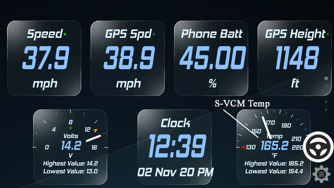

And It's Installed
Bringing this thread back around to the original subject, My S-VCM is installed. It took a whole seven minutes and five seconds. It would have been less except the module comes with several very small zip ties that I burned a bunch of time with trying to use. Note to anyone who does this install in the future, grab a couple of longer (8") zip ties and snip off the extra. You'll thank me later.
Anyway, as others have noted, with the module in there's no more 'downshift jerk' when slowing to a stop. The big change is accelerating from a lazy cruise. That little hesitation while three cylinders light up and begin producing power again is gone. All six cylinders are now working full time.
Here's a picture of the unit installed. It's zip tied to an existing harness.
These pics the before and after temperature reading which means the module is working exactly as expected. It fools the car into thinking the coolant is cooler than it actually it is so VCM isn't activated. The dashboard temperature gauge looks normal.
Old Nov 11, 2020 | 11:11 AM
WhodatTLS's Avatar
Joined: Aug 2013
Posts: 10
From: SoCal
I purchase the S-VCM for my 17. I have not installed it yet. Did you connect the S-VCM to the fuse box, if so do you have pictures. Do you service your car yourself?
My original plan was to use the fuse box but ended up just connecting to the battery. The positive terminal is only a few inches away from the S-VCM module (running the wire 'under' the intake tube) and there's negligible current draw.
The only service my '17 has needed are oil changes and tire rotations that I do myself.
