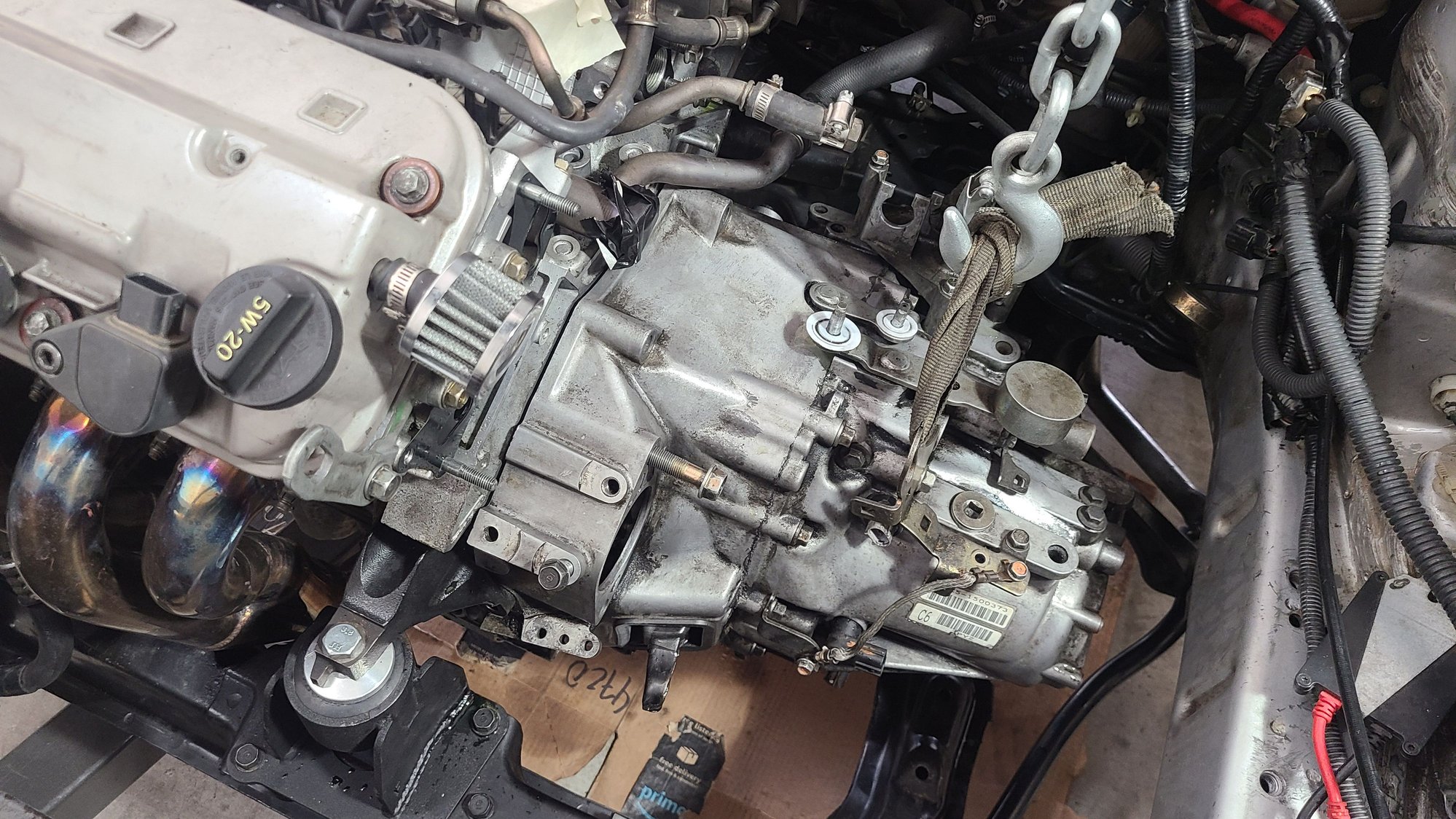

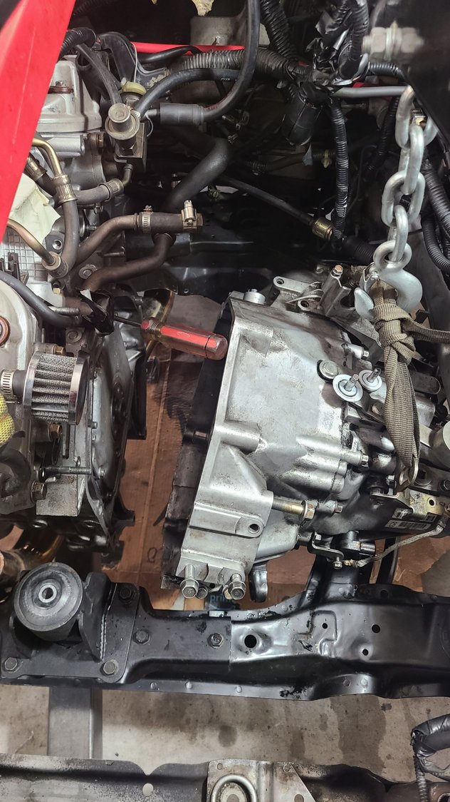

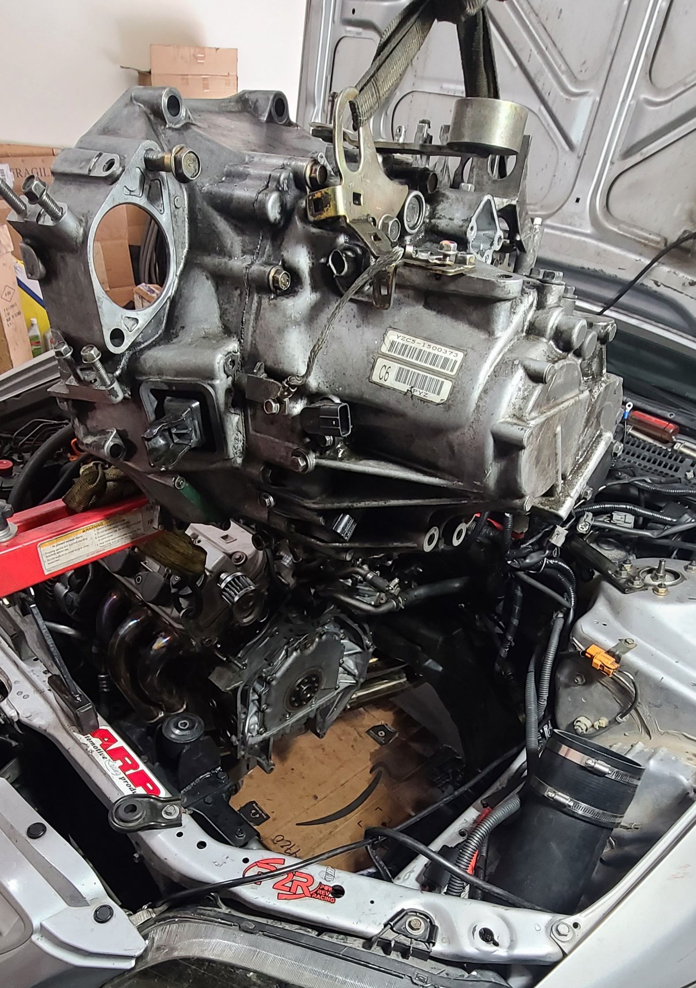

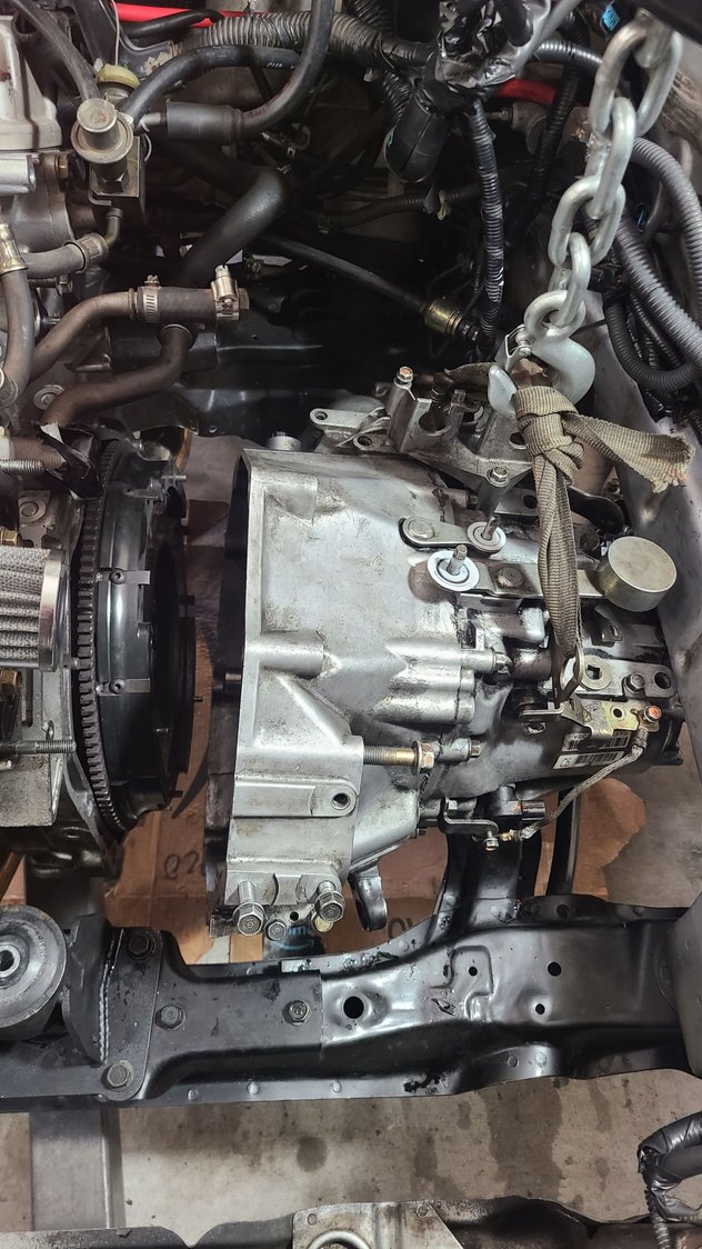

So continuing on the last post. I'm going to first remove the CLS trans. However, this time I decided to try a variation of the 'brother technique' to remove the trans from the top, while still leaving the engine and subframe in. Guess what, it works.
Overview of the process:
1) Drain trans, drain coolant, remove fans & radiator, remove battery (mine is in the trunk), remove starter, disconnect throttle body, unbolt and remove intake manifold.
2) Disconnect all plugs around and on trans, disconnect and move shifter cables. Unbolt and move slave cylinder out of the way.
3) Remove axles and intermediate shaft. Remove driver side trans mounts and lower bolts connecting engine to trans.
4) Support trans from the top two hooks, but do not place too much stress on bolts. Unbolt remaining top bolts from trans and leave in place.
5) Support front head with brace over front corner near the cam cover. Be careful to select something that will not move and crack the oil cap. Unbolt the front mount bracket and remove.
6) Unbolt and remove the reverse lockout solenoid. Be careful not to lose the spring and plunger when separating the housing from the trans.
7) This is where is gets messy, put a pan under the thermostat housing. Then unbolt and remove the coolant inlet/outlet with thermostat housing assy from the heads.
Now it should look something like this
The rest can be explained with pics...
Trans pushed back
Alternate angle.
Clutch removed
Flywheel removed
Up, up and away.
Thanks for all the pictures and nice to see the brother technique can be applied to the swapped Accord!
@Acura TL Builder would be proud of your hybrid endeavor.

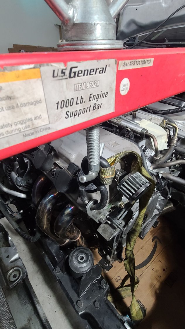

Just curious, what did you end up using to protect the oil cap at the yellow arrow?
It appears to be an extension of the strap on top of the red brace?
Old Nov 11, 2022 | 05:41 PM
619rcr's Avatar
Joined: Jul 2019
Posts: 1,188
Likes: 670
From: AZ
Thanks Zeta,
Yes, the accord is pretty open and easy to work on. Back when I employed the original technique for my 3G TLS clutch replacement, I left the trans in and it took me more than a day to swap the clutch. Primarily because the engine bay space was so constrained, the TLS trans also seemed bigger. It took forever to line the trans back up.
As for your question about supporting the front head, I used the hook end of a hold down strap. The strap was not needed so I balled it up to keep it out of the way. The hook itself was connected to a spare lift point eyelet and bolt I had laying around.
A few other times I've used chain attached to the same bolt hole. But, under the weight of the engine the chain was pressing up against the cap, so I removed the cap and covered the oil fill hole with masking tape.

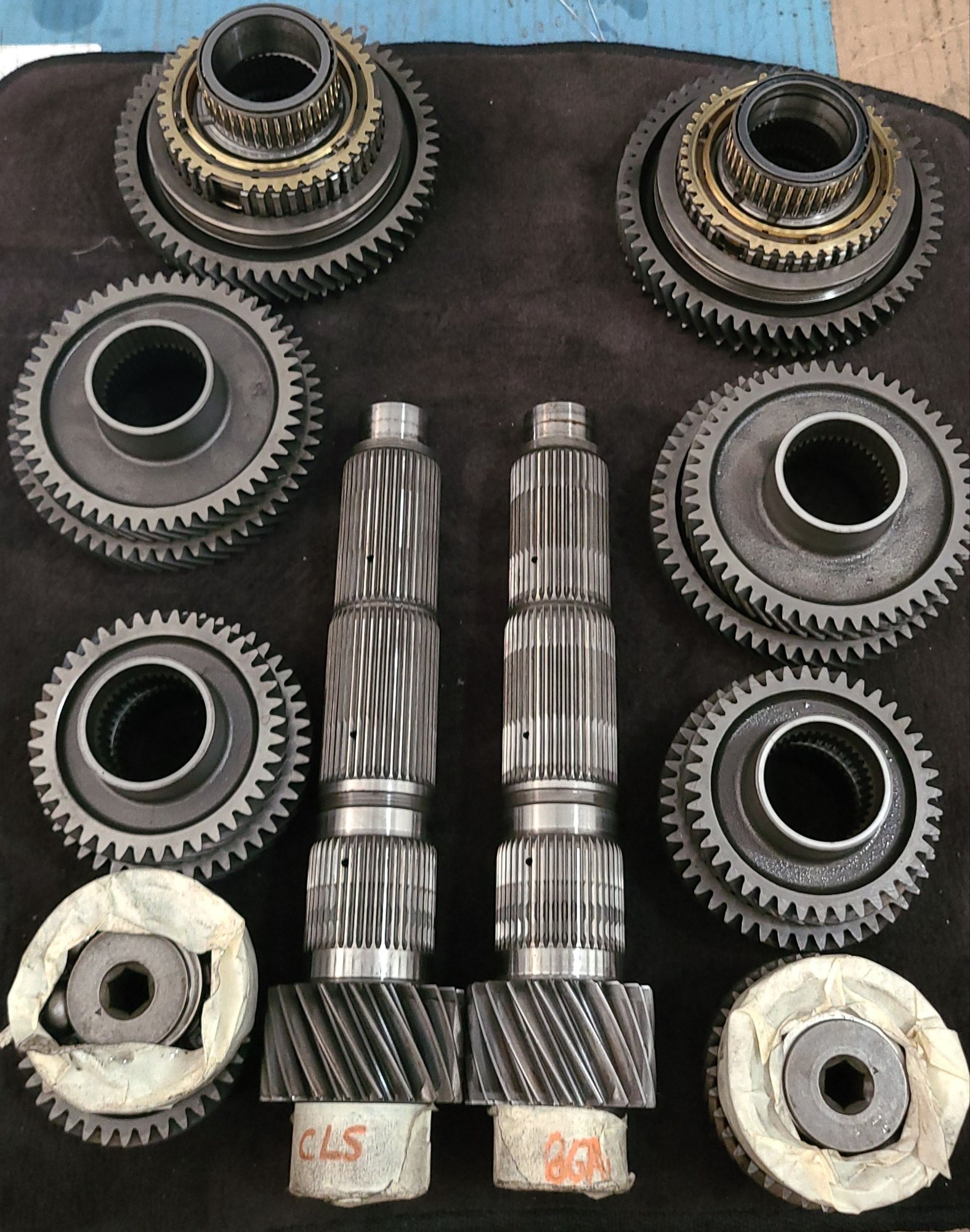

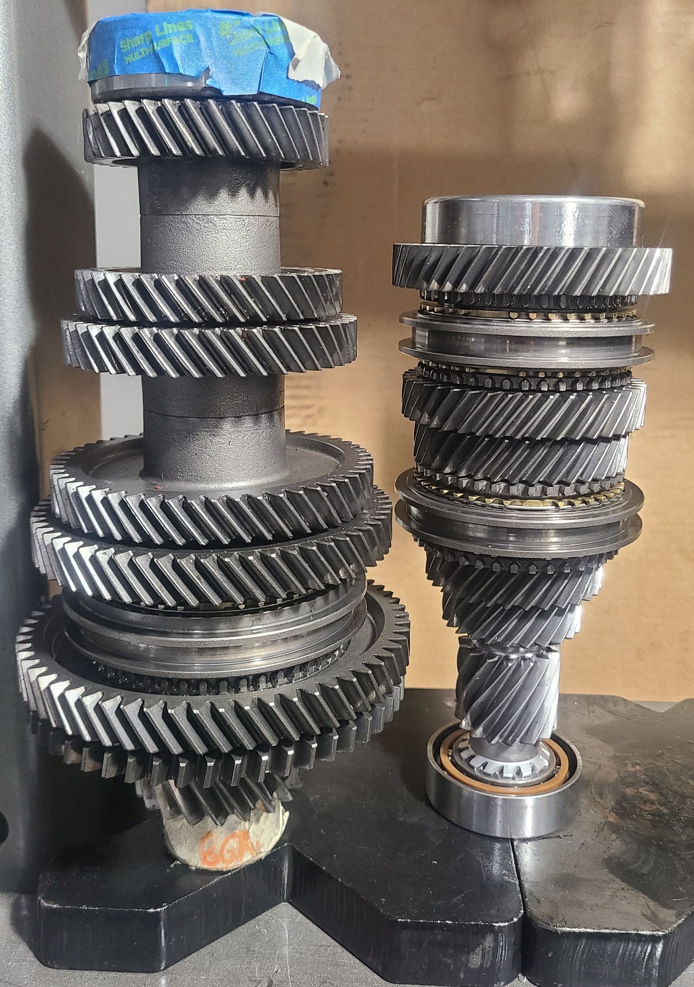

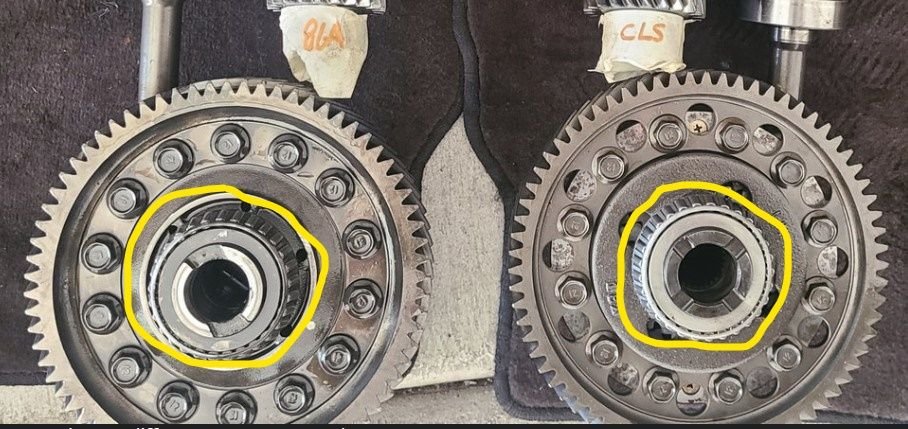

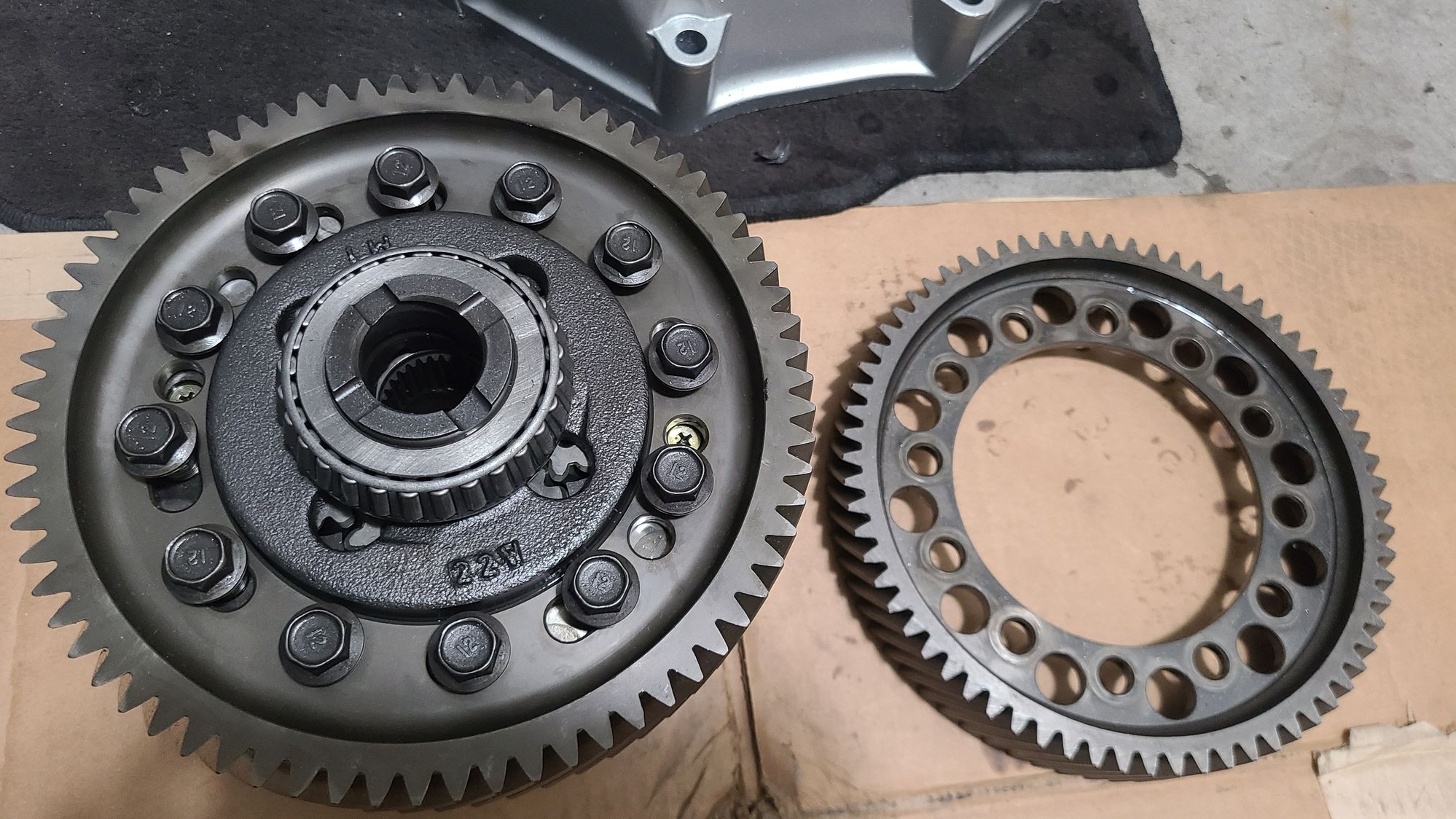

Quick pic of the two sets side by side.
8GA 3.55 w/ open diff vs 2G CLS 3.285 w/ LSD
Also, to no surprise the 2nd gear synchro on the 8G has damaged teeth. Luckily, it shares the same part# as CLS (23432-PYZ-305).

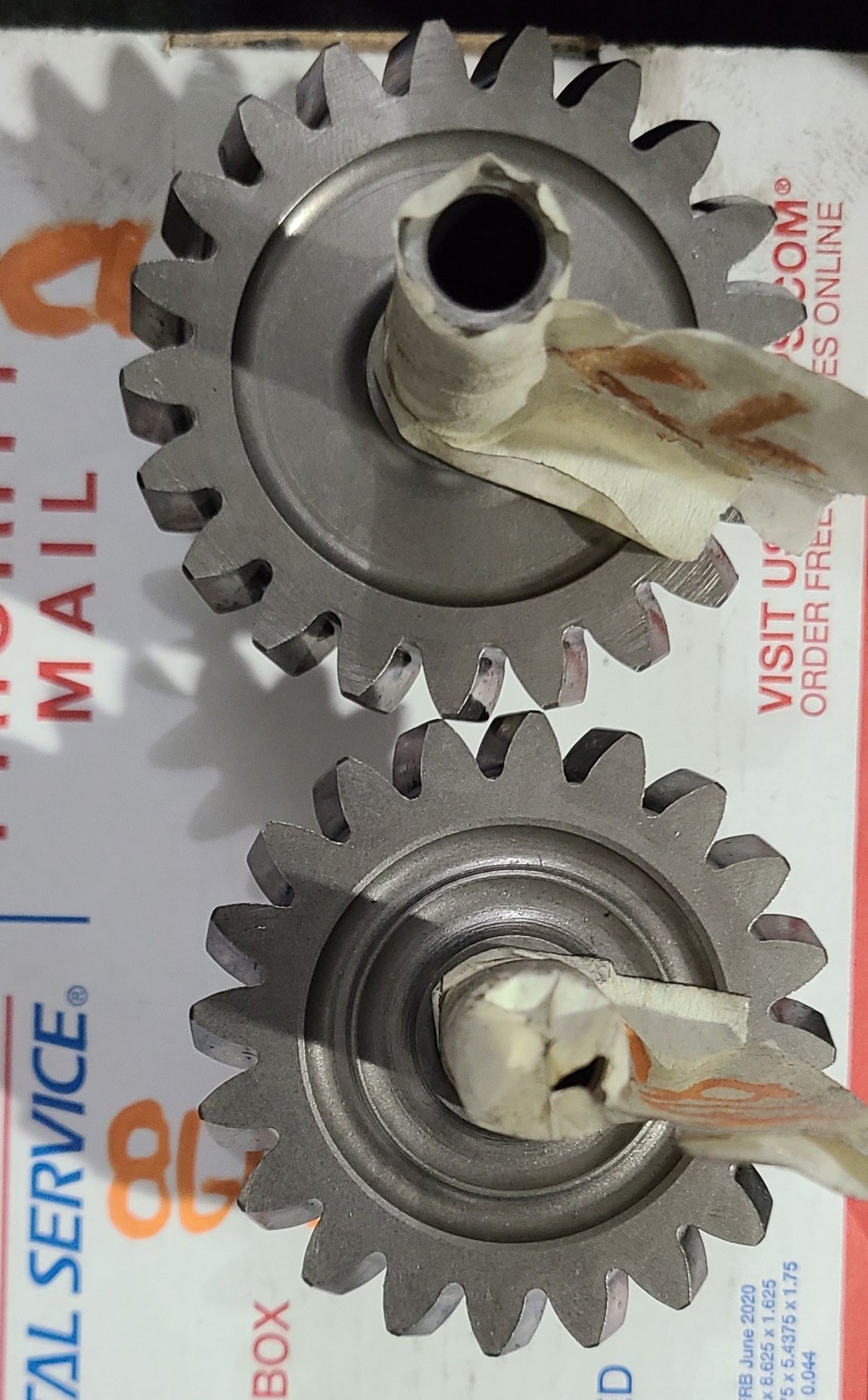

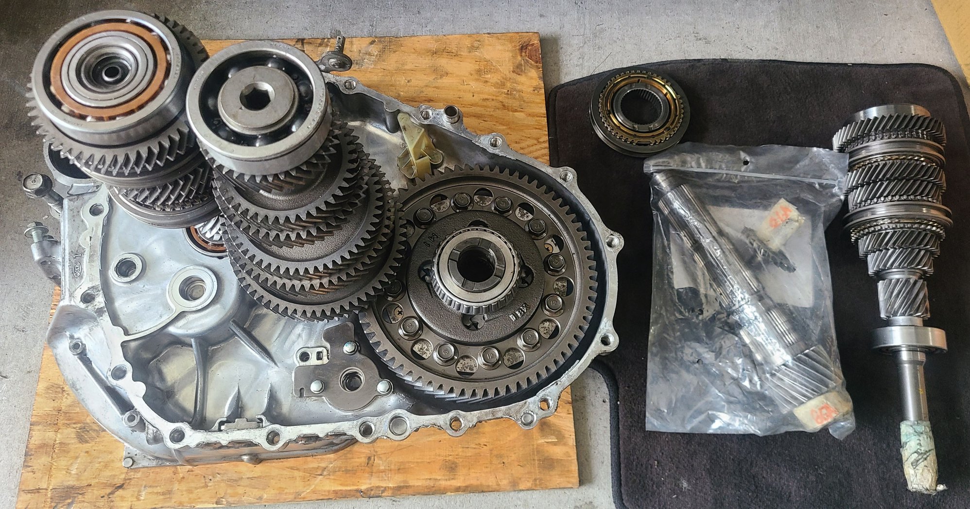

In the interim, finally had time to get both transmissions side by side for some pics.
CLS-6 (top) vs 8GA (bottom).
gear oil pump drives
3.285 final drive (top) 3.55 final drive (bottom)
Trying to wrap up the 8G first, since I should have all the parts now: Stage 1 clutch, LUK fw, new slave cyl, p2r clutch line, front motor mount & p2r egr block off plates.
On a side note, finally installed the fic 650cc injectors and did some street tuning on the J35 6GA.
Anyways, time to get back to work on these cars...

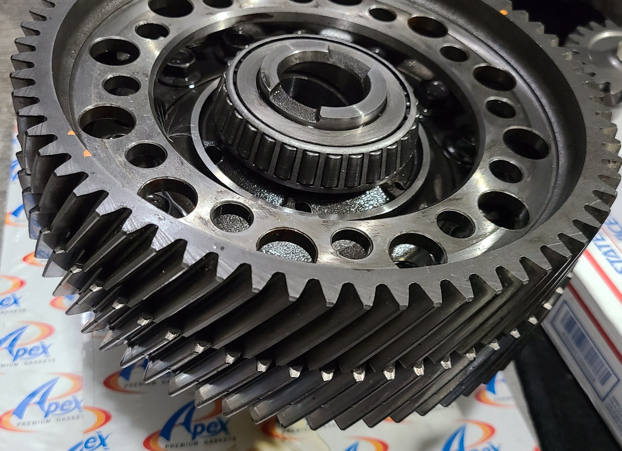

Slight update, final drive swap 1 of 2 is complete:
A spare CLS LSD diff and final drive is now installed into 8GA trans. Stage 1 clutch and new Luk flywheel also installed. Drove the car about 12 miles last night. Surprisingly with the 17" TLS wheel/tire combo the speedometer was in synch with gps up to about 55mph. This meets my goal for this swap.

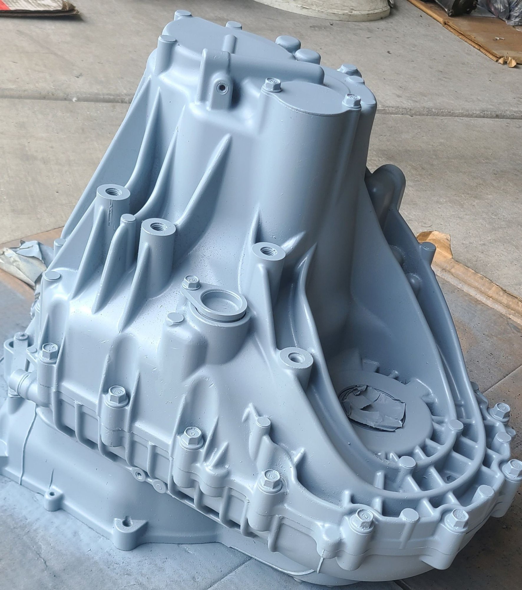

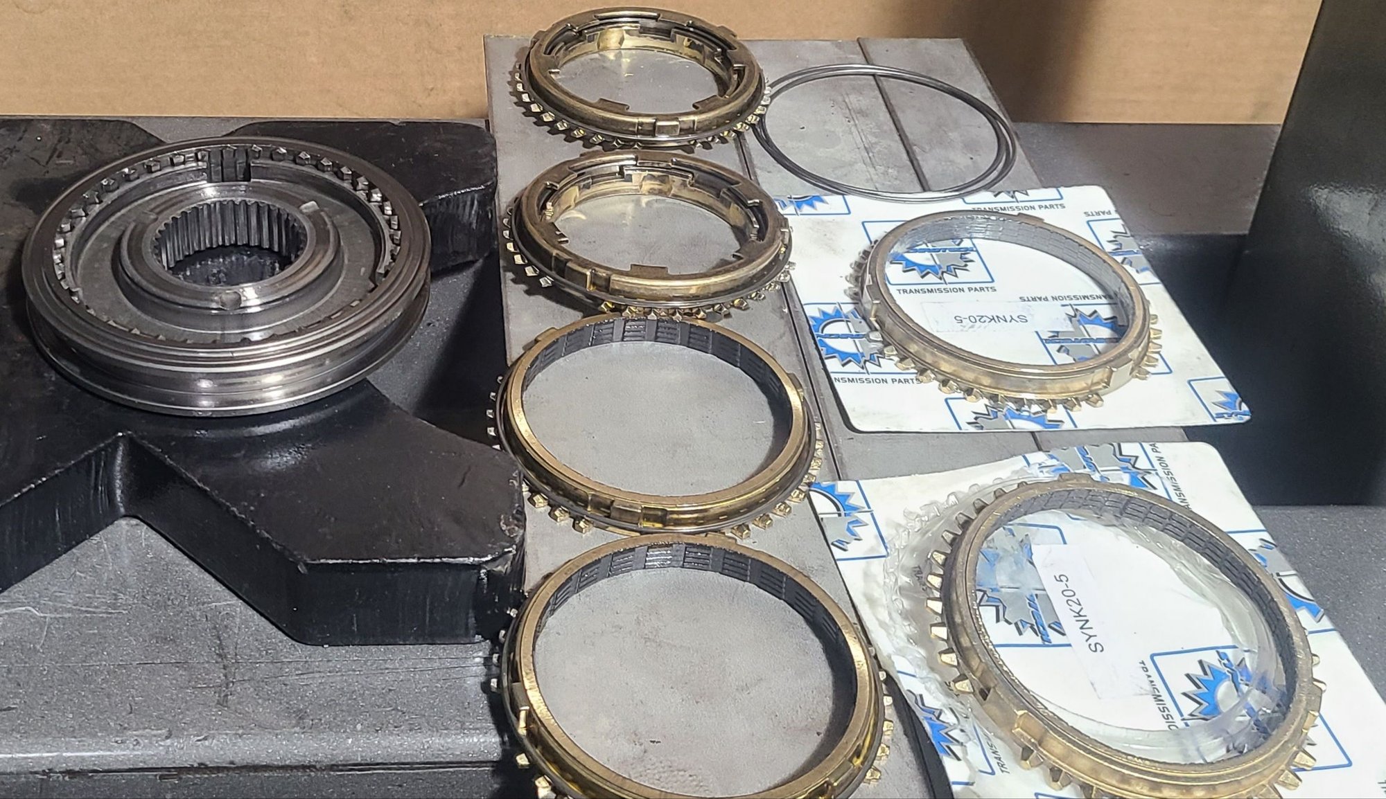

Maybe... while waiting on parts ​​​​been cleaning and painting a bit:
Trans case is primed, but not painted yet:
Also working on swapping all the synchros and springs with Synchrotech parts:

Interestingly, it appears the 5th and 6th gear synchros were replaced at some time. Stock synchros have brass teeth. However this (left) set appears to be aftermarket. Color is similar to Synchrotech (right).
Being that the top bearing practically slides off with no effort, presuming it was the ebay seller who sold an alleged 'low mileage' CLS gearset.
In any case main & counter shafts are back together. In addition to synchros the countershaft was swapped for the 8GA.

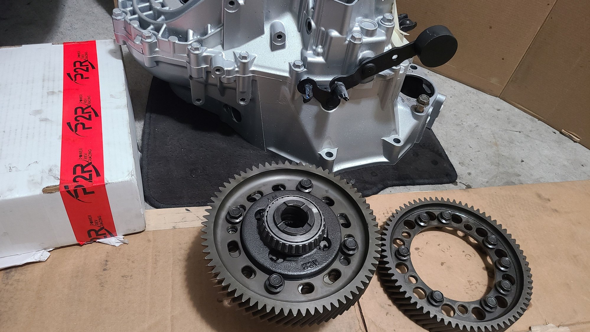

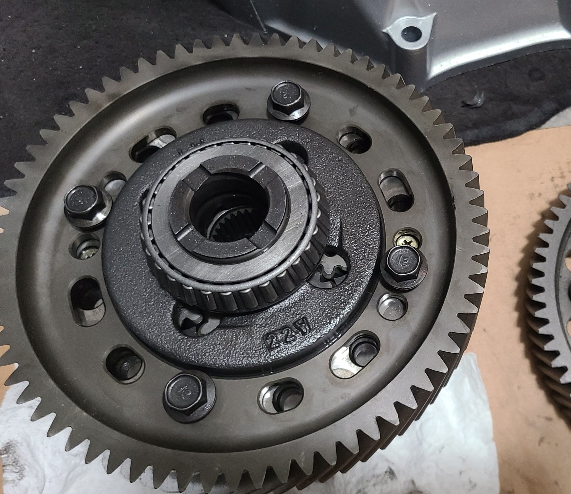

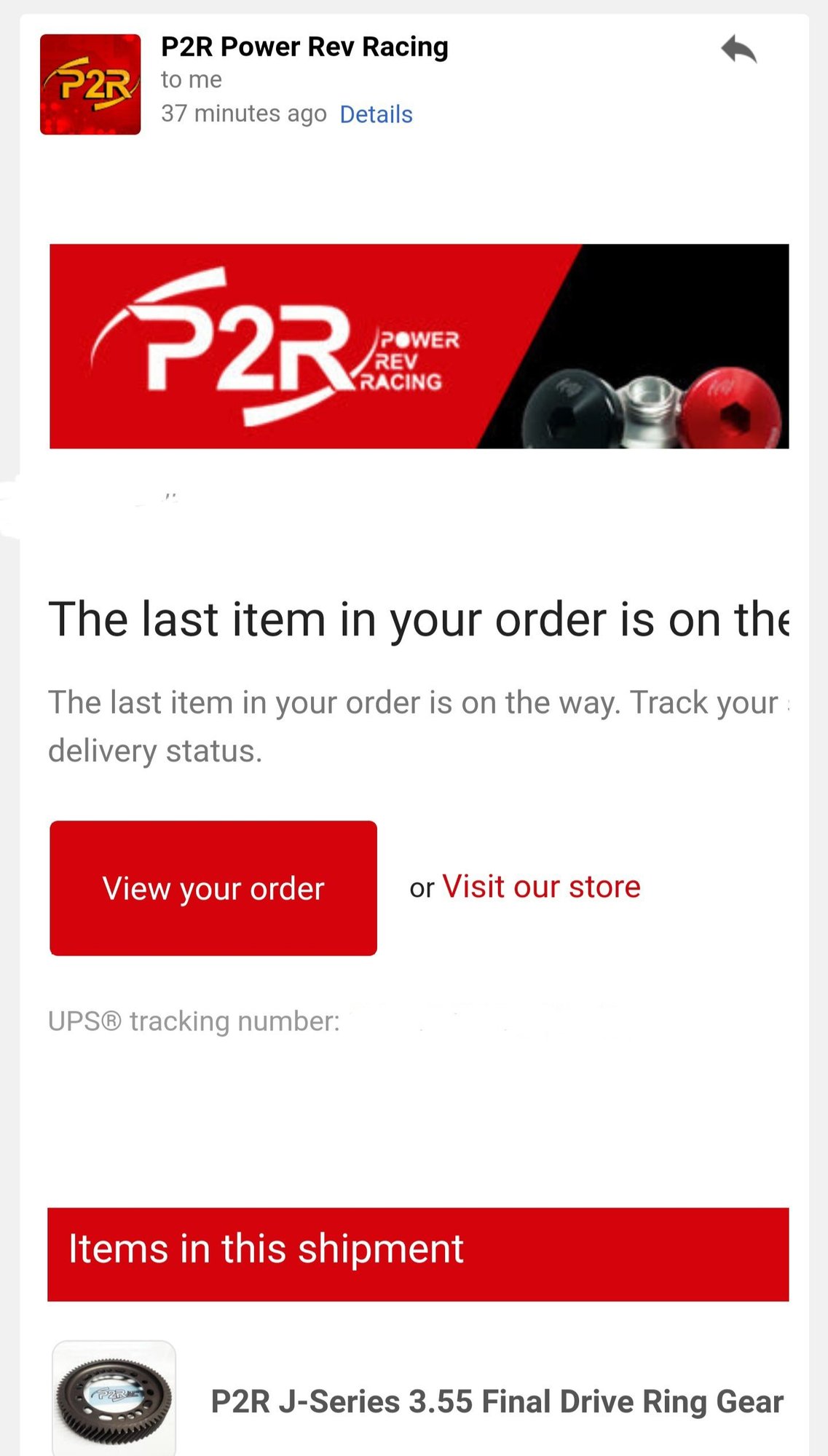

About 10-11weeks later, P2R care package has arrived:
All bolts loosely installed
Big slots facilitate 12/14 bolt differentials
Kind of anxious to feel what difference gear ratio and new synchros will make. But, unfortunately will have to wait for few days due to work schedule.

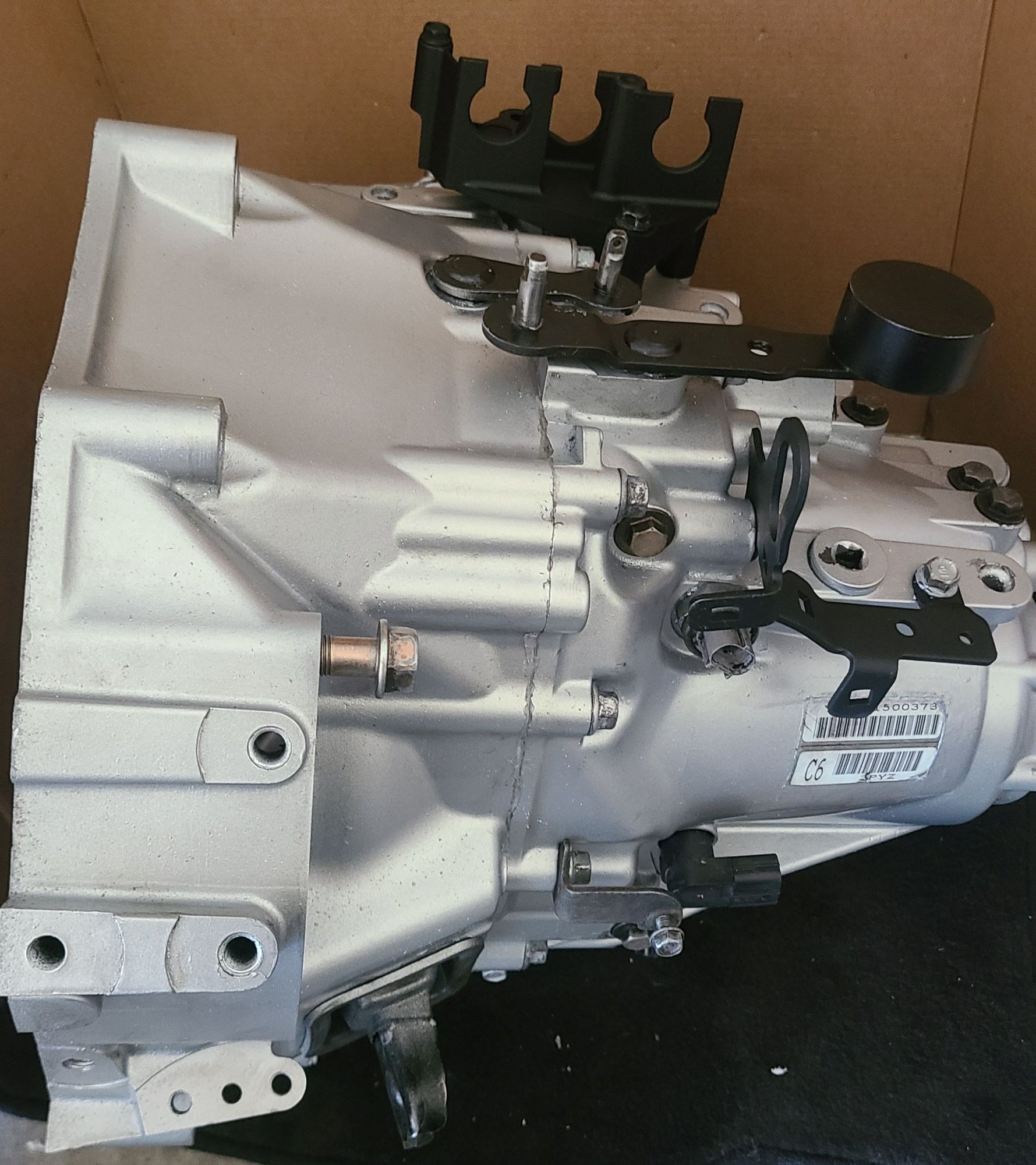

From: AZ
Finally had a day off. Transmission is reassembled. Will have to wait until the weekend to reinstall.
Don't look to close at paint. Had to redo a section. Anyways it's what's inside that counts.

Wanted to post one last update. After wrapping up some recent engine mods, finally got to test drive the car yesterday.
I do notice a quicker ramp up from takeoff. But, with all the recent changes to the car, it's hard to distinguish gearing ratio changes from the other recent mods (bc cams, 12:1 CR pistons, J37 intake, aem fuel pump).
Besides that, the biggest welcome change is that the speedometer is actually accurate up to fwy speeds (75mph around here).
Previously the gauge was around 5-6mph off at that speed and would get worse with higher speeds.
To be clear this was with 3G TLS replica wheels and 255/40/17s. Oddly the same wheels on the 8GA yielded nearly accurate speedo readings paired with the 3.285 final drive.
Anyways, for now I'm done with transmission mods.

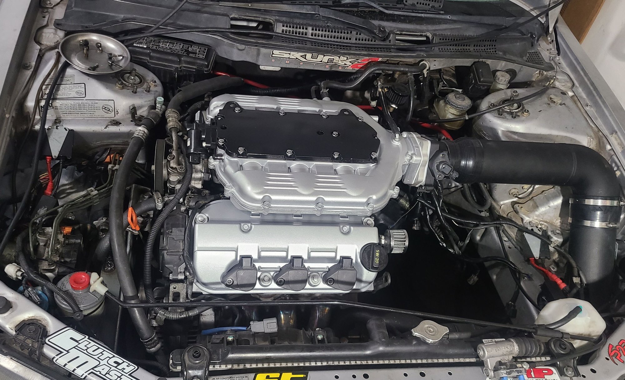

Great job man!
