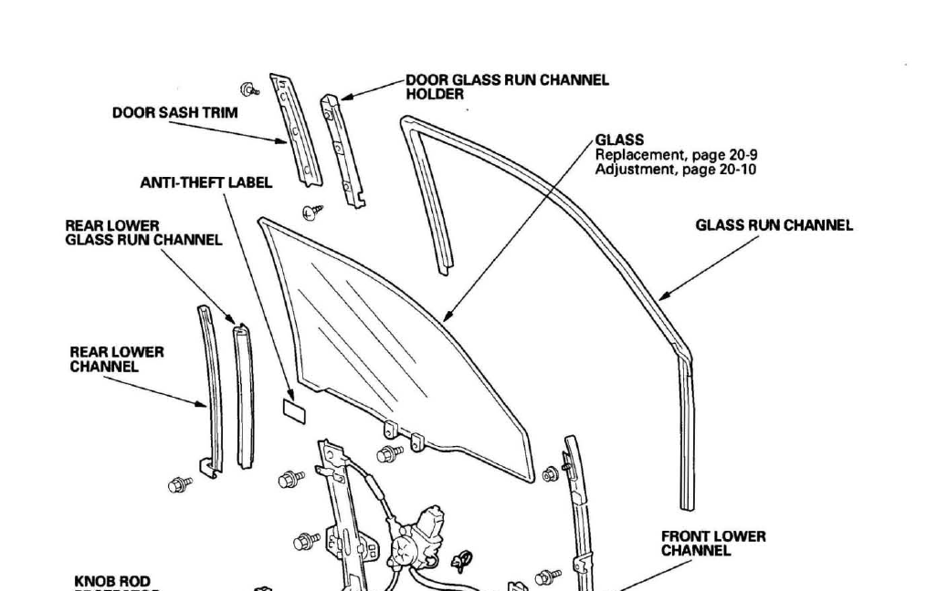

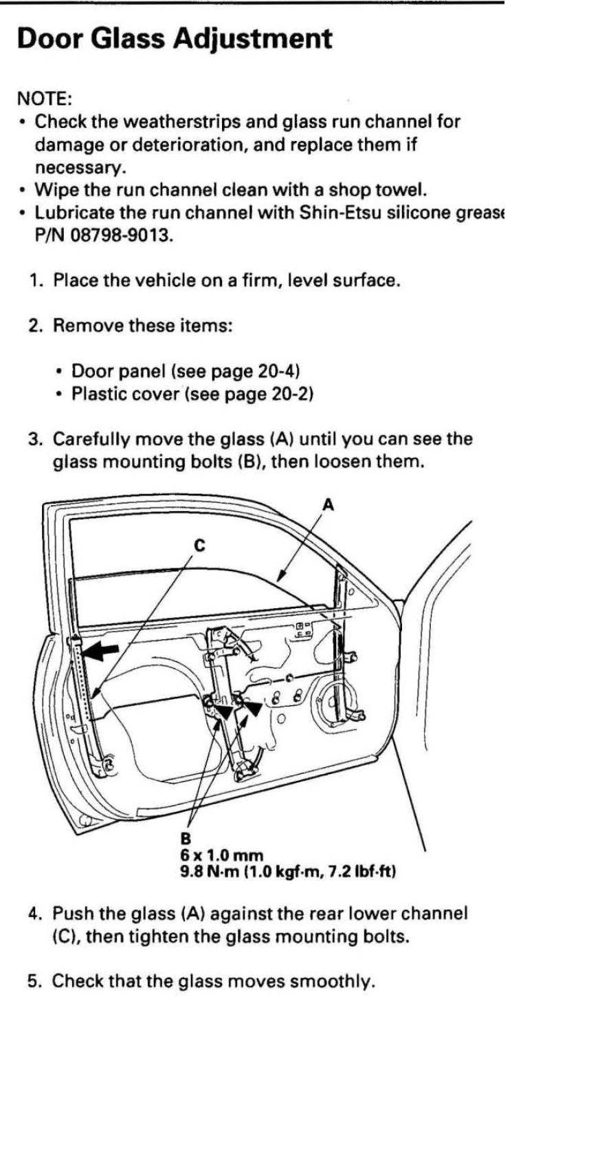

Probably worth another try at opening it all back up and loosening up the bolts for both the run channel mounting hardware and the regulator to window glass. install instructions are below, sounds like the key point is to make sure you get the rear channel bolts tightened first, then push the glass toward that; then tighten the regulator to glass bolts. front channel gets placed/adjusted last.
If you have some time before you do it' might be worthwhile to pick up some shin-etsu grease if you don't already have it. that stuff works great at lubricating these parts and rejuvenating the rubber.
