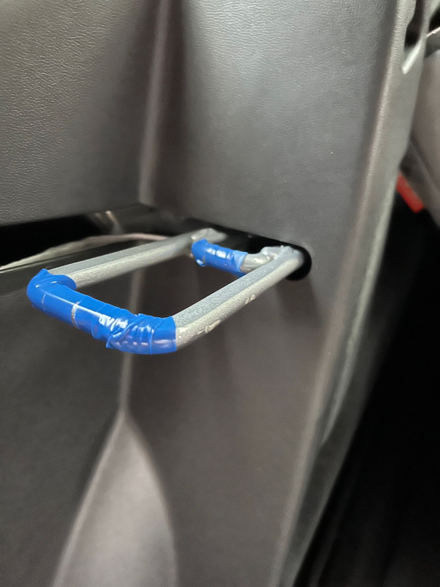

Don't think it is the headliner. Took a service tech for a 15 minute ride and IT WAS DEAD SILENT. Ugh. Rattle was back the next day. But I'm now wondering if the rattle is in the rear seats, possibly in how they are latched in the upright position. I'm going to wrap the metal with electrical tape, as such, and see what happens. I'm also hoping the rattle gets worse so I can take it back in with better luck.
But at this point I think it is the back seats, in some way, causing the noise.

My rattle is slowly getting back to the level it was before the tech guy rode in the car. Looks like it is not a seat belt, a loose headrest nor the metal clasps (see photo above with the electrical tape). But I am still thinking it is the back seats, in some way. If the rattle stays somewhat consistent will try again but have the tech sit in front seat first and hope we can hear the noise, then have him move to back seat.
