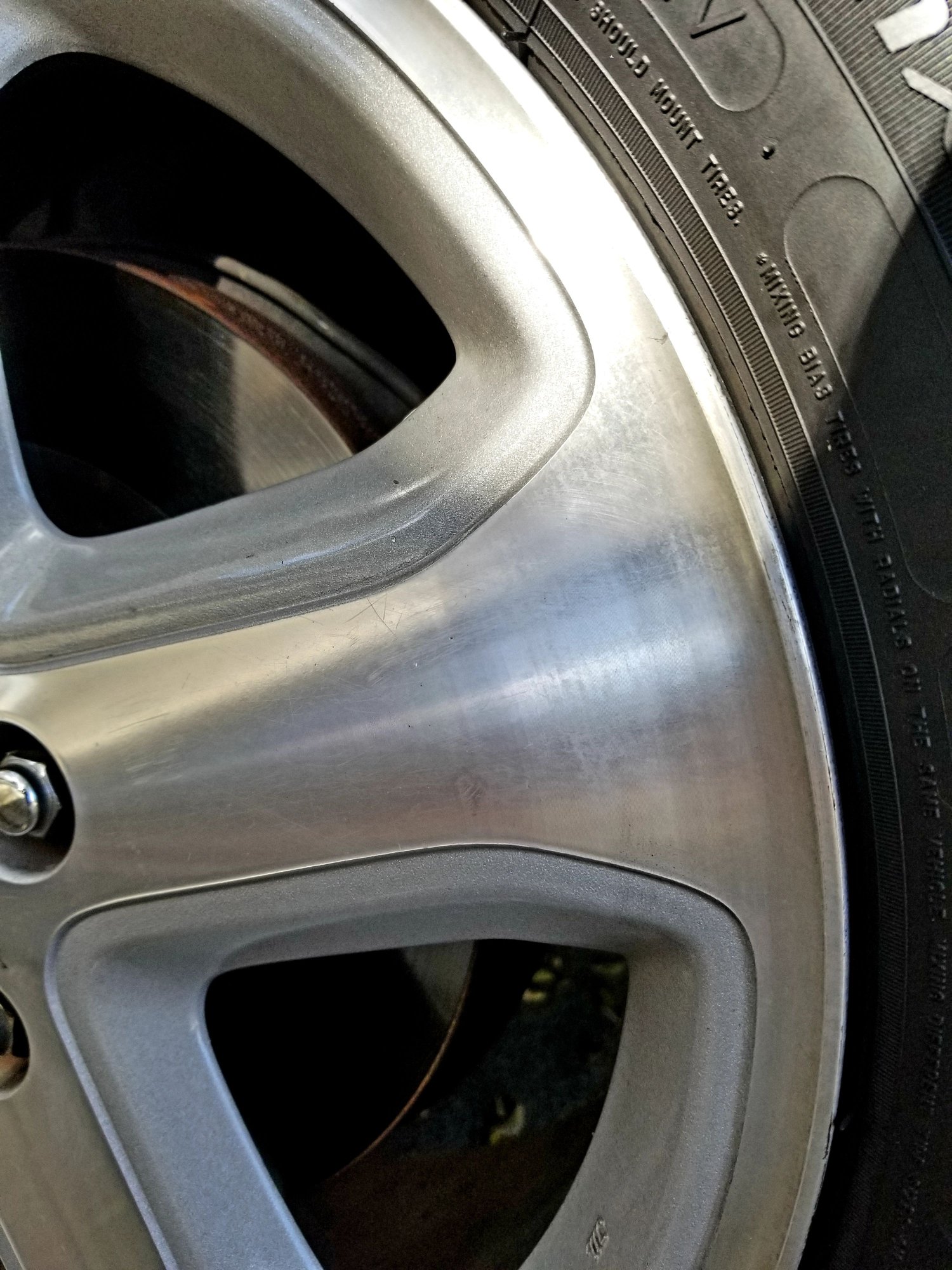

I have some light scratches / swirl marks here and there on my rims and wanted to know if there was any way to remove them.
2003 S type 17's to be exact.
Any type of polisher or wheel cleaner you can recommend?

If you can zoom in you can see like a light haze almost as if the rim is stained.
I know I cant do anything about the deep scratch here but notice all the light scratches behind the deep one.
More light scratches and stained water spots.

The first and second picture really show what I would like to try & clean up.
Its like a light stain haze that is really bugging me here and there on the rims.
"Stained haze", if that makes any sense lol.

I've been lookin at mothers but our rims seem to have a coat over them and I've read mixed reviews on using mothers on coated wheels. Some say not to use on coated wheels so I'm not sure. But it seems our rims have a clear coat over them. Maybe I'm wrong :/

Treat just like paint.
Meguiars light polish with an orbital should fix those up.

M110 compound and M220 polish. These have pretty much replaced M105 and M205 for me. I still keep M100 for the really bad stuff. Shoot me a PM since I detail professionally.

same advice for paint correction.
Start with the mildest polish and slowly work up to more agressive till you're satisfied with the results.
