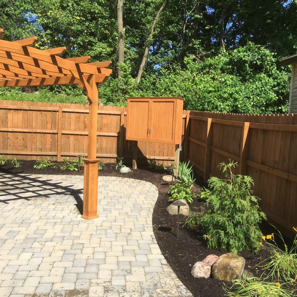

So back on this project again since finally found a great deal on the TV model I wanted to use for it. Picture of the firepit area included again for visualization. I still can't decide between the TV wall and motorized tv lift. I honestly love the idea of the TV lift. It makes the TV the least obvious to the outdoor space when not in use. My biggest hangups on it are one TV lifts are not near as cheap as I originally thought they were. Not out of the question but I swear when I first looked a year or two ago they were cheaper. The second issue is more of a functional one based on the speakers I chose. The speakers extra base woofer is passive and it needs something to radiate off to really be effective. If I go motorized lift I don't anything to mount the speakers on other than maybe the trees. One thought is to build an even bigger like bar area cabinet and have 3 lifts 2 small ones to bring the speakers up and the TV one. This is obviously going the opposite way on a cost basis of what I am looking to do but might be the best looks wise. I would end up with an almost 7ft wide cabinet section to do this though and having the top panel broken up in sections could be hard to seal and prevent leaks.
The wall would basically probably a combination of these three designs into one solution. There would be no cabinet space though in my design. Just a wall with TV enclosure and a small roof overhang of some sort for the speakers to hang under.
Second option still.

I'd go option two. Looks more clean and it works as a table top when not in use.

What do you suggest I do about the speakers though then? I have to find a quality solution for good sound as well. The sound coming from my set on the deck is great when they are mounted as designed so I don't want them to sound worse than that in this instance. I mean I guess I could build a roof over the motorized lift cabinet still without a wall just for the two speakers.
Make the box wider with a compartment on either side for a speaker.

OR, is there a way to attach the speakers on either side of the TV to the VESA mount (with arms or something)? They could rise and lower with the set.

So tested the speakers this weekend hanging around the firepit with nothing behind them just hanging from the steel cable I have strung between the trees.
They sounded a little thin and lacking mids bass to start with. Cranked the bass on the amplifier +3 and it made the sound much better. Going to run them this way for a while and go with the TV lift cabinet for an enclosure. If at a later date I am not happy with the sound I will build a two post pergola over the TV lift cabinet and mount the speakers to it. I might eventually need to do that anyway because the trees that are currently on either side of where the TV will be placed are not in the best shape. The one is already dead but still very solid in the ground and the other one the top has died but the lower 15ft seems alive and well for now.
I think I have narrowed to using this brands TV lift as it is one of the few that you can get a panel to mount on the top of the lift so the entire lid will lift up as part of the lift. I feel this design is better than using a hinged lid as I think it will be better at keeping water out of the cabinet since I will be able to have a lip on the lid all the way around as well put a rubber seal all the way around the top of the cabinet which will then be sandwiched up the lid when closed.
Lift
https://www.touchstonehomeproducts.c...nt=38193705985
Lid mount bracket
https://www.touchstonehomeproducts.c...nt=35396684097
They also have an option for an arm mount for the lift which I would prefer so that the TV could be angled towards the yard as well. If you buy it that way from them they actually have an integrated sensor with it so you can't put the lift up or down with the arm out at all. However, they want $300 more for that setup and I could buy a pivot arm mount from Amazon for $40-50 and just be smart enough not to lower it with the TV moved. Not sure whether having that safety feature is worth another $250.
Still leaning towards building the cabinet out of cedar but have not decided completely against using composite decking either though. I think I would like the cedar more and it might blend better in the woods too. If I eventually do build a pergola it would be in cedar as well and then it would all match.
