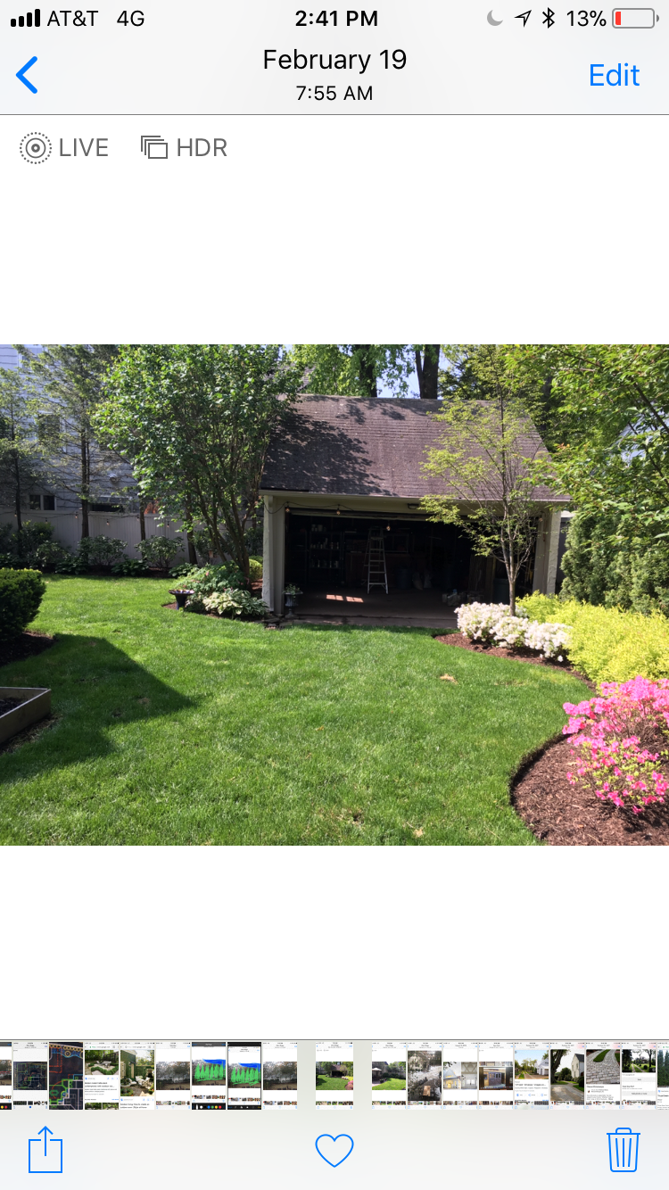

Not sure what to do then. There is no easy access to an exterior power outlet where the car will sit in the driveway, and the electrical in the detached garage is too dated to be trusted for this type of 'absent' use.
i am seeing there are solar trickle chargers, but there is a canopy of trees over the driveway

I would need a 75' foot cord to wrap around the house, and it would need to be water proof (it will be sitting in snow). and then worry about the dog running across it.
man, why does this have to be so hard. what the heck do people do that live in apartments and have their cars sit in a parking structure with no access to power?

looks like you already have stuff plugged in the outlet anyway... why not just use it... it's only 1.1 amp...
