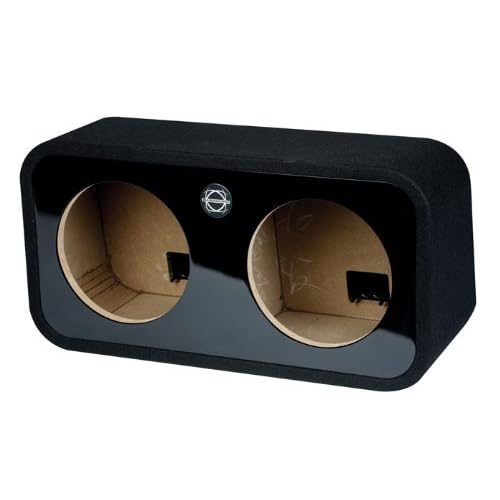

Hey Guys,
I am looking for a sealed enclosure for my dual 10" type R's.
Everything seems to be real cheap. Like 50-70 dollars.....are they shitty or is that just the price.
Also I was looking at the Bassworx sealed enclosure. Looks nice. Does it do the job.....

Really, Type Rs like to be run in ported boxes. In order to tell you if the box will work well, we'll need to know the volume of the enclosure. That's really what will determine the sound of a sealed enclosure.

yo i have two 10'' type R's in my tsx and I have them in a ported bassworx box...the boxes usually go for like 250 and i got a deal on mine...what does it look like is the front like black plastic or is it all carpet
And this is exactly why I build all of my boxes... $250 for a box with random stats is absolutely absurd. And I wasn't that impressed with my buddy's bassworx box either...

yo I have worked in car audio for like 3 years and I have the bassworx ported enclosure and it does a very good job I was gonna build my own custom box but this box matins good solid deep bass and does good with the mid range bass especially with the 10'' that what i have. The 10'' ported or sealed are the perfect size for the 10'' Type R's Ive had mine in it for about a year, what kind of amp do u have and what gauge wire are you using it will all make a big difference...hit me up if u have any other questions....unless your looking to do a sick custom fiberglass box or something the bassworx is fine..
