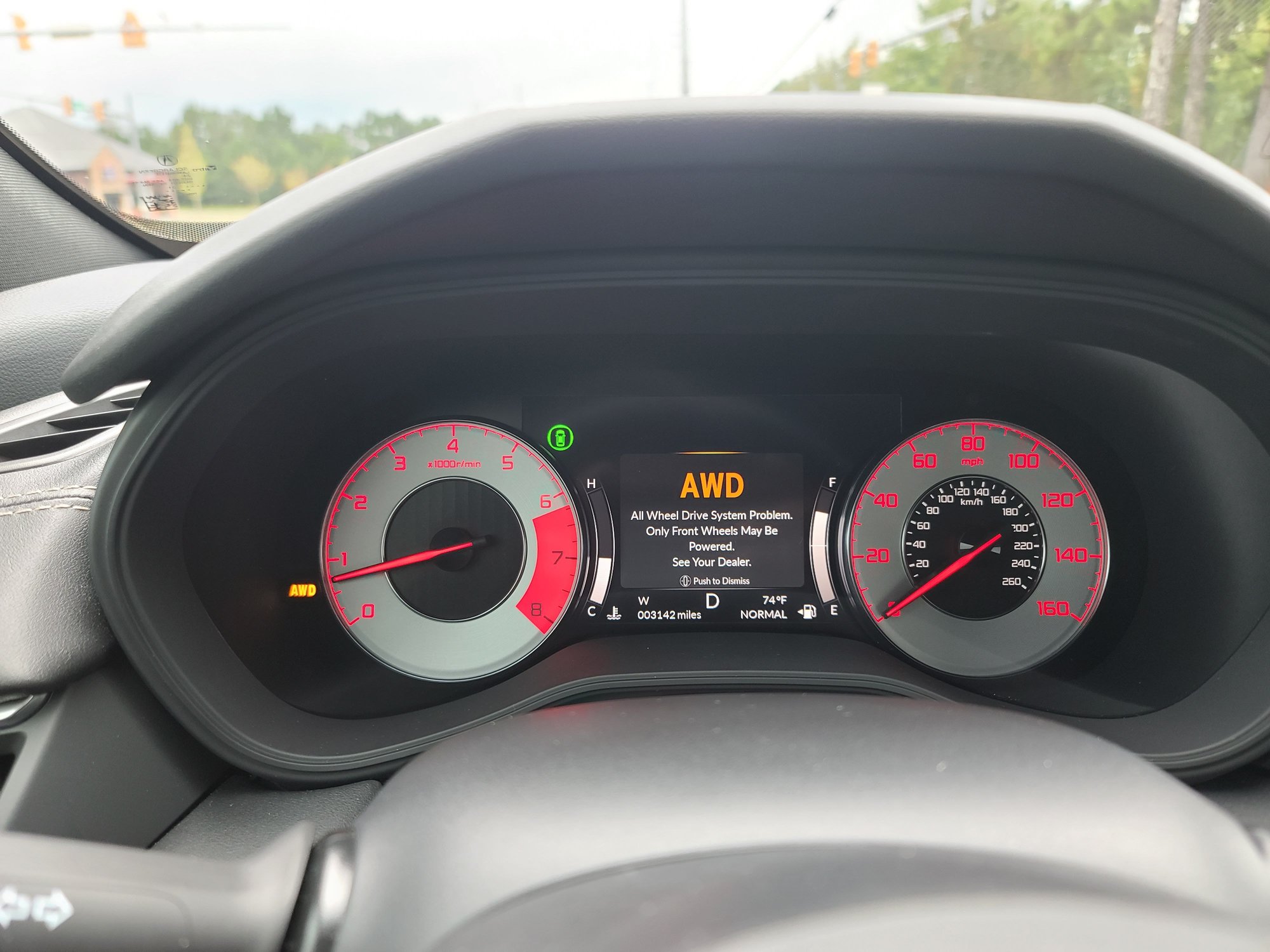

AWD Warning
Hello all, I have gotten this issue a couple times it seems to go away with turning off the vehicle and turning it back on. Has anyone else had this issue and gotten it diagnosed through the dealer? Was it a software update or anything like that to get it taken away permanently?

Can you pull out the error code(s) ?

Is it a specific driving style that causes that? Perhaps lapping around a track? I could be wrong but I thought I read something in the owners manual; may want to start there.
Last time it happened I was going 20mph lol 😂 so no, I don't think speed is a factor.

I guess we found out early that the drivetrain can't even cope with the modest power bump. /hater
Seriously though, I know it's a hassle, but that is absolutely not something I would let slide. It could be something very serious that could require anything from a simple sensor all the way up to a replacement of a drivetrain component. Although rare, there have been two recent transmission replacements in the RDX forum, and I'm sure with how small of a membership there is here, there are plenty more that are failing that we don't know about. I would take it to a dealer ASAP and if the error doesn't prompt while you're there, show them that picture.

I'm finally at the dealer. Let's see what happens.

If its any consolation it is the only (alleged) reported case amongst any Type-S in the US. It's moving up the ladder to Honda given no historical data or know resolution. Could be possible faulty differential.

What was the diagnosis, if any?

They have to replace the right side solenoids in the rear differential
