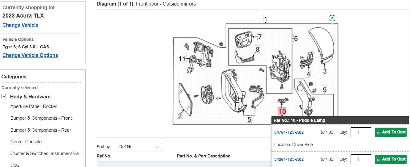

I've looked through this thread and have seen a little of both suggesting moisture ingress or perhaps defective manufacturer construction of the LED element and / or puddle lamp assembly?
As shown on the OEM diagram the #10 puddle lamp face downward at the bottom flat of the outside mirror assembly.
Here's a real world example picture showing how downward fitment is situated within the divot on the flat bottom area of the mirror assembly.
Here's an actual picture of the puddle lamp unit below and it appears they (the manufacturer) place some kind of (red arrow) weatherproof rubberized foam gasket material around the periphery to keep moisture from leeching in after final press assembly of the outside mirror.
The purple arrow indicates the round LED element to provide the light.
Could moisture be getting into the lamp assembly at either of these locations?
Here's another closure picture that kind of shows how the foam periphery gasket (red arrow) is 'mashed' in the circular orifice to make its seal against moisture.
Purple arrow shows a little closer visual on the LED element placement like the previous picture.
I can see how perhaps some moisture could accumulate / pool? in this area during rainy / snowy weather?

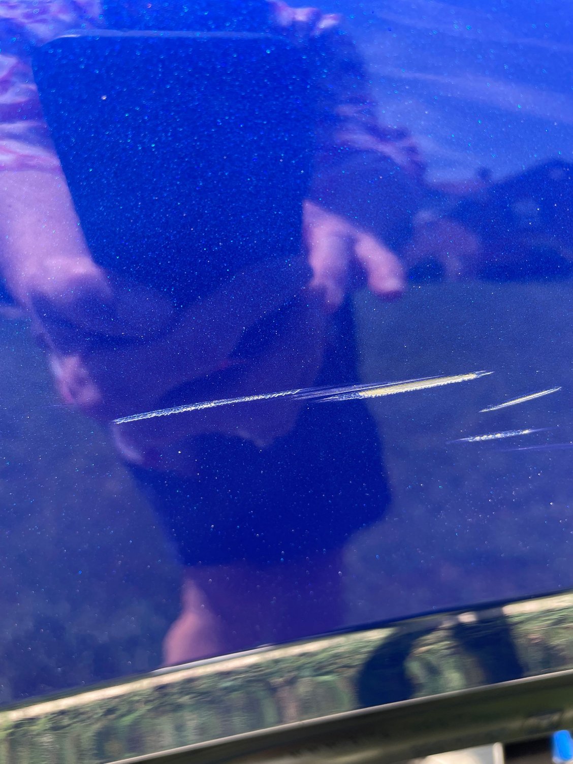

Perfect Repair
Sorry for the hijack. A small dent beneath the rear quarter panel scratch increased the repair cost: $475 for materials and $1,475 for labor. Results look perfect even in the bright sun.
