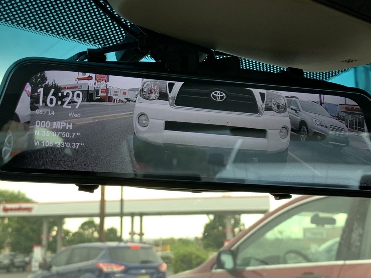

Slap on one of these
https://acurazine.com/forums/3g-tl-a...ics%7D-981706/
(Just buy a current model)
