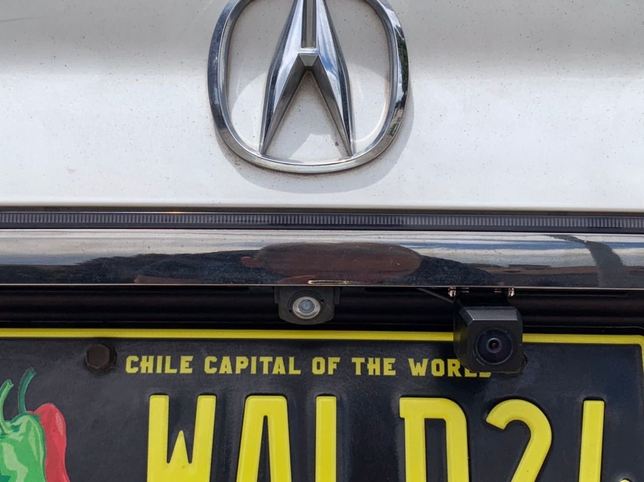

First, I took the trunk liner off in order to get to the license plate & reverse light housing. I then unbolted the housing which is secured to the trunk lid with four 10mm bolts. Removing the housing I was able to get easy access to the factory wiring and the existing reverse camera mounting location.
You will need to mount the camera next to the factory camera.
I then pushed the new wiring through the OEM grommet behind the license plate followed by zip tying the new camera wiring to the existing wiring. You will need to tap the red wire on the kit (reverse trigger) to turn on the reverse marker lines on the screen when you back up. The wiring the went through the plastic passenger trunk lid arm and back down into the trunk. Once in the trunk, I fed the wire through into the passenger compartment following an existing wire entry point.

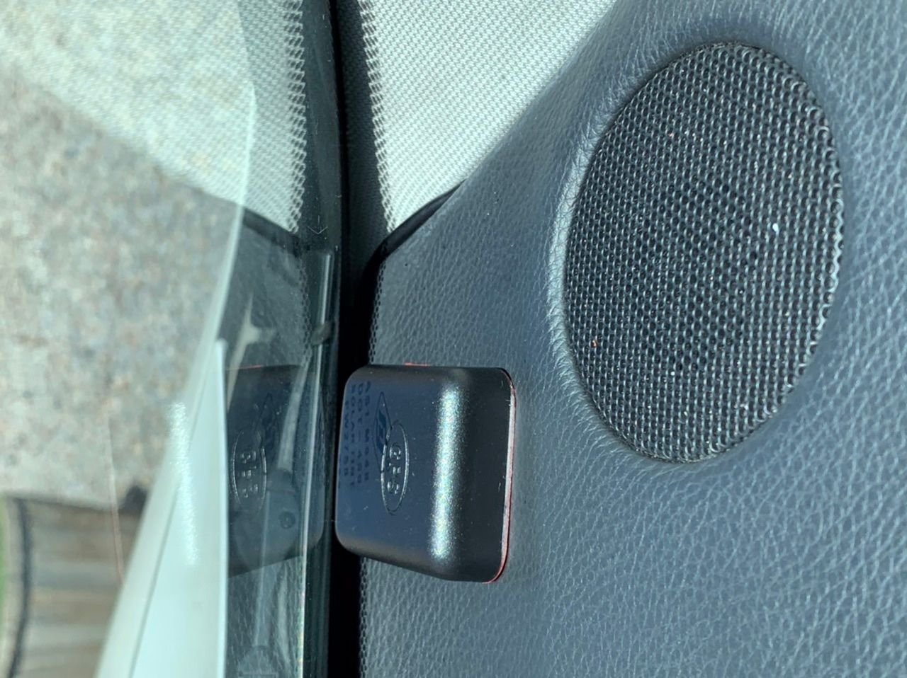

This mirror comes with a small black GPS module which shows your latitude/longitude plus time & vehicle speed. I ran the GPS wire and placed the box near the passenger dash speaker.

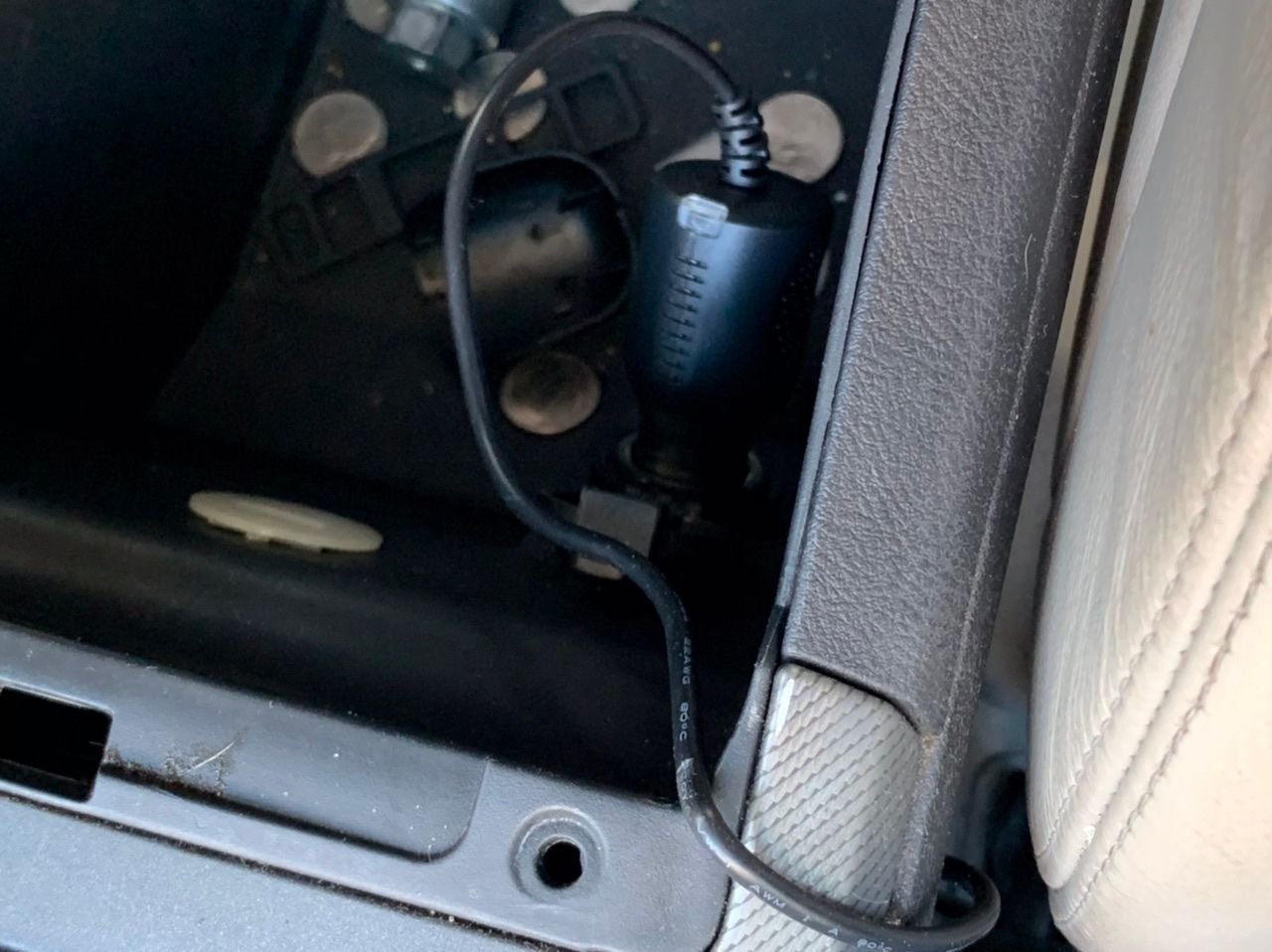

This mirror doesn't give the option to hard wire from the factory. You get a cigarette adaptor or a short USB adapter.
I ran the cigarette adapter to the outlet inside the center console and ran the wiring up under the driver floor mat then up the driver A-pillar to the hoodliner.

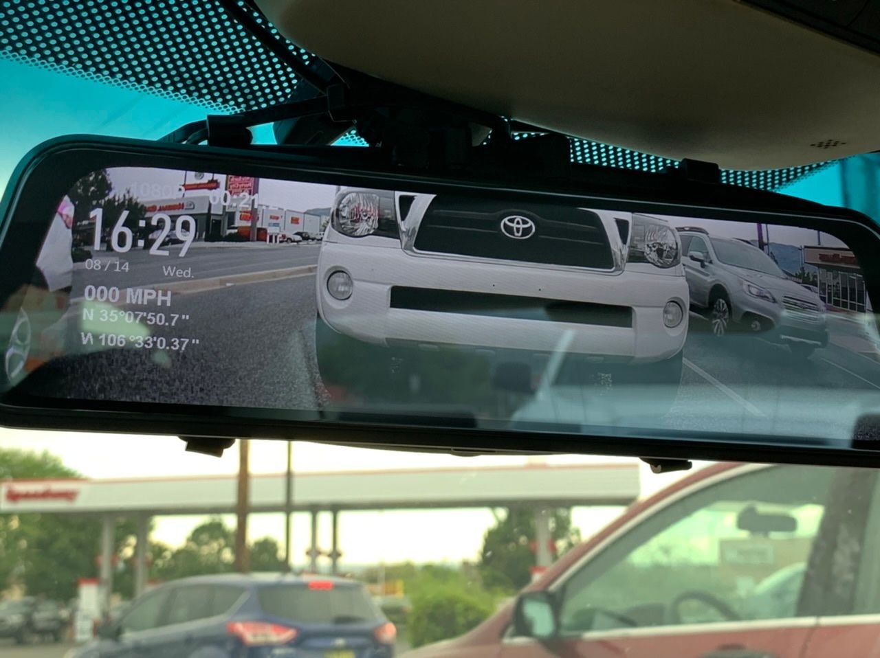

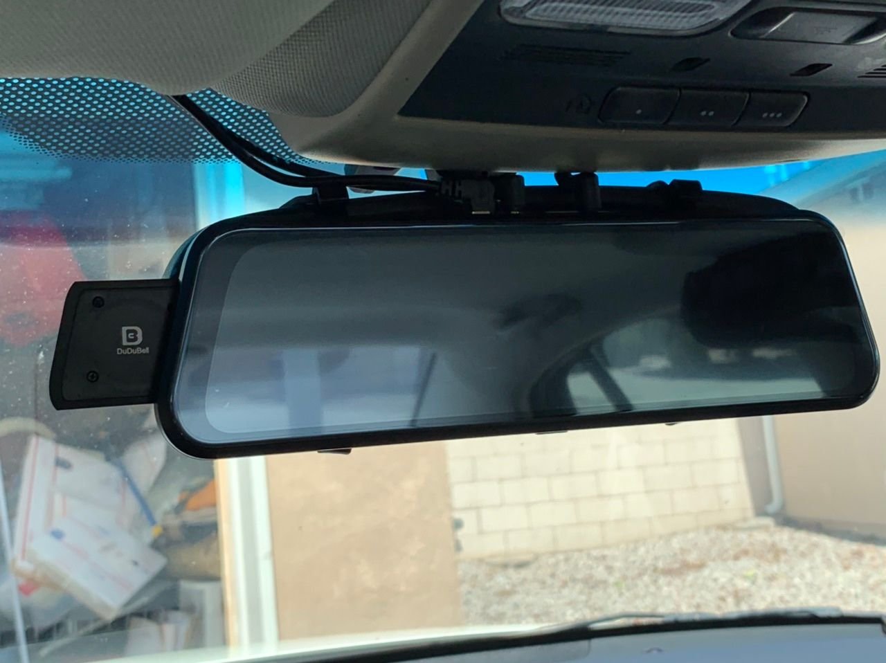

Here are some pics of the camera mounted and in action. Please note that it's the middle of the day with the sun right overhead so the screen images are washed out in the pics.
The front facing camera is on the left with the sweet brand logo ��. (screen protection film hadn't been removed at this point)
Rear camera image
Reverse camera image is lower while backing up along with the imposed lines.
Front camera image
Not pictured is a 3rd camera image that shows the front camera along with a smaller rear image at the same time.
