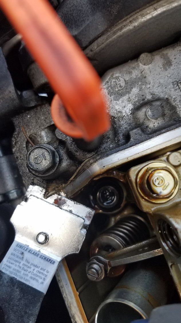

This is what it looks like..

As part of the piston ring repair situation they would have replaced almost every gasket under the hood. Perhaps they didn't torque the bolts correctly or did a really terrible job of cleaning up after themselves?
Old Dec 23, 2019 | 09:57 AM
in any event; one needs to take apart the valve cover to investigate why it's leaking. so, it's coming off no matter what. if the rear isnt leaking, then you obviously dont have to investigate

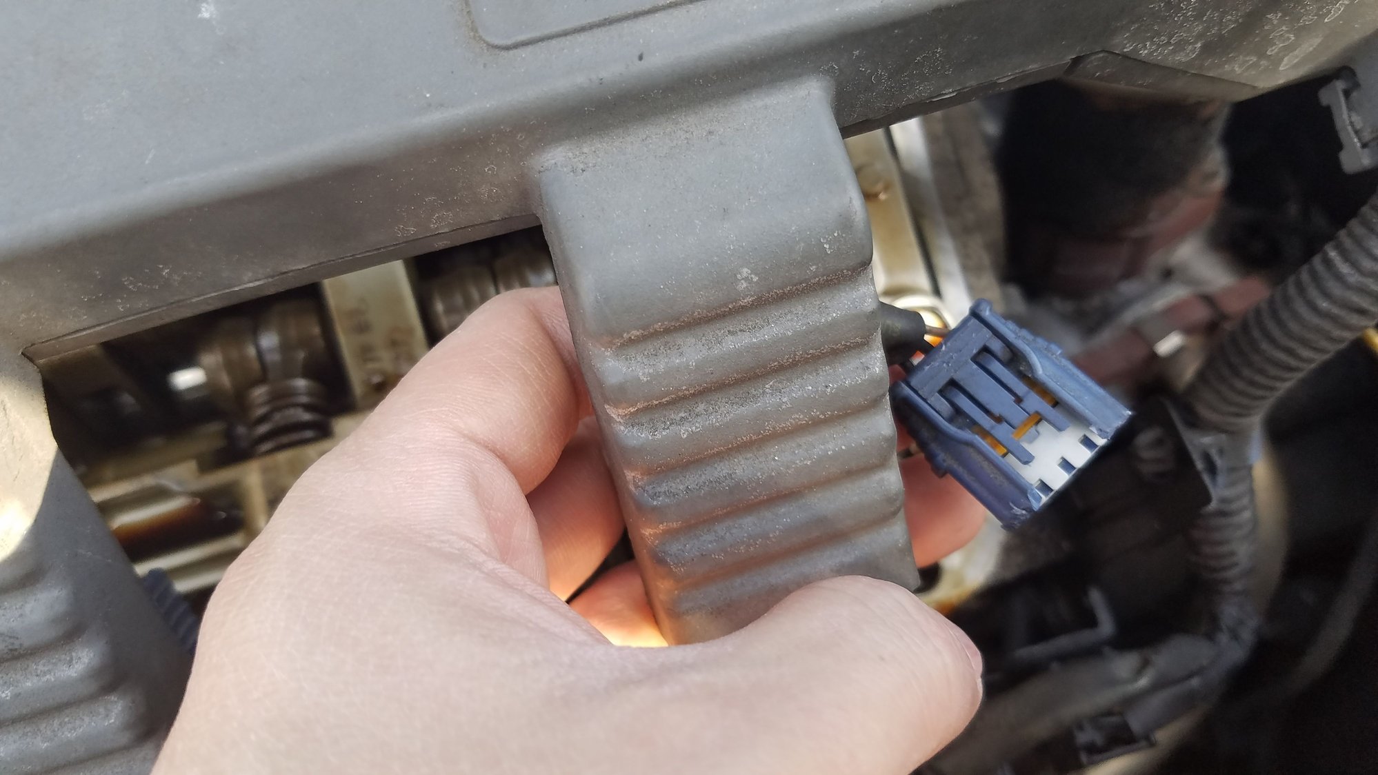

I found it. It was 16ft-lbs for the 12mm bolts and 9ft-lbs for 10mm.
The replacement is straight forward for me.
The only that i broke was the plastic connector to the coil. The tab was brittle so I snapped it.
Besides, scrap the old gasket sealant off was tough. I didn't any of them to fall into the housing so i push them away from it.
