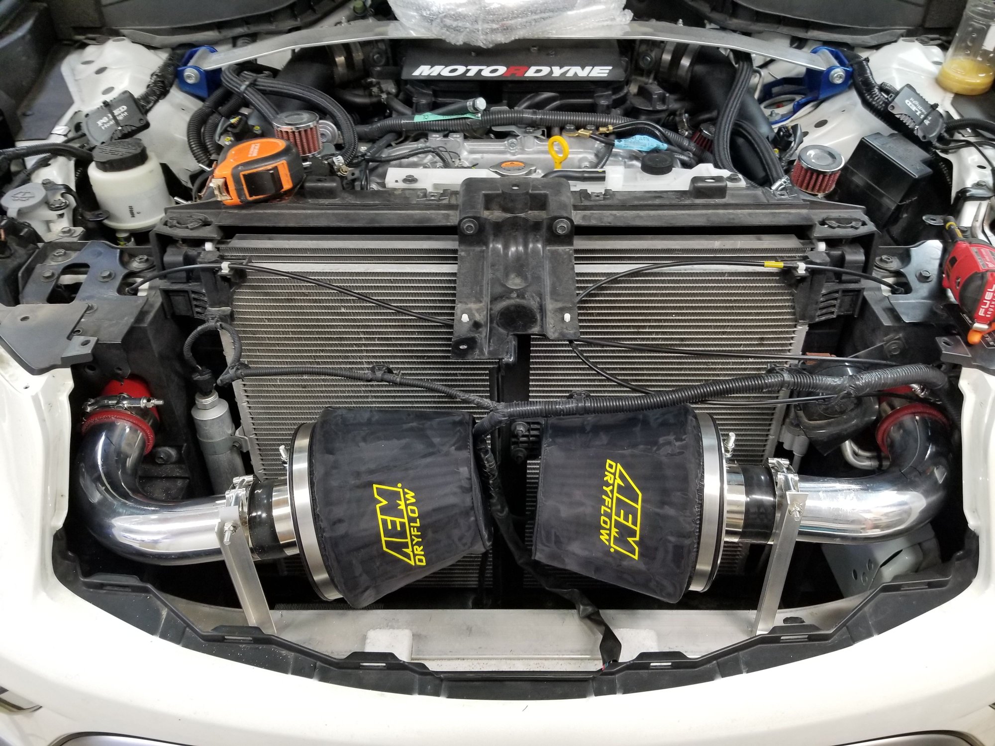

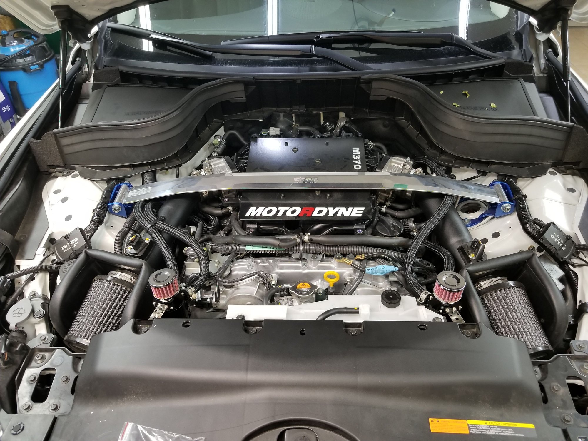

I am sorry, but you are wrong here, when car is moving air turbulences under hood will make sri suck hot air. Going low speeds up to 30mph, and higher speeds 50+mph was the worst intake temperature increase at MAF sensor. We took data couple times.
Here is an example for you:
My old sri setup on Infiniti vs longtube design both 2.5 at MAF (it made extra 18whp, and lots of torque at midrange):
I have to agree, intake tubing should be straight as possible before TB. And yes, it can be short, but it must have big velocity stack. and it must have access to fresh air (like factory setup). But like I said before, heat will kill any benefits of short arm (and this rule applies to any NA engine).

cold air and big velocity stacks, fans blowing in front.... Keep in mind it is two tubes going in intake manifold not one and restriction free exhaust....
I was just giving some insight on intake that i was working on. And you said that temperatures under hood will go down when the car in motion, that was not the case according MAF readings....
And SRI was harder to tune because intake temperatures were jumping all over the place.... All good Thank you for your suggestions.

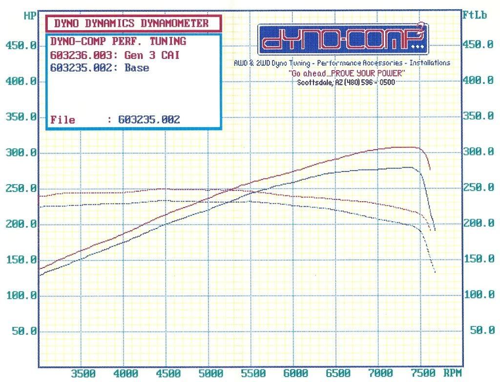

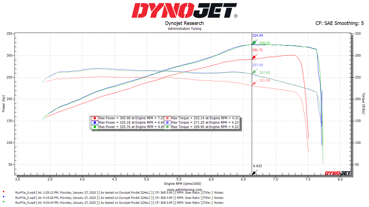

You'll have to believe me, torque wise it was really noticeable. Even on MDX, after jpipe and cats installation torque was more noticible....
I will post 2 dyno charts (not my), both of them on same tune, first stock intake vs 2.5" longtube, 2nd one stock intake vs 3" longtube with MAF scaling:
I really dont think similar gains could be achieved on J37 with intake only... Was talking to Rich from RV6 few years ago about intake, but he was not interested of making one. There is Dyno of my MDX on his website if you interested (tuned vs untunned)..

Agree with you, when you have the complete front-intake-jpipe/header-rear-exhaust setup.
But my point is on "cold air intake" being the only mod, with the remaining car stays OEM stock. The gain is minimal at the low end, and maximum gain is near the redline.
