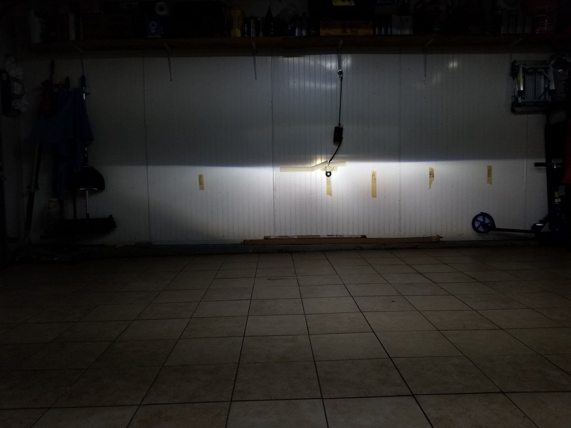

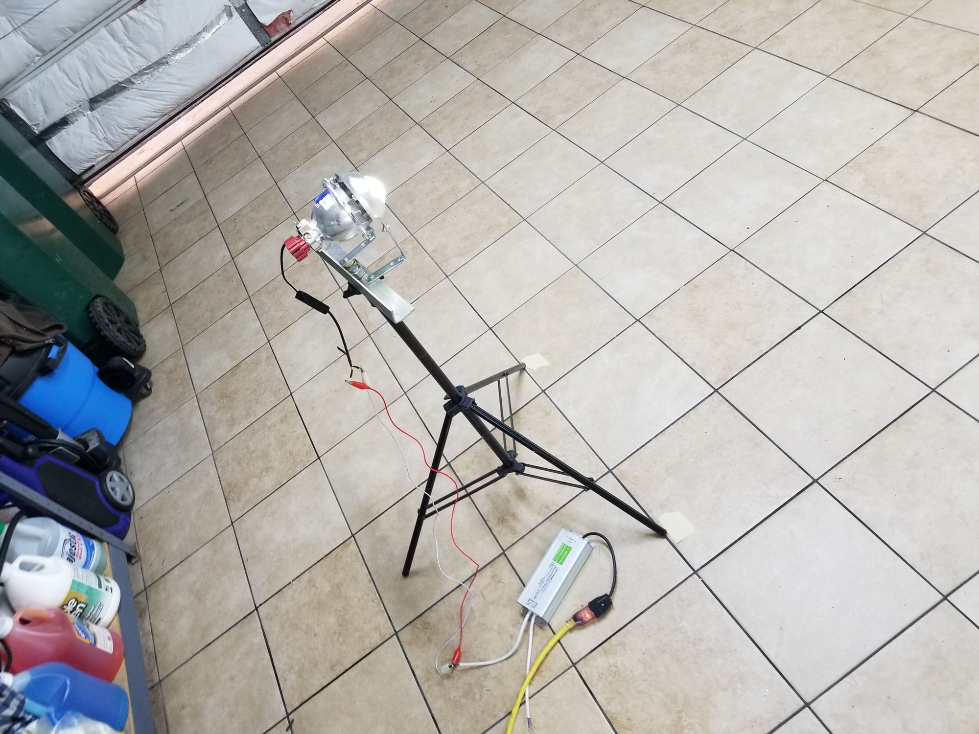

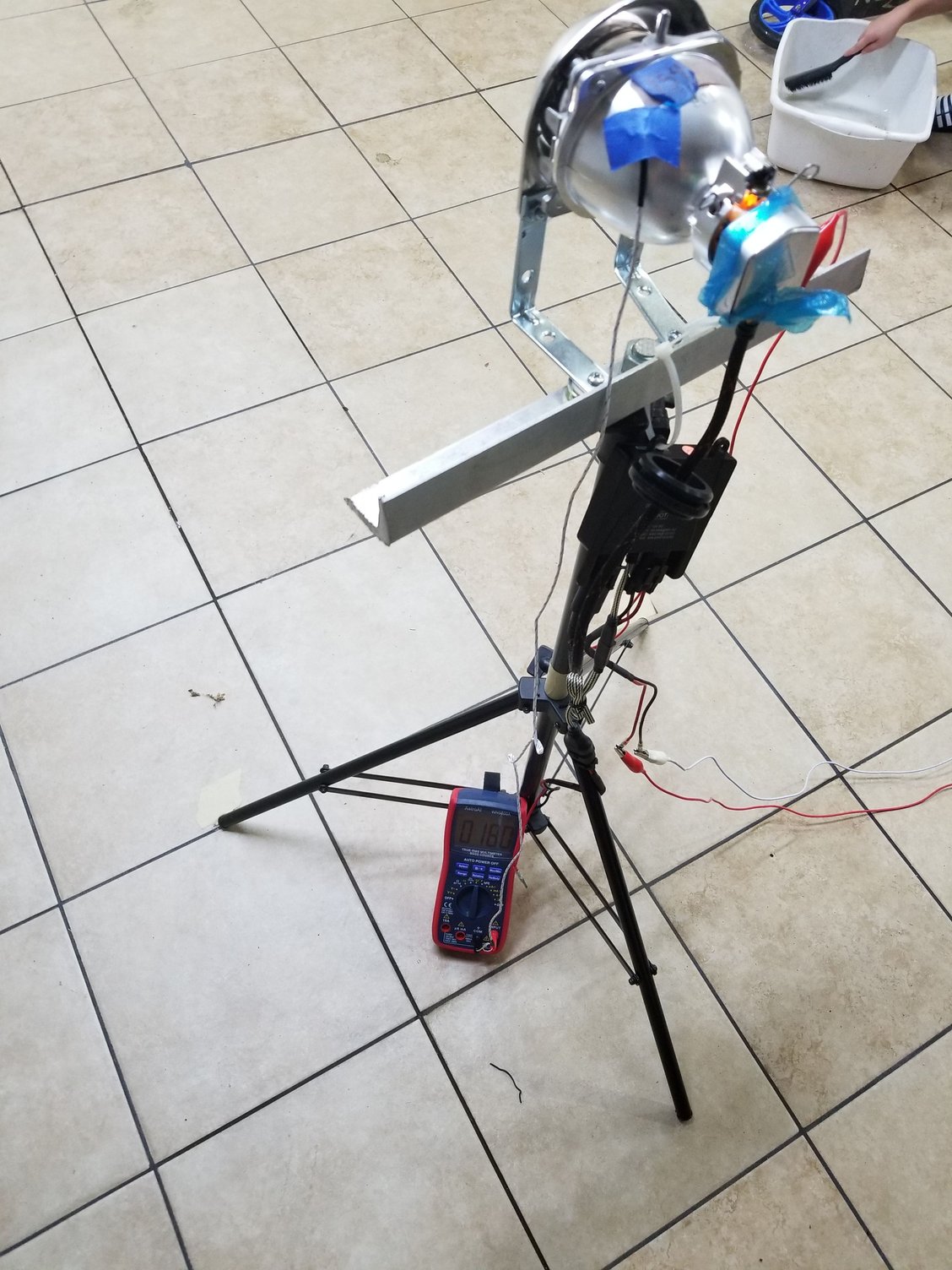

Measuring lux at various spots of beam pattern. Believe in me, I spend probably thousands in $ testing ant making all kind a led lights for my and friends cars

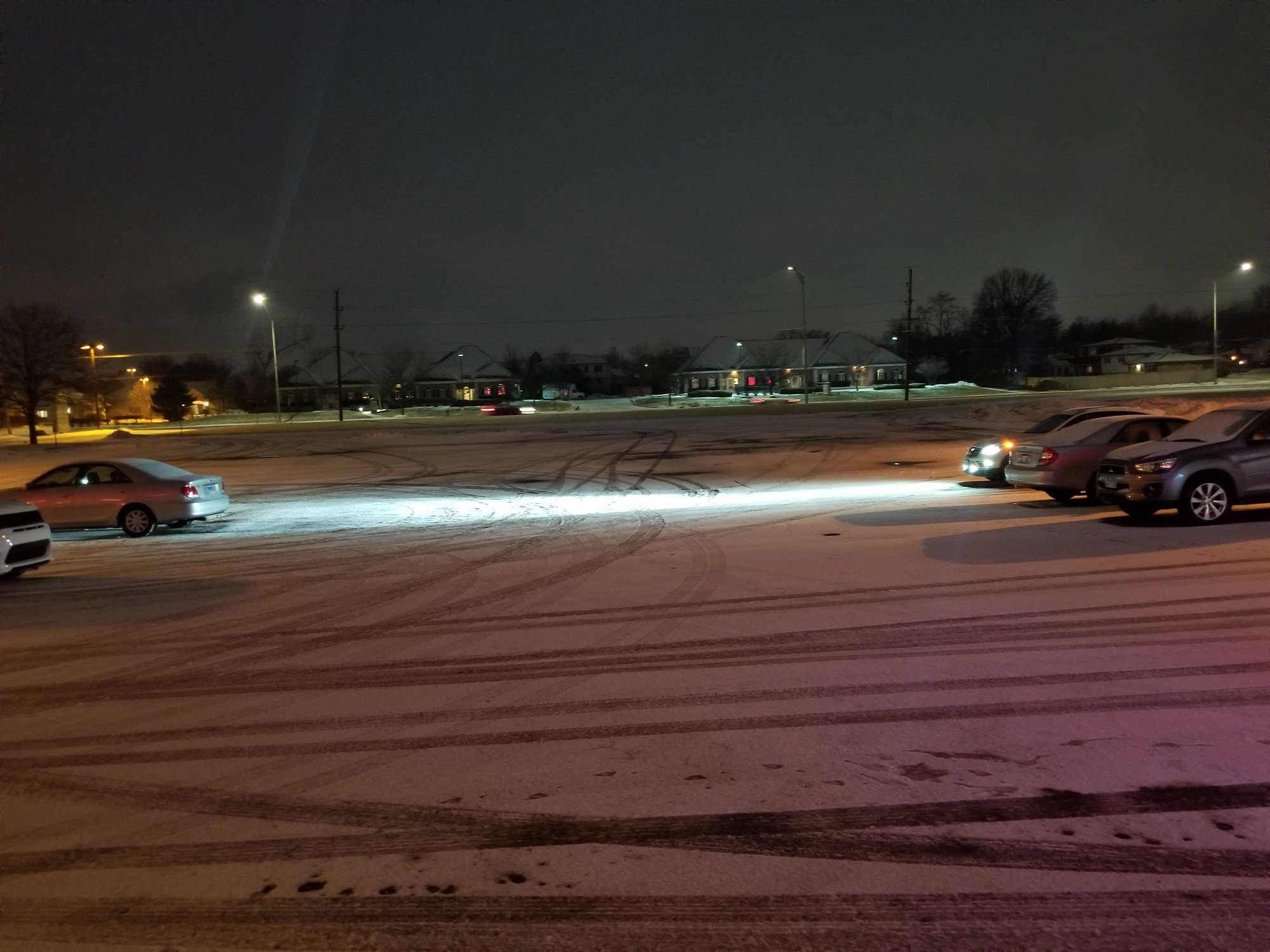

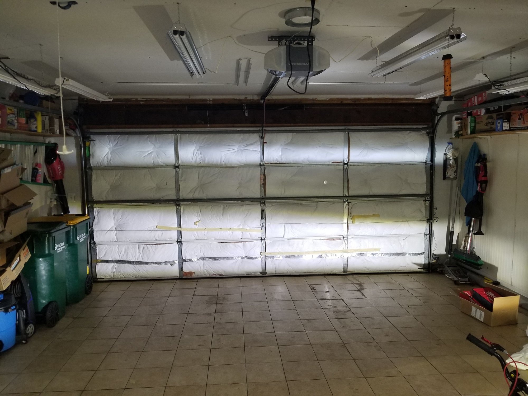

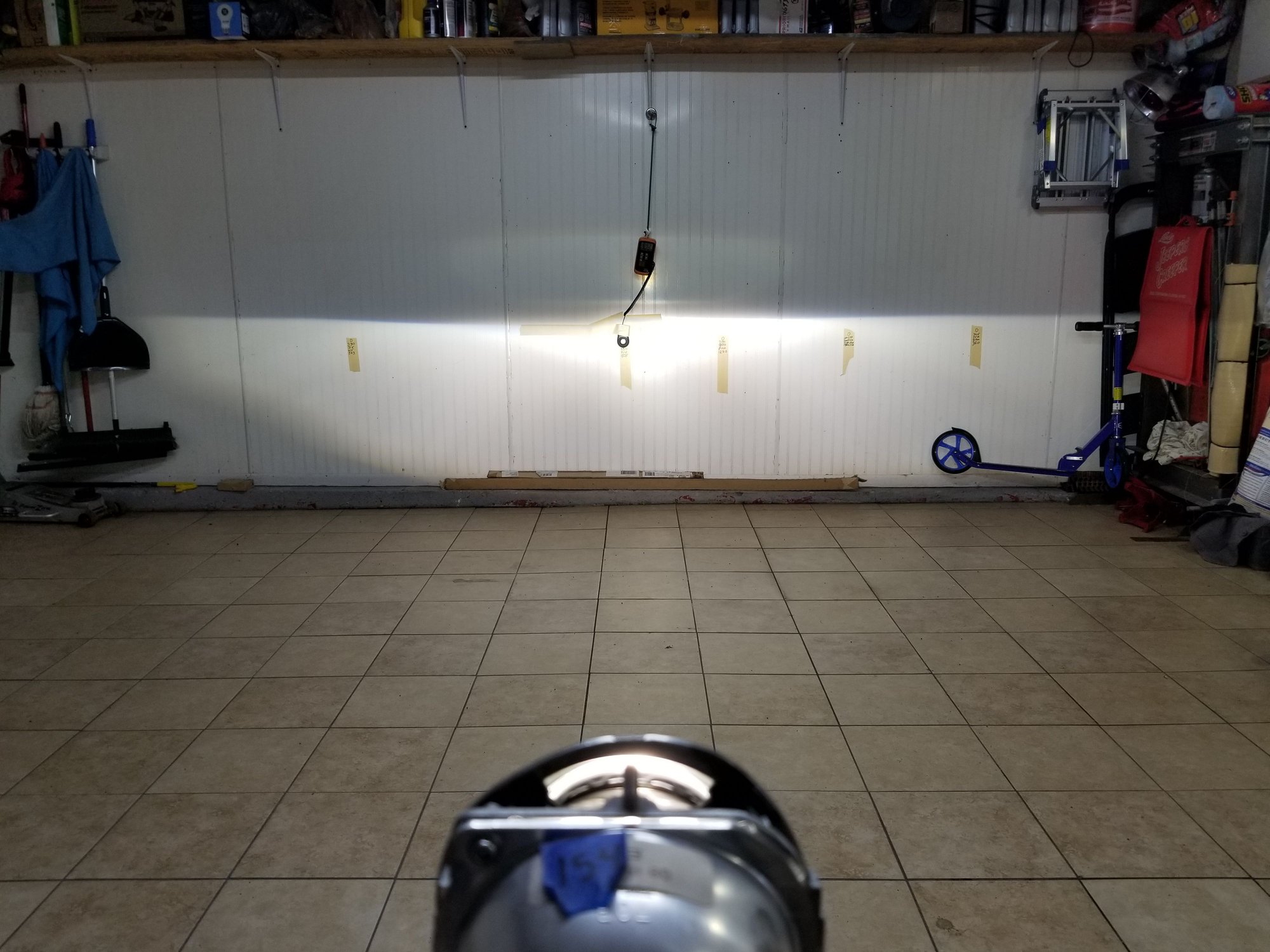

Here are some pictures of garage engineering:

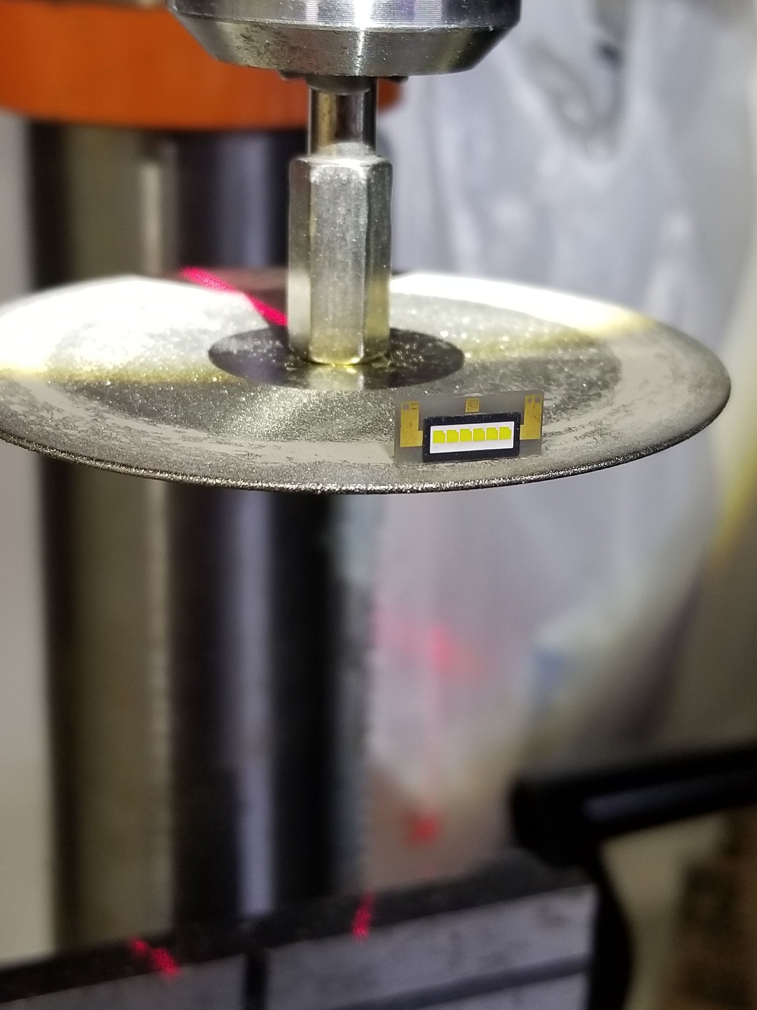

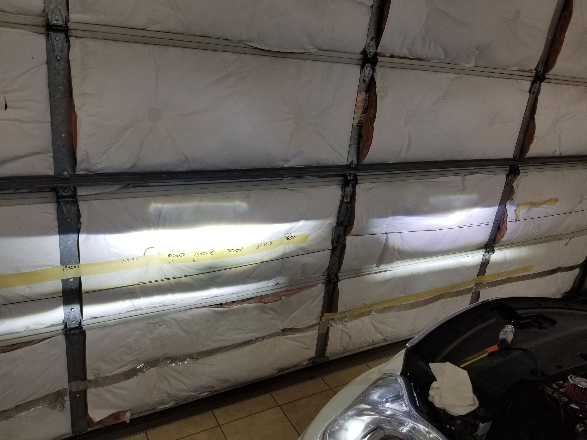

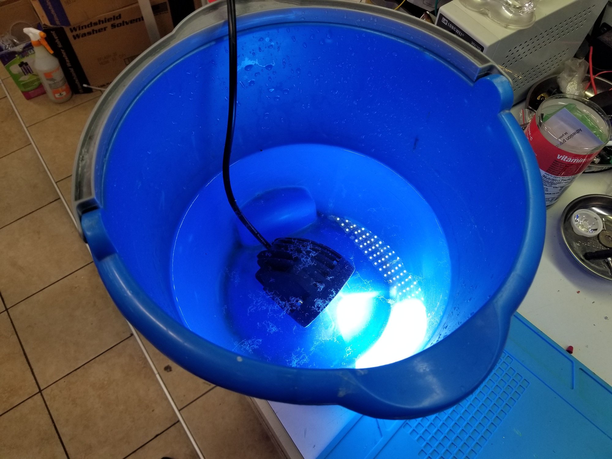

and some more:

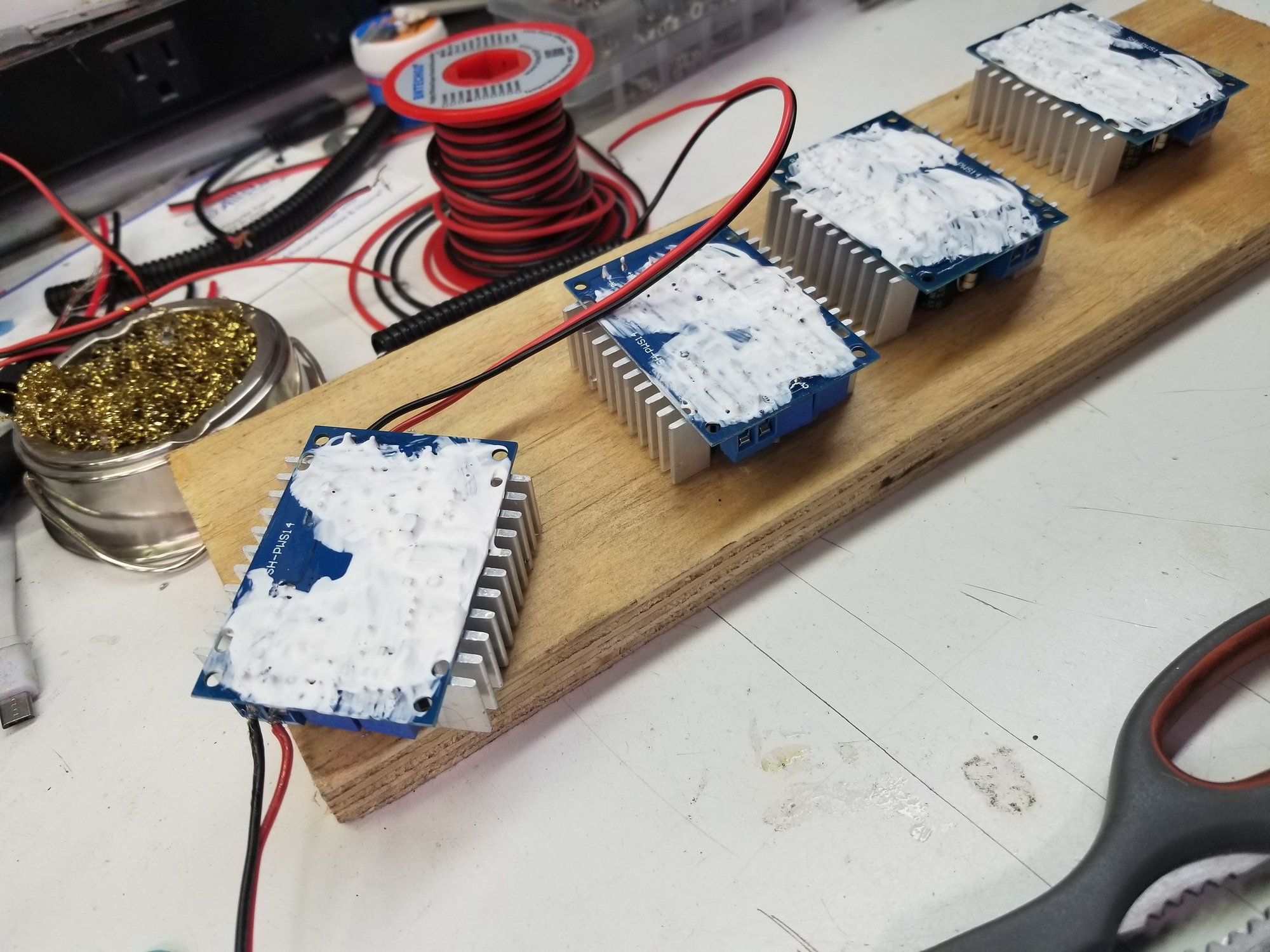

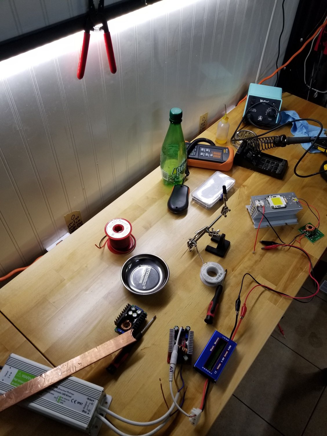

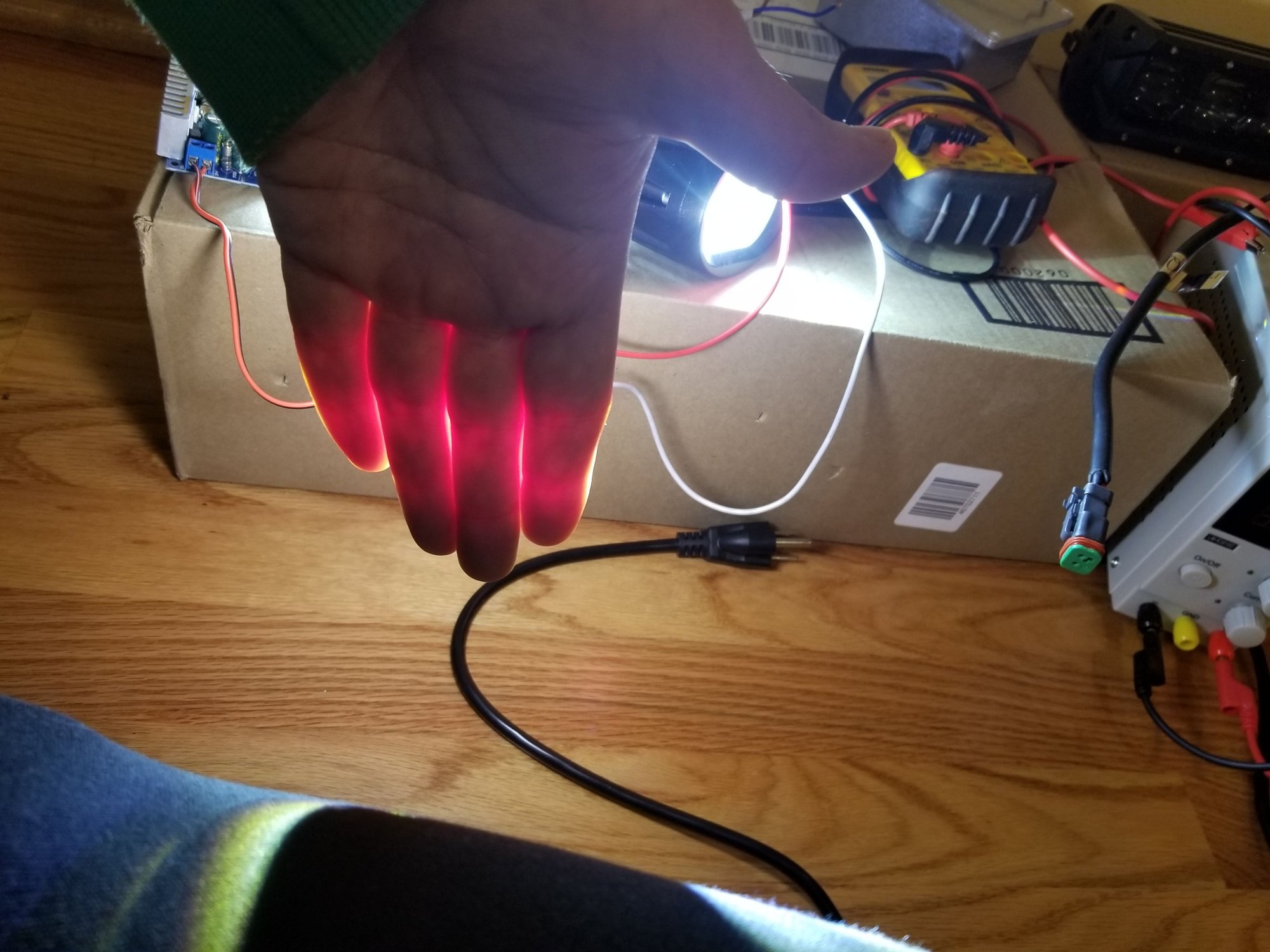

and more:

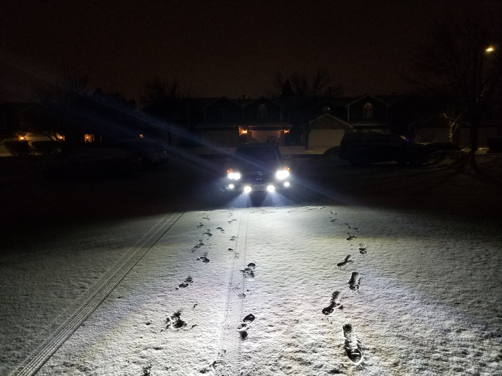

Jeeez. U are serious about this! Impressive!
Side note—where are you that there is snow on the ground already!!😬

If we're talking proper retrofitting to get a true LED/Bi-LED projector, then yes, I'll say the technology is getting better and better and will soon far surpass HID.
Looks like a lot of your latter LED pictures are for the auxilary/fog lights. OP is asking about plugging and playing LED D2S bulbs into their stock housing. Have you found a good quality D2S LED bulb that minics the optics of its HID counterpart properly?

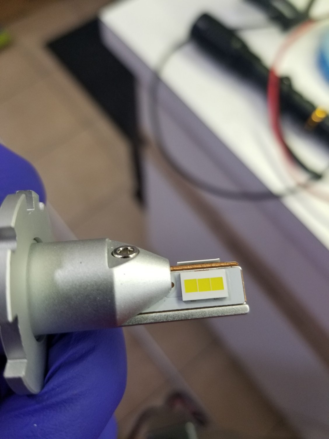

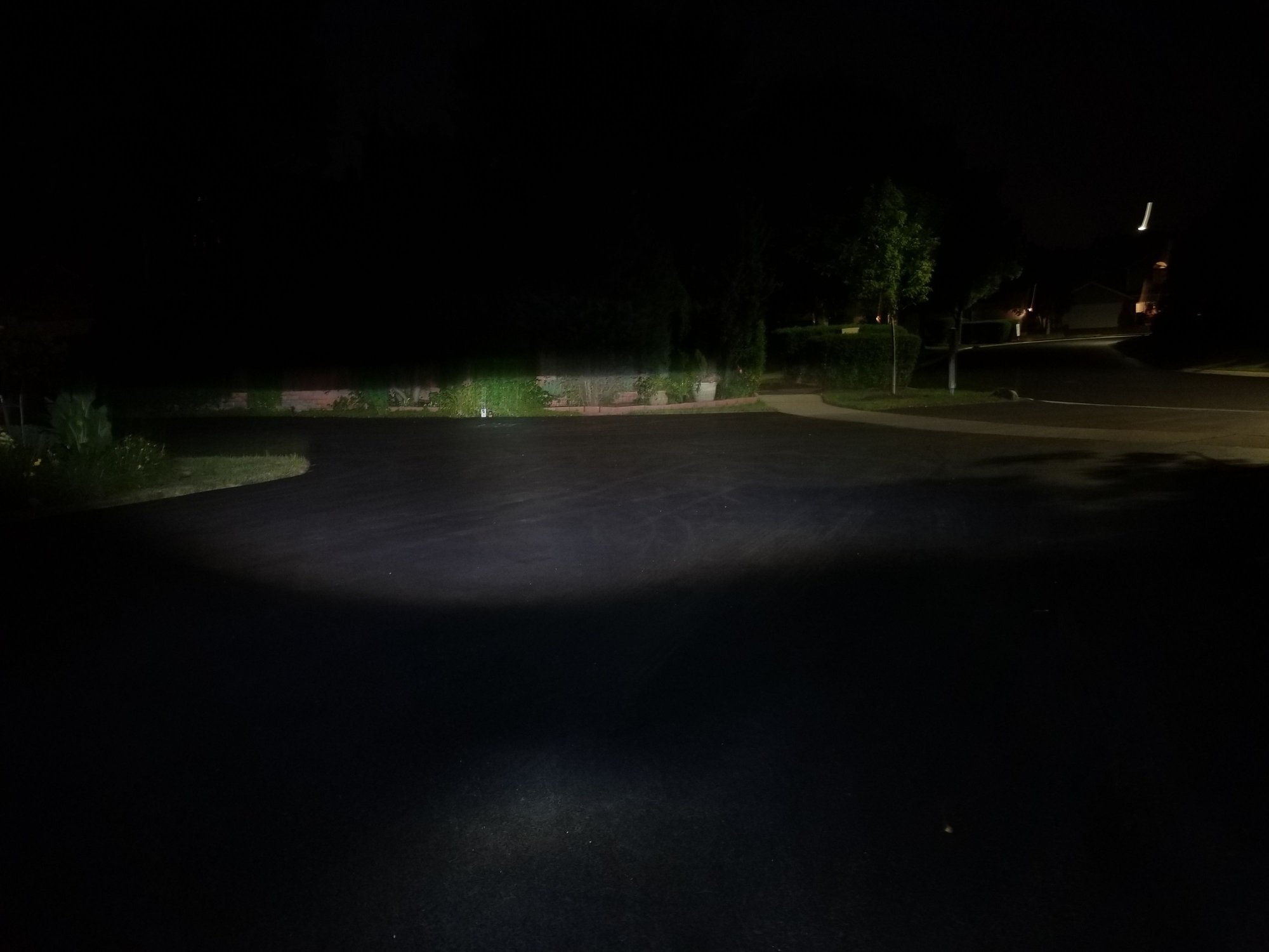

Best bulb I tested so far in projector is this type of bulb:
https://www.ebay.com/itm/D1S-D2S-D3S...cAAOSwfo9a8Wet
There are other "manufactures" of this same bulb (Novsight, P9, DDm Tuning etc), but in general they are made in same factory in China. This bulb have big hot spot, high light intensity on the sides, but little shadow in front of the car.

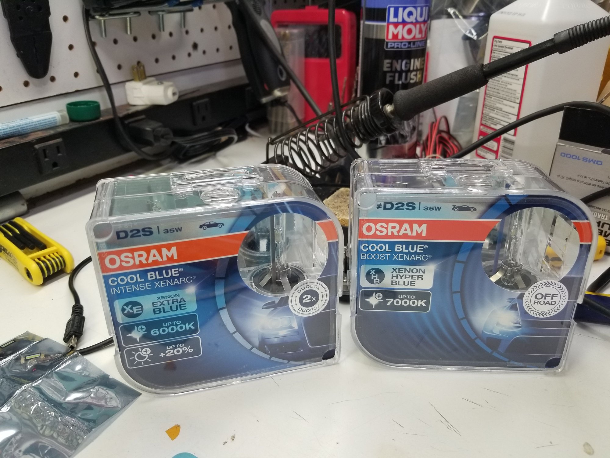

In this picture you can compare 35W Osram CBI VS this kind LED bulb:
And I would change my HID's as soon they starting to change their light color...(going pink)
