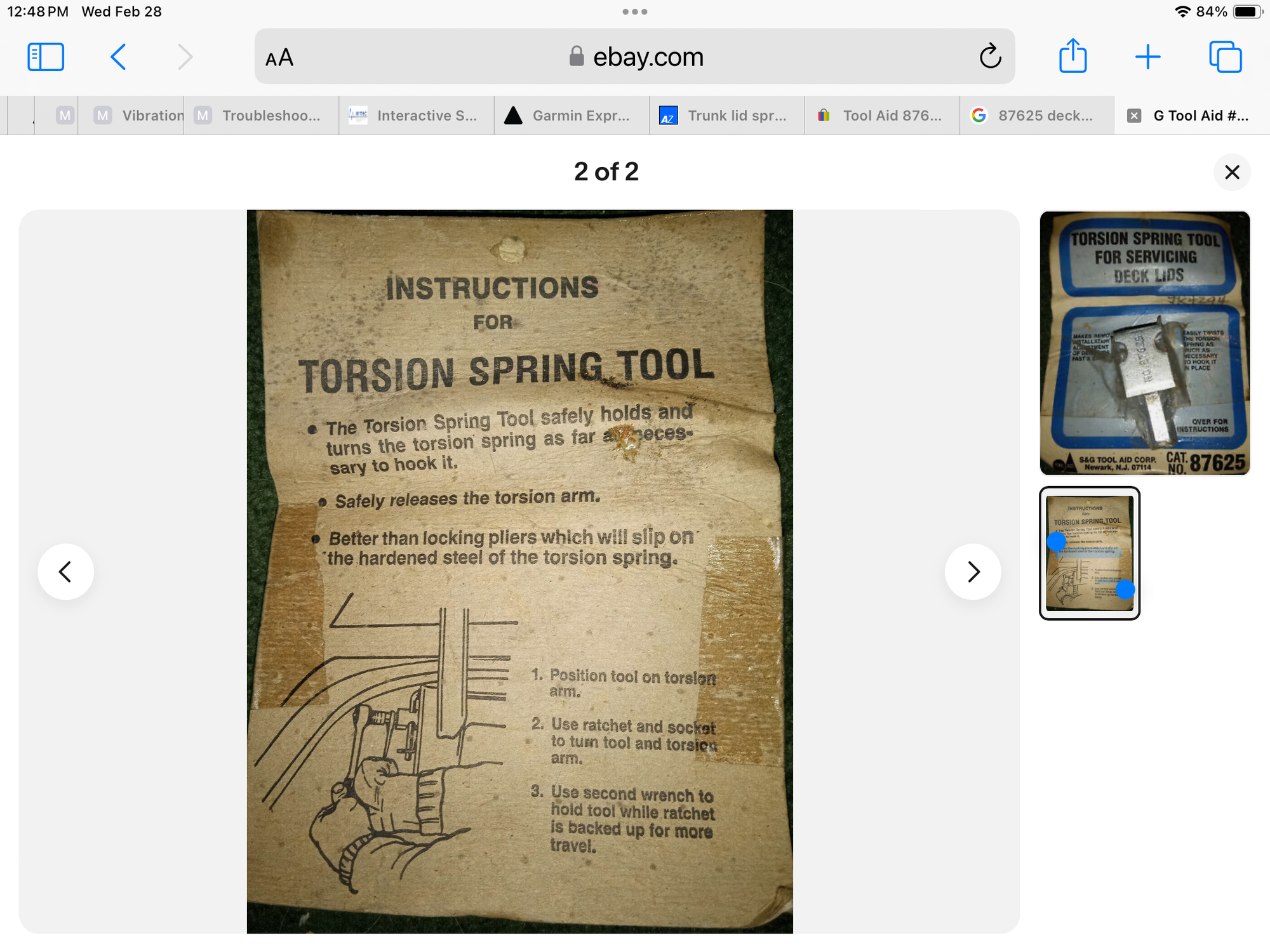

I wonder if Torsion spring tool would work?
I can't wrap my head around that tool. Is there a hole in the top the bar goes through I wonder. I just want it now cause it's bothering me I can't visualize how it works.

Another eBay listing shows the back side of the blister card.

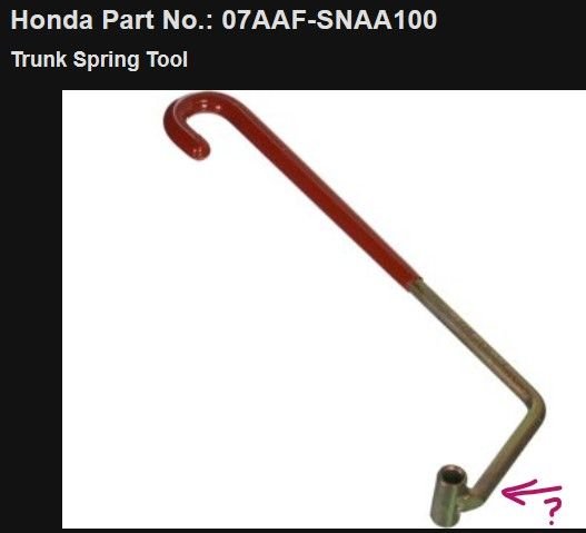

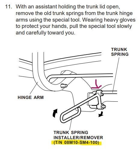

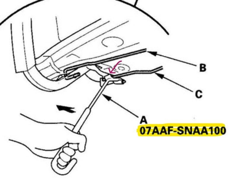

What complicates things further is, if you look at the illustration on page 20-140 in the 07-08 TL FSM the listed 07aaf-snaa100 tool being used looks like the below.
There appears to be a 'lip' attached to grab & steady the torsion spring as the round hollow portion holds the spring within.
Logically, then the installer could / would have more control to manipulate the spring & 'muscle' it into position without fearing it would separate from the tool under tension, that would suck.

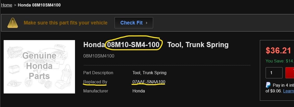

Now if you look at the (older?) 08m10-sm4-100 tool listed on the attached PDF & looks like the below, clearly the tool design is similar (magenta) because the 'lip' is present ; however, there is now another part number to the tool image, lol.
The real 07aaf-snaa100 tool without the lip below.
If you 'google' ( ) 08m10-sm4-100 HPN claims it's 'in stock'?
08M10-SM4-100 - Genuine Honda Tool, Trunk Spring (hondapartsnow.com)
