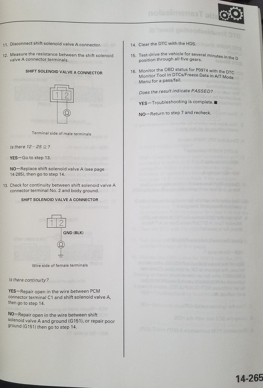

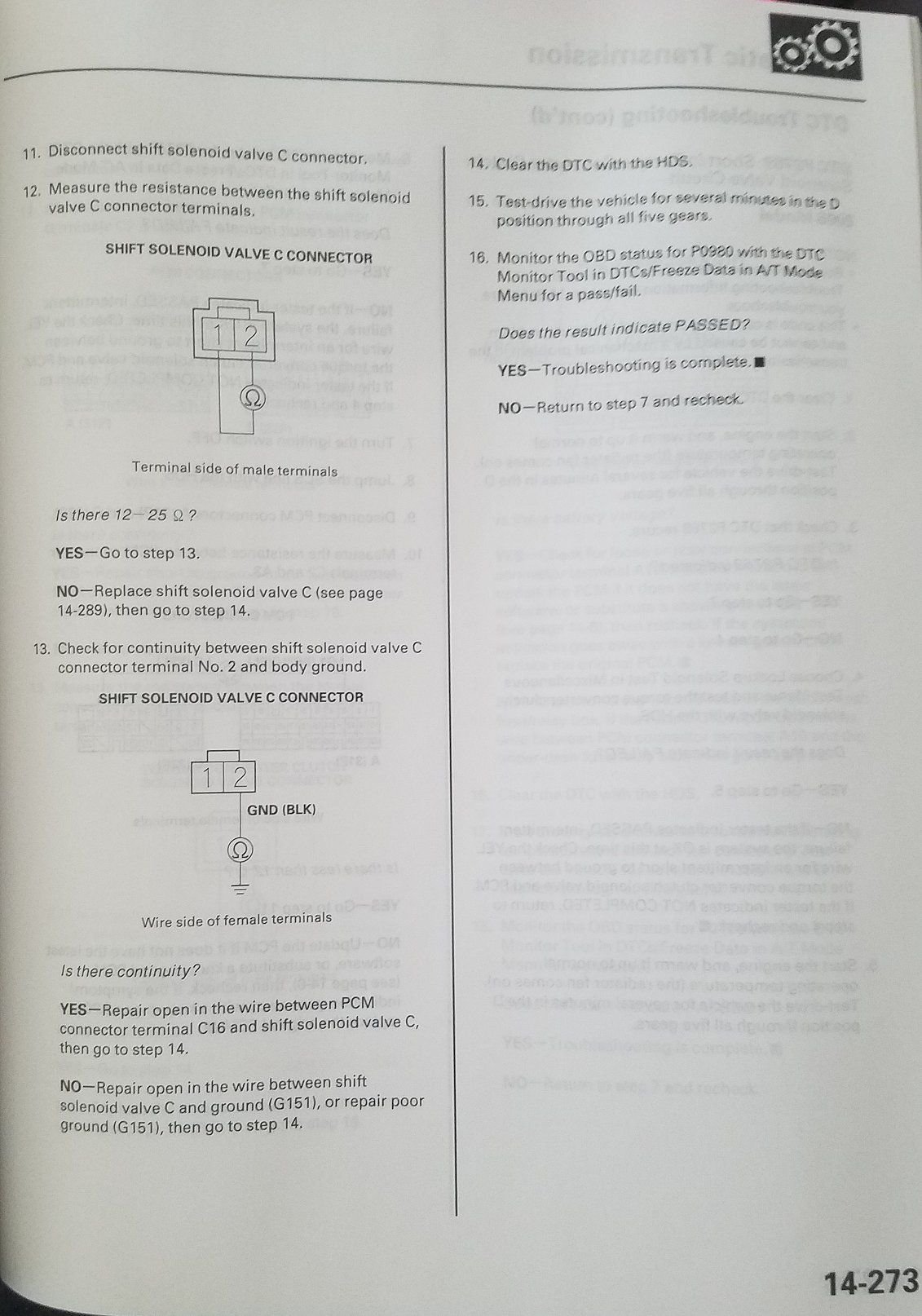

the HELM book says both of those codes are NOT related to an internal transmission problem. See the #2 comment.
So replacing the transmission is not recommended by HELM. see pic.
But it could be an external solenoid, like the ones you replaced. I read through the troubleshooting procedure, you need a HDS tester to test the solenoids, but as you said, you already replaced them. But an HDS may still be needed. You have to read the procedure to find out. It did mention replacing the ECM under certain conditions.

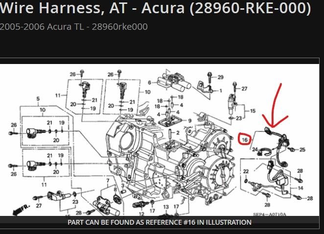

Old May 6, 2023 | 04:58 PM
Posts: 6,901
Likes: 2,208
Originally Posted by WeekendWarrior
Tlowner2006, would you mind sharing a photo showing where that wire harness (part #28960-RKE-000) is located?
The parts diagram below may help with its location?

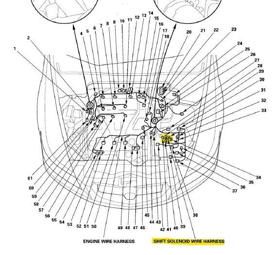

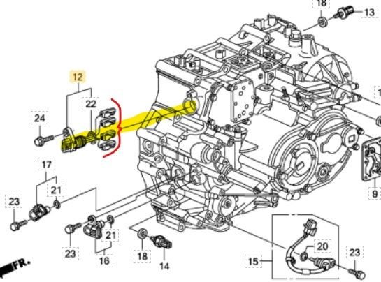

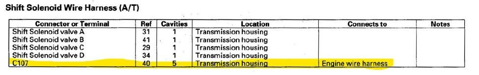

Looking at the OEM parts diagram below & the picture provided by the online vendor, one would think that the #12 assembly would fit inside the 'hole' where the straight line leads to, especially because there is a #22 O-ring involved.
However, if you look at the Helms service manual diagrams below, one could easily think it is located outside the transmission case?
Best way to quickly verify for yourself is to use the physical orientation of the part on the trans. case, in diagram above, and find where it is on your car?
Maybe someone who knows for sure will chime in.
