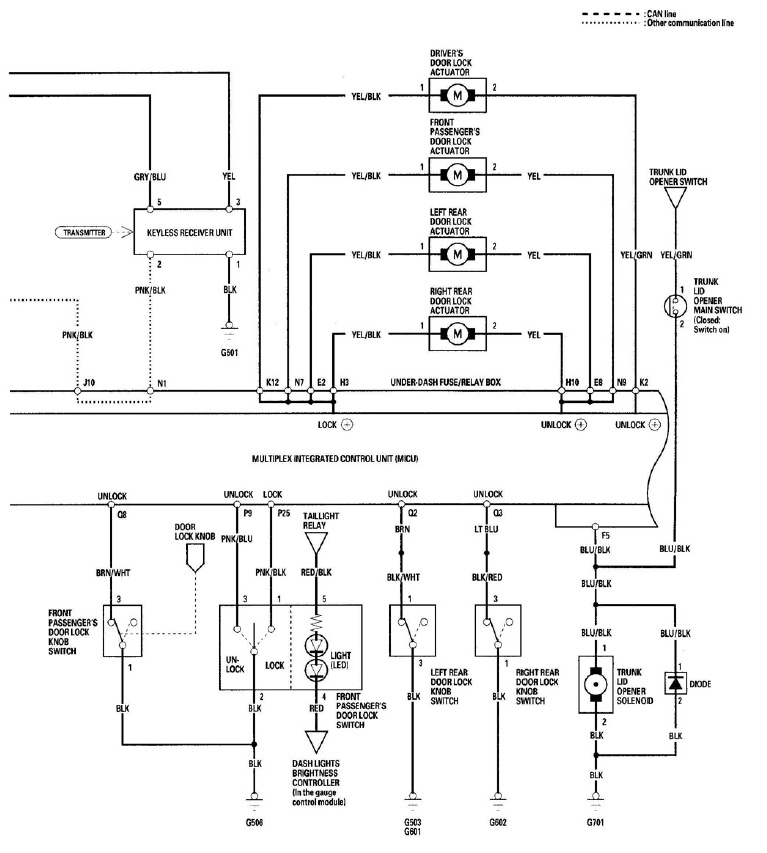

- Check all the fuses related to the transmitter.
- Under dash: No. 21 & No. 6
- Under hood: No. 15, No. 22, No. 23
- Check power and ground is good to the transmitter unit.
- GRY/BLU = Battery Voltage
- YEL = Battery Voltage (positions ON and START only)
- BLK = Ground
- PNK/BLK = Com line (you'll probably need a scope to see it)
- Check the remote start system does not interfere with the transmitter system

Check all the fuses related to the transmitter.Under dash: No. 21 & No. 6Under hood: No. 15, No. 22, No. 23(checked all these fuses)
- GRY/BLU = Battery Voltage (12.3V)
- YEL = Battery Voltage (positions ON and START only) (12.3V on start position)
- BLK = Ground (ground)
- PNK/BLK = Com line (you'll probably need a scope to see it) (I'll try get a cord with an oscilloscope out there)
- Check the remote start system does not interfere with the transmitter system - I m not sure how to do this one, but this shouldn't be the case?
