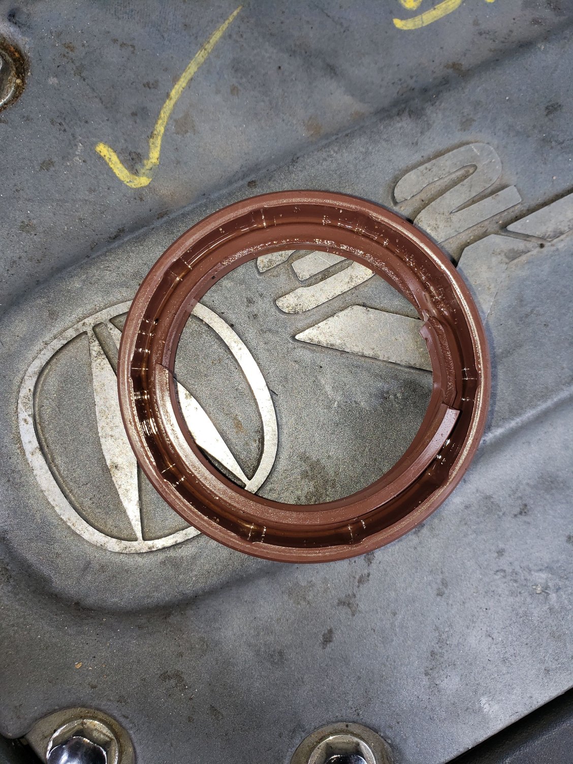

Well that was fun. Turns out I somehow shredded the crankshaft seal. The good news is it looks like I can replace that without pulling the oil pump off. At this point I'm just documenting for the (hopefully never) next poor soul to have this many roadblocks to getting their TL back on the road lol

In addition, when you get the old shredded crankshaft seal out, take a picture so we can see how disfigured the crankshaft made it.

Totally forgot about the battery tie town! Thank you!
As for the seal, as with many things on this project, probably user error, looks like when I put the pump back on the inner part of the seal folded in and got snagged... woopsie.
I've learned a shit ton about this side of my engine though lol.

man... you need to grease the inside and outside of the seal before pushing in, otherwise, the seal will roll, especially the inside. The way I did it was using multi-purpose grease on the inside, this is recommended within the service manual. I used fresh engine oil on the outside ring. Then I used a PVC pipe that's about the size of the outside diameter of the seal, with a washer big enough to fit the crank bolt through, then I used a 19mm on a 1/2" drive wrench and drove it in slowly. Then I made sure it's flush by running my hand around it. I even doubled up by using a socket with a mallet and lightly tapped all the way around the circumference of the seal.
