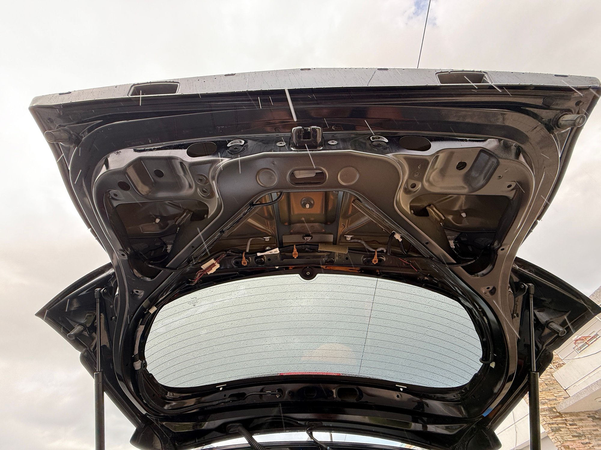

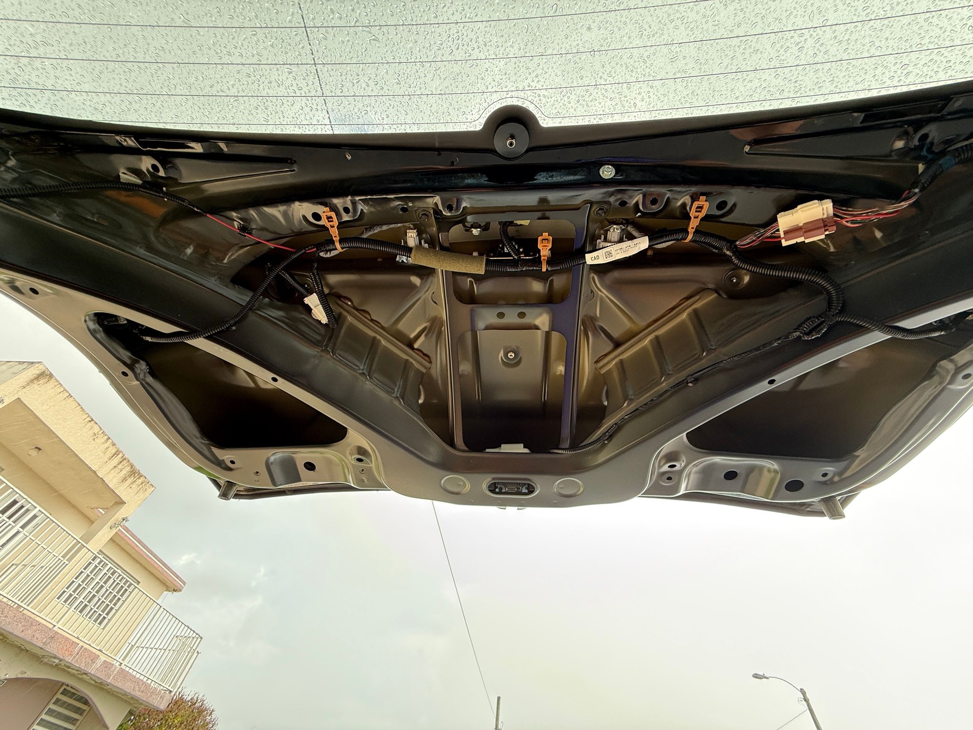

Probably you won't remember but do you know which cable is? I attached some pictures because I don't find the cable you meant.
The OP posted this issue he had in the 3G TL forum, as well as the fix that corrected the problem within his 2011 post #7 above.
I doubt that it would pertain to the pictured hatch, above, on your 2012 RDX since it is a completely different model.
yes, I'm very sorry. I noticed it after I posted 😂😩 this sucks, but will see what fixes it!
thanks, man
