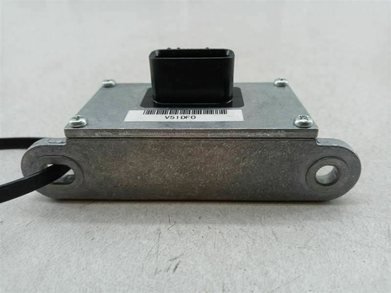

Thamks for the reply, I took it to a shop and they diagnosed it and it’s the yaw sensor that’s acting up. They quoted $1500 to replace it.

Are you saying replacing THIS part
...is a $1500 job?
...is a $1500 job?
damn never saw this reply. $1500 for the whole job. Now the cruise control doesn’t work at all but arms. The steering wheel switch was replaced in late 2021 and the servo sensor early last year and it still worked on and off.
