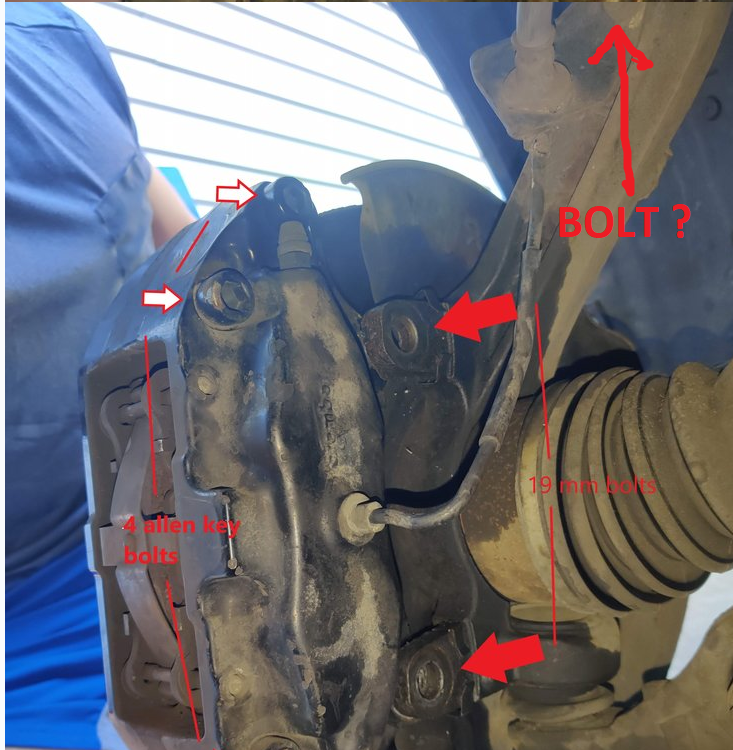

Yes, I took off the two 19mm bolts on each caliper. There are 4 allen key bolts that I did not take off. Also not sure if there are slider pins on the brembo calipers. I checked yesterday because I got some grease for that very thing, but didn't see them.
I'll upload some pictures, but not really sure what it'll accomplish, there's not much else back there to remove other than those 2 bolts and the 4 Allen key bolts.

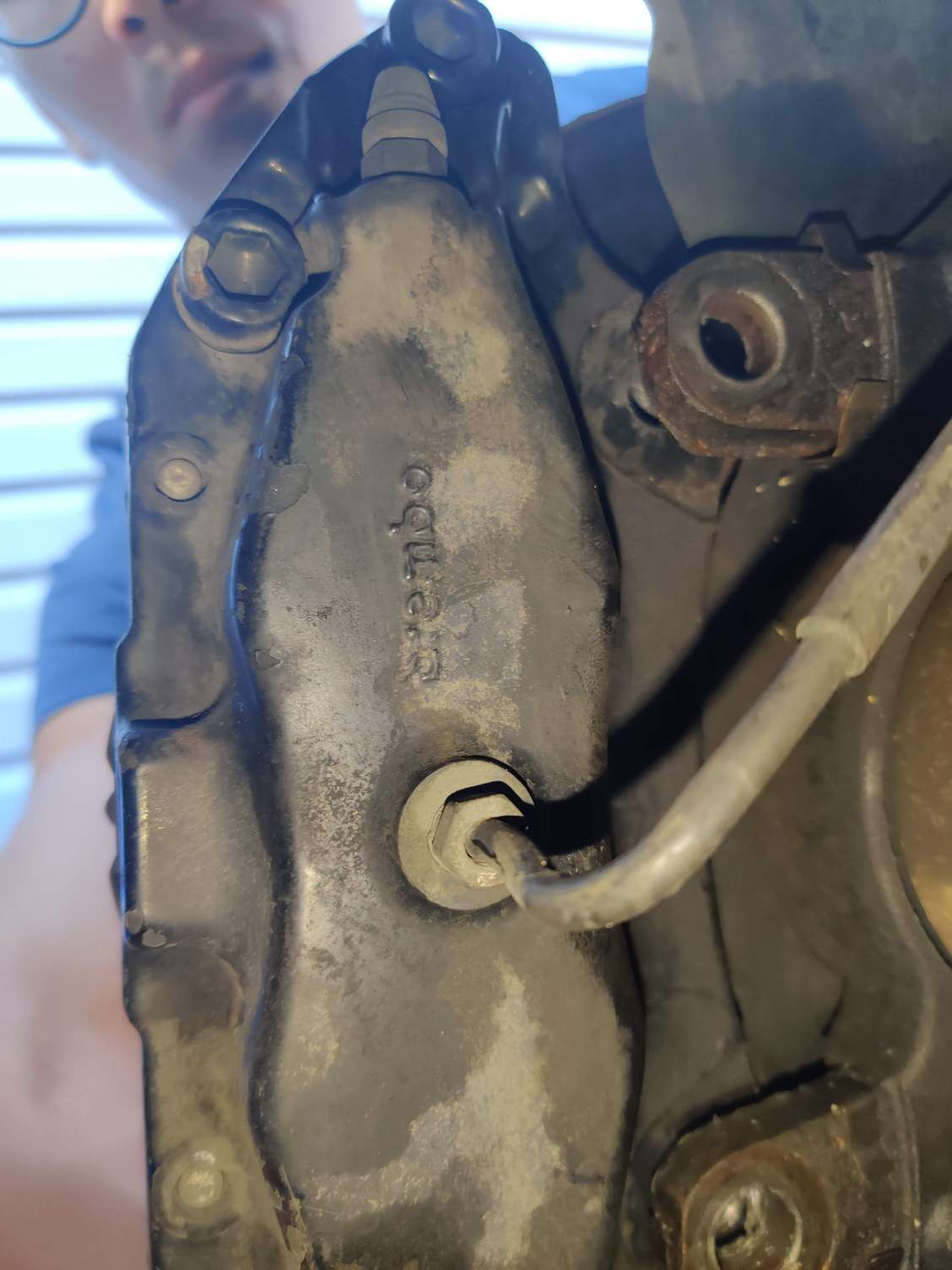

Here are the pictures:
It looks like the caliper is coming off, but it's just stuck to the rotor which is what's coming off the wheel hub.
Also, I took a few pictures of the front of the rotor, and I'm no mechanic, but they don't seem to be TOO grooved to the point where I wouldn't be able to remove the calipers.

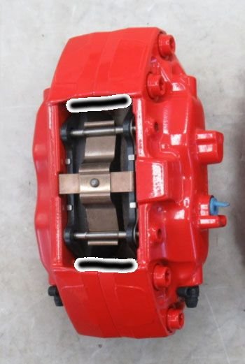

what i do is i punch out the slide pins that keep the brake pads attached to the brake caliper and then they remove fairly easily.

Did you take the bolt that holds the brake line out? You know, the line that comes out from the middle rear of the caliper, and then connects to the rubber hose, and goes further towards the car.
You can also turn the wheel so it's easier to see the pins and bolts. Especially when working on the ground.

The bolt in the middle of the first picture? No, I thought that would cause brake fluid to leak or something, so I didn't remove it.

You don't want to undo the brake line, just the bracket that holds the line to the knuckle. Sorry guess my wording wasn't precise.
The red arrow in the right top.
Gotcha, thanks. Removing that just gives the caliper more slack once I take it off the rotor to prop up on the hub right?

So, finally got the calipers off. You guys were right, had to punch out the 2 pins on the caliper, use a flat head screwdriver to compress the pistons on one side of the caliper, remove the pads, and the caliper came off the rotor finally.

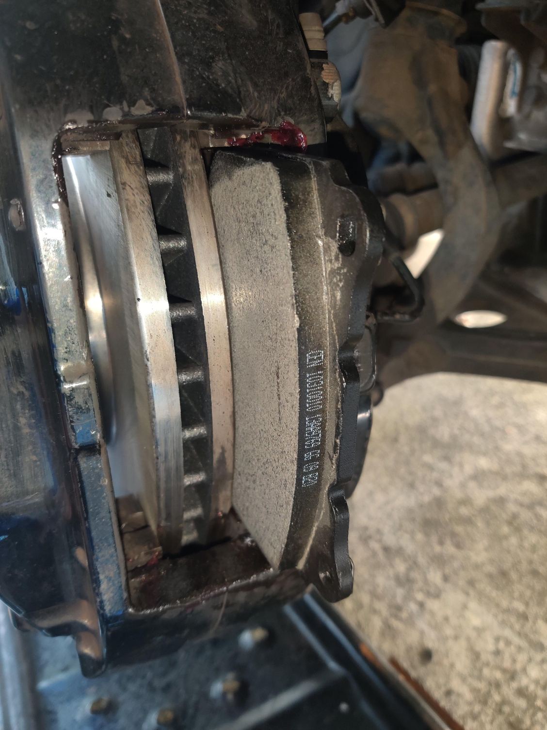

So, I cleaned the top and bottom contact points, greased them up a bit, did away with the re-used shims and they still wouldn't fit.
I tried taking off the caliper again, installed both pads, the 2 pins and the metal bracket thing, and it wouldn't fit onto the rotor either.
The damn pads are just way too thick, I've messaged RockAuto, but it was either a replacement for the same pads or a return. Since it's my daily I didn't have time to wait for the return and order a new part so, hopefully the replacement pads they send will fit.
I took some photos of my attempts.
pistons on both sides are compressed, even if they weren't fully compressed there wouldn't be too much room for the pads to slide once I press the brakes.
this is about as far as the pads will go in on the inside
Not a great shot, but this is as much as it would go in on the outside.
left side is the replacement, right side is the old worn ones.

Not really sure what to tell you. From pictures it looks like those pads almost slide in. You are 100% sure that pistons won't move any more?
Worst case throw new rotors on, and drive to some shop and let them throw your pads in. I doubt new pads have too much material. If any they would go other way.
