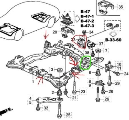

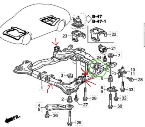

Looking at your picture, it appears this damage shown below is either on the left or right side of the subframe circled in green on the diagrams below the picture.
Comparing & contrasting the 07 / 08 OEM vendor parts diagrams below & assuming they are accurate,
your 07 TL-S Auto has 'differences' between the 08 TL-S Auto marked in red.
07TL-S:
08 TL-S:
Even if you wanted to purchase for big $$$ a new Auto 07TL-S subframe, they appear to be discontinued.
Therefore, if you get one (07) second hand you need to make sure to verify if the little two hole platform (next to #1) are present to make the connection for whatever goes there versus the 08 subframe that does not have one.
Same applies to the two red arrow items in front of the the area circled in green.
They are different between the two years, though, I suppose you could get an 08 to work on your 07 if the differences are not a concern to you?
These noted subtle differences, if they are depicted accurately on the diagrams, are the reason why the subframes have different part #'s, cabeesh?
