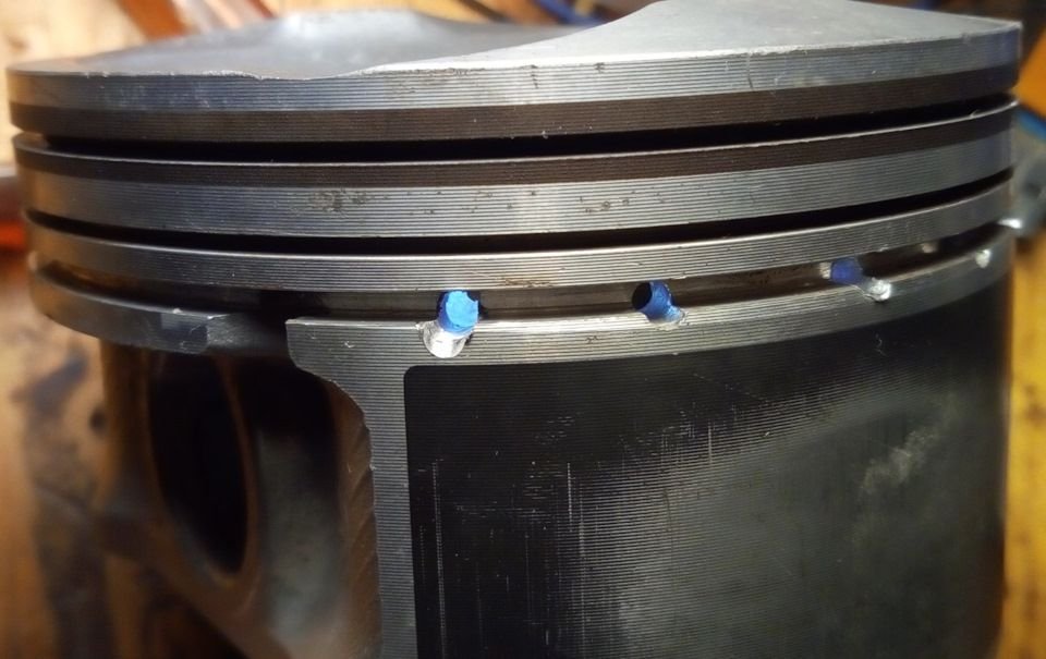

Yes, but this is not necessary, you need to clean the oil-carrying grooves on the old crowns and it is advisable to add one more on each side.
