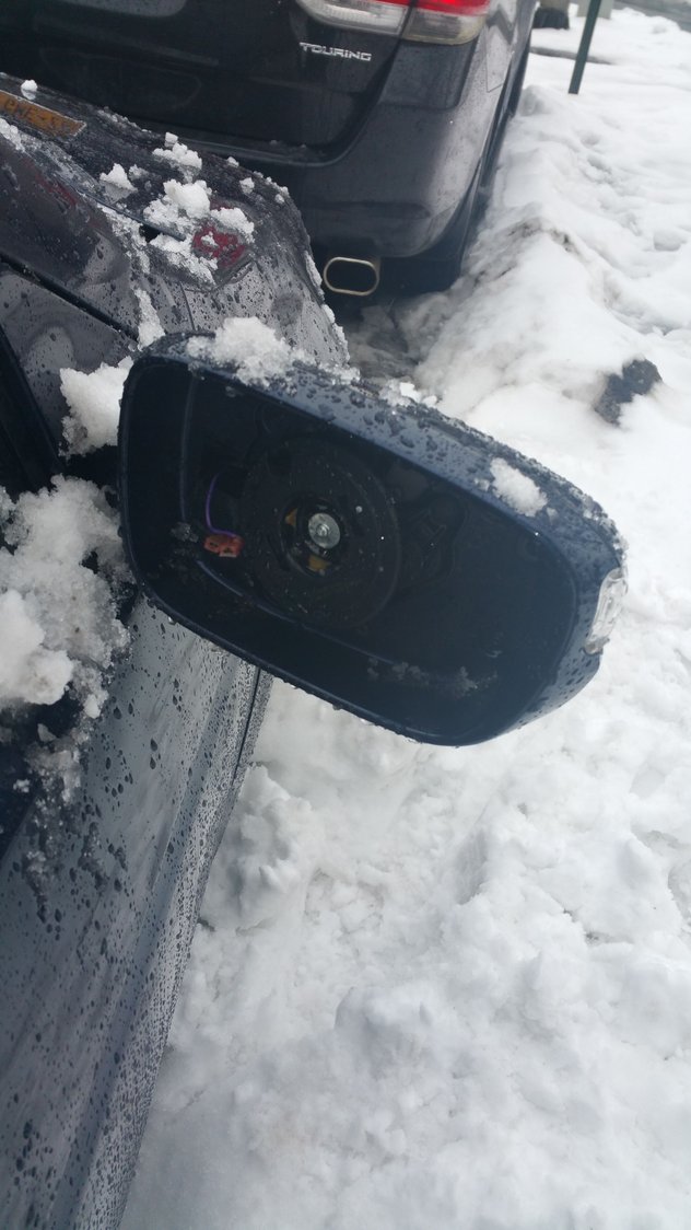

Hello all,
I havent been here for a long minute, but recently some thieves stole my passenger side mirror (just the glass with the holder) and i have ordered a new one in which only the glass it self came.
Does anyone know how or where i can buy the plastic bracket that holds the glass so that i can mount it onto the car?
Any help will be greatly appreciated. I will post pictures soon.

Absolutely not trying to be insulting but the glass you have has the plastic portion attached to it and it won't snap into or attach to the actuator?
Looks like the wires to connect to the heating element of the glass are in the wrong place. Did the wires get moved within the mirror housing or maybe you have the wrong side ( L vs. R) or wrong glass? Looking at the mirror housing with the wires as they are and the glass you have, I'm having a tough time making the geometry work.

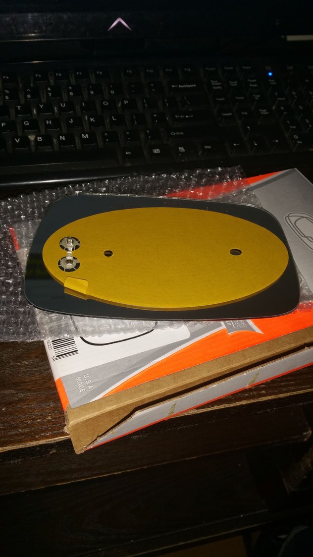

sorry bro...the top pic is what i need...and bottom pic is what's left.
the following pic is what i received.
This was the glass i received without the holder.

The heating element connectors aren't in the same place so one of those isn't correct.

When you order the oem mirror from Acura, it should have the plastic holder/bracket affixed to the mirror. The part number for the RH mirror on an '07 TL is 76203-SEP-A11. Here is a link to what the mirror assembly looks like:
MIRROR SUB-ASSY., R. (76203-SEP-A11) - $39.91 - 76203SEPA11

That's great dude...i still dont know why i only got the glass.

Sounds like you need to reach out to your seller for an exchange or straight up return and purchase elsewhere.
