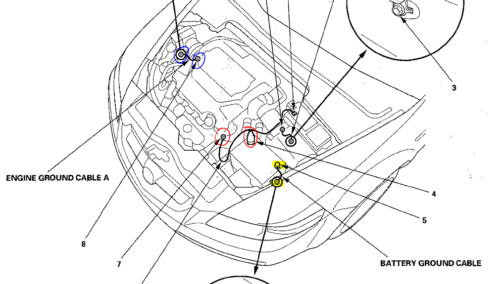

The corroded cables mentioned by the posters above could also cause your symptoms. When you first put your ignition to II, the corroded cables are cool and will let enough current pass to power your lights. When you turn your ignition to III, the starter demands too many amps for the corroded cable to handle. These amps never reach your starter but start heating up the cable. When you put the ignition on II again, the cable is still hot and will not let enough amps pass to power your lights. After some time, your cable cools and enough current will pass to power your lights. To test this theory, you will need a digital multi-meter.
I've attached the pages from the SM. You can start by testing the resistance between the positive battery cable and the starter (red circles). Getting to the starter looks difficult unless you remove battery (1:18 in the linked video). Remember to test the grounds as well (yellow and blue).
