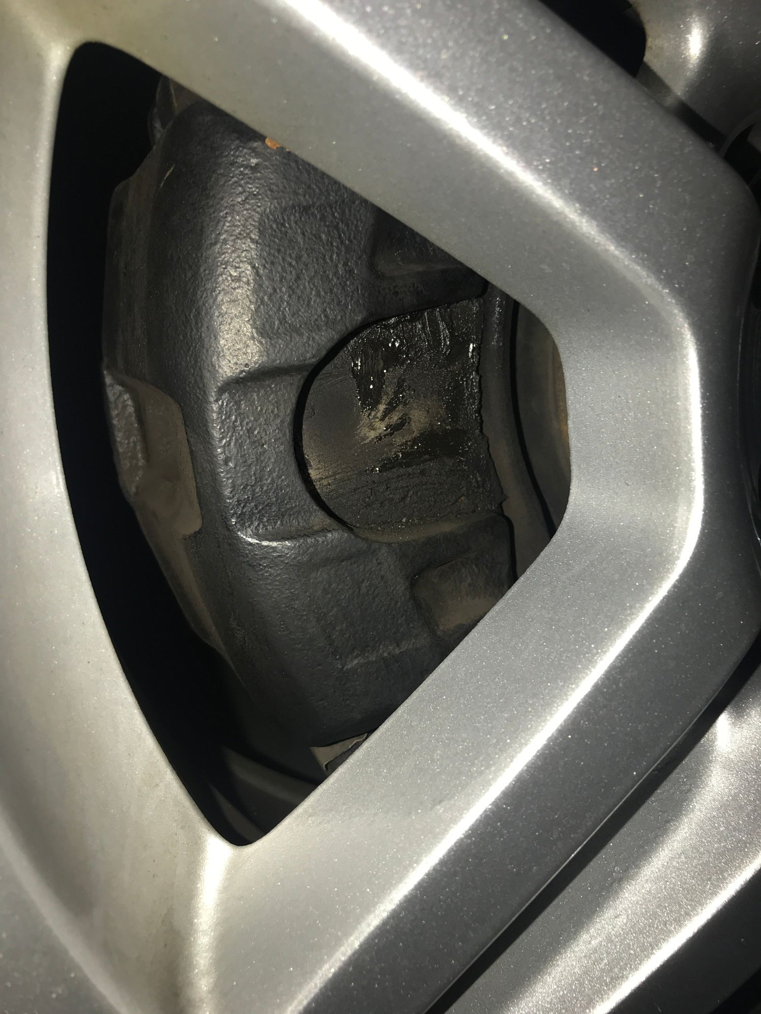

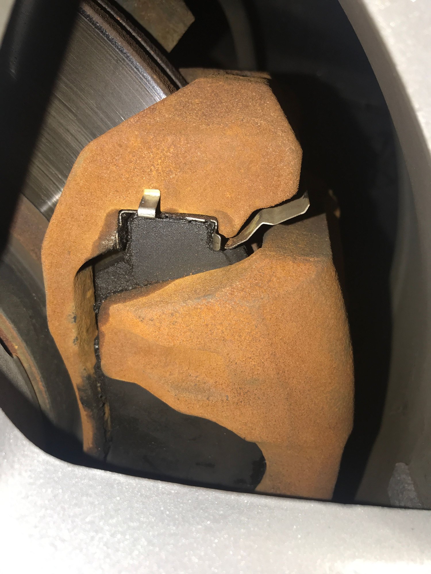

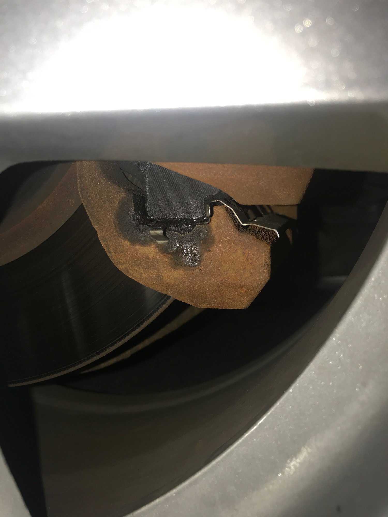

But holy crap I think you've finally convinced me! I went to go look at the brakes now that the car has been sitting for a day, and I think there's brake fluid on them. Can brake fluid get really sticky and hard to wash off?
The brakes are soft because they're leaking fluid? Wow. Who would've thunk it?

The shiny stuff in the first picture looks like it might be some kind of 'brake quiet' substance they place on the outer pad to keep it from sqeeking as it is next to those caliper sides.
The other pictures appear to show 'lube' they put on the end of the pads and within the pad retainers to help them slide versus an actual 'brake fluid' leak.

Really? I thought I was on to something...
If the brakes are locked, usually there's visible evidence, like excessive brake dust or uneven marks on the rotor. I was so excited for a minute there.

the 2nd and third pics kinda do look like brake fluid.
to be sure, the wheel needs to come off and you;ll need to inspect the brake lines going to the caliper.

Just letting you know; the wet spots on the passenger caliper are also sticky like the driver caliper.
