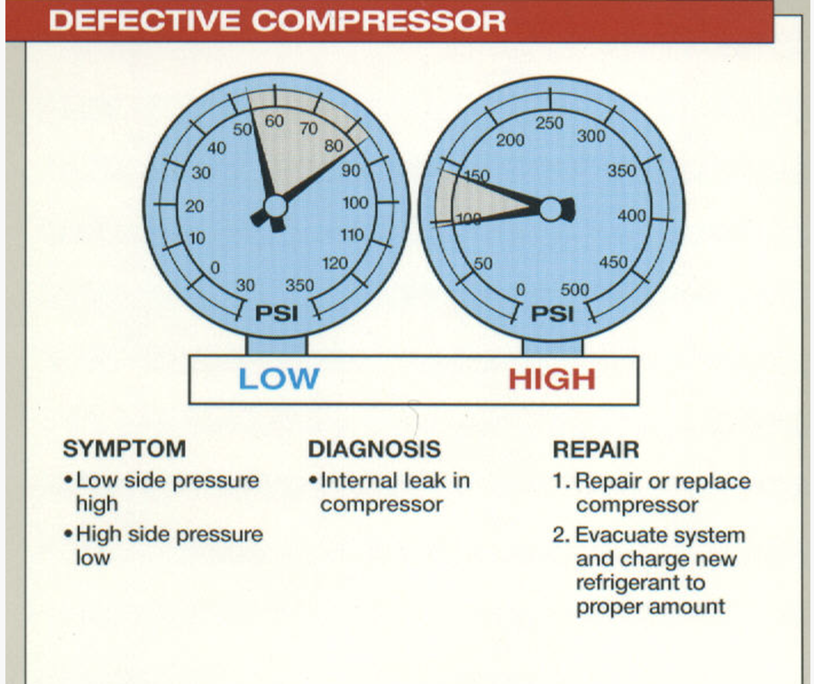

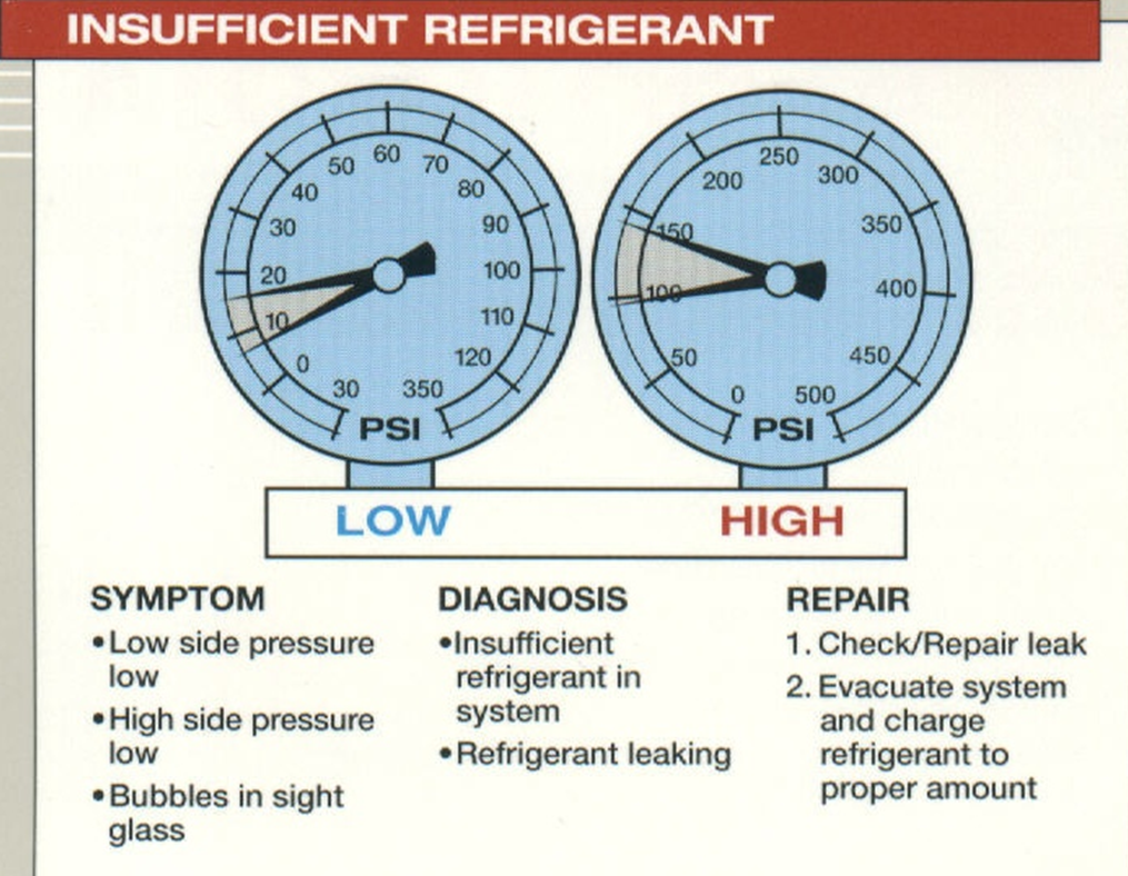

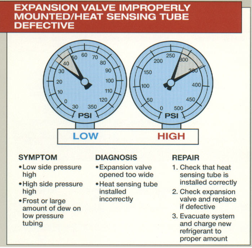

OP, inspect your condenser for damage fins or blockage. Spray some water on it while at idle and see if that makes the AC blow colder. Also, get yourself a
basic thermometer basic thermometer
and stick it in the center vent while you troubleshoot to get accurate temps.
Hope the attached info helps.

Finally time for an update. I gave the condenser a good cleaning and made a big difference. I can't get access to a full manifold gauge set, but from research and seeing how low side pressure drops pretty slowly to about 45psi using testing method above, and 95psi when off, i think my expansion valve isn't quite working properly. Regardless, it was 35 degrees out today, and the ac took a bit longer than usual to start blowing cold air than it should
It eventually blew ice cold when stopped and driving. Good enough for me for now.
