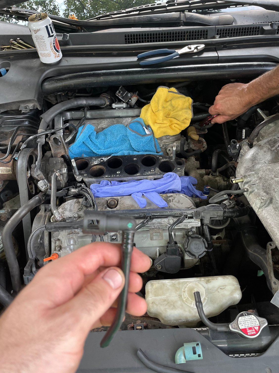

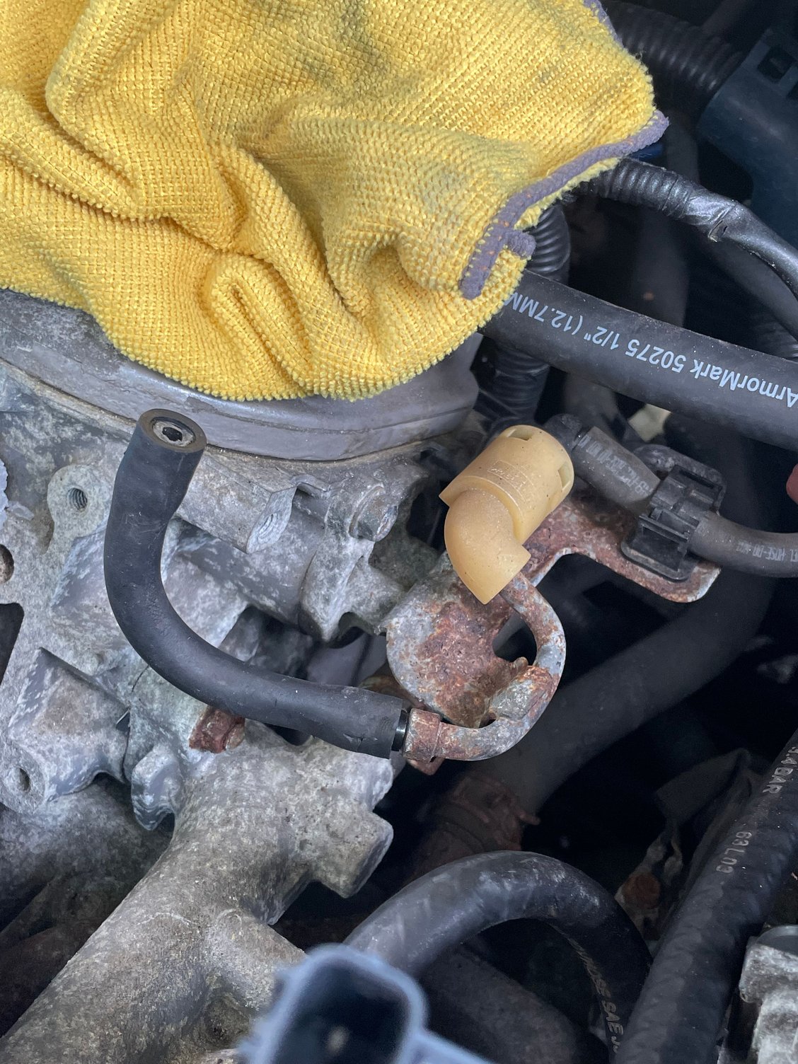

I need help! What the hell is this piece and where do I get a replacement. Was taking off the fuel rail and it snapped right off. It connects to the fuel rail it’s a quick connect adapter plastic and rubber hoses. Plastic garbage! I can’t even take the hose off from where it connects to the metal. Assuming I have to buy the adapter connected to the hose and block. If I need to replace where it bolts on to the block where do I get the whole piece? Went to autozone and they know absolutely nothing. Looked up some part numbers and nothing gives! Please help.

well, the part you have in your hand is the #14 + #7 , the fuel stay joint.
Old Jul 27, 2021 | 03:02 PM
https://www.acuraoemparts.com/oem-pa...bC12Ni1nYXM%3D
#7 16726-RCA-A01

part is on backorder called about 10 dealerships omw to a pick a part tomorrow that has a 06

Word of advice to all 3g TL owners be careful if you ever need to swap out the fuel rails. That part is very sensitive and difficult if it has high mileage.

You can always cut that plastic hose to get it off the metal line and replace with fuel injection hose from Napa (those hoses are much tougher than any other fuel line hoses).
