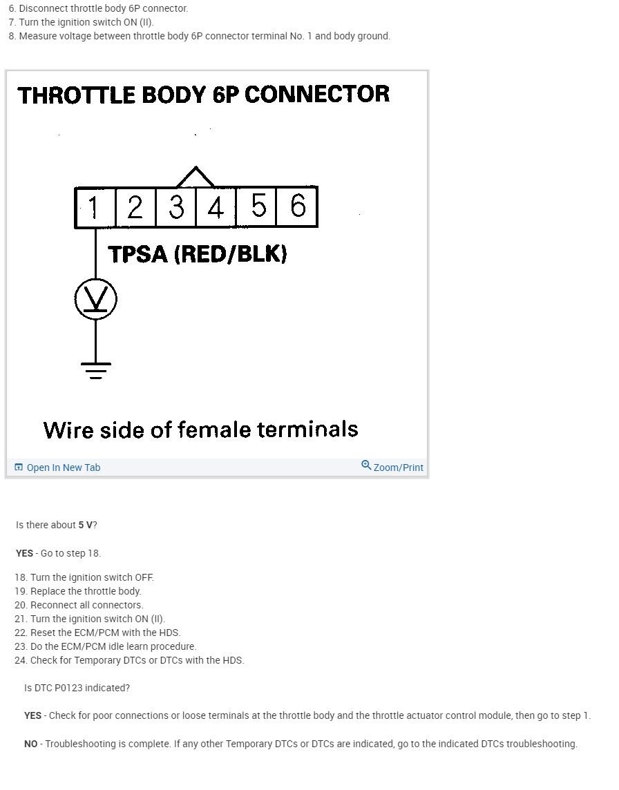

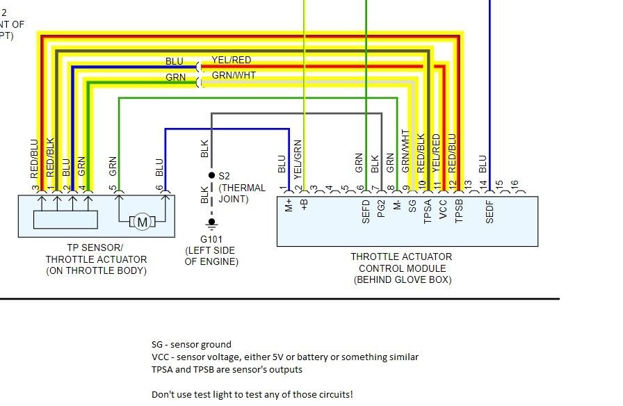

I believe that P0123 is not a code for APP sensor (accelerator position sensor).
It is for throttle position sensor, and that refers to actual position of the plate in the throttle body. So the problem would be either "throttle body" or "throttle actuator control module" (or wiring in between).
That's what AllData suggests in terms of testing. If you want the rest of that document let me know.
Preferably under load (with throttle body connected), check if TB sensor is receiving ground and Vcc. If throttle body moves with engine OFF and gas pedal depressed, check outputs. They should change depending on plate's position.
Moving plate by hand is not recommended, but if you suspect it's faulty then you won't make it worse, right?
