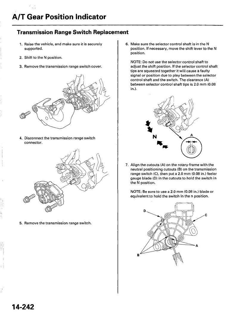

Hello all, It's during the corona Covid-19 quarantine time that I am working on my 3G TL again it's an 06 Automatic. Problem is the neutral safety switch/ trps going out and I cant seem to align it right even when using the old Neutral safety switch as a reference. The sensor is behind the front left side wheel. I took the old crusty one off went to autozone and got a duralast neutral safety switch. Installed it and the car starts up.
I found out in this link https://acurazine.com/forums/third-g...switch-892223/
that I should start the car in neutral before starting it in park and see if the PRND box on the dash/speedometer lights up. It doesn't light up. Any other tips on how to align it right and get the PRND box to light up?? Any help appreciated.

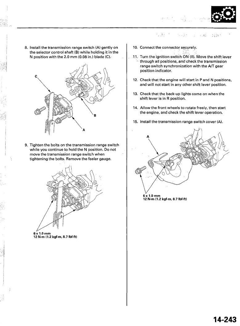

hi,
I'm attaching the SM pages. They have directions on how to align the switch.
Last edited by redbeard1; Apr 1, 2020 at 01:13 PM. Reason: link was already mentioned in op post
