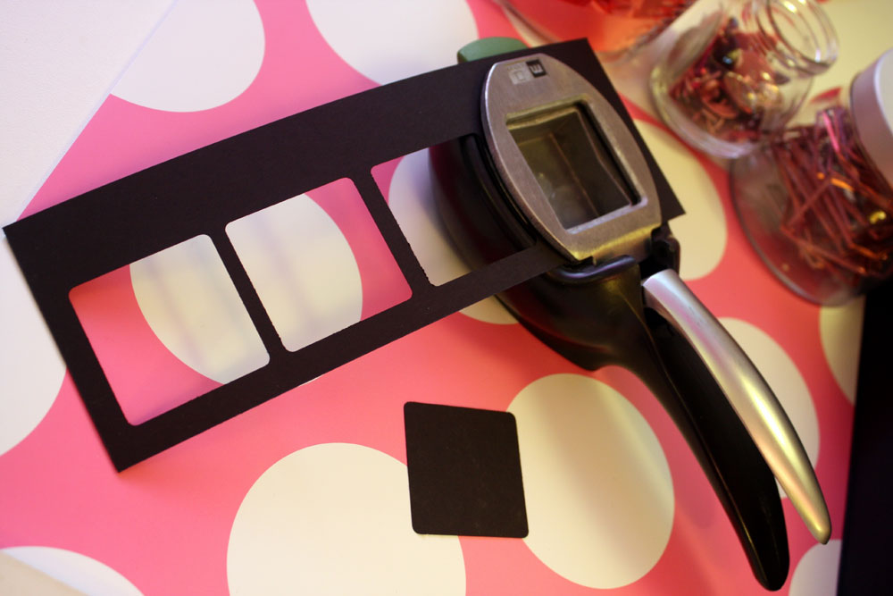

I also wonder if some kind of die or punch would be useful for speed, accuracy, uniformity, etc. Something on these lines, but probably more heavy duty; a "chisel"-style punch would be great, I think.

Edit:
Attachment 1495
^^^That's exactly how I felt about it, but didn't want to say it that way
