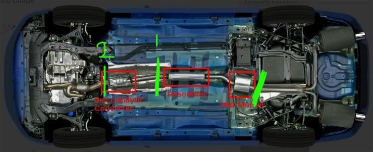

Ok going to give you a little more than you asked for. I’m a nerdy guy and like to be scientific as possible, hence I have 3 clips shot at basically the same distance away and location, at the same time of night.
This is stock vs stage 3, where you would delete the mid muffler and replace stock resonator with 12” Dynomax. Great improvement, best bang for your buck.
This is stage 3 before/after deleting the 3rd cat. I enjoyed this, it gave the car more purr in the tone, but barely any volume gain. Still no drone and definitely not overly loud. The best way I can describe it is when you say vooom vs vrrrooom, this mod will accentuate that “rrrr” sound in the tone. I like it when I’m downshifting to a stop. In terms of money, it should cost the same as doing a stage 3 since the number of welds and cuts is the same, so you could save yourself time and money by doing this along with the stage 3.
Onto what you asked for. 9.5” vibrant vs 12” Dynomax. The reason I included the 2 vids above is because I only have clips of the vibrant with the 3rd cat deleted, so wanted to give an apples to apples comparison, and not vibrant + 3rd cat Delete vs Dynomax with 3rd cat present.
If you found the Dynomax too raspy, or growly, you will like the Vibrant. It gives a nice clean tone that mellows out the Dynomax. (90-95% volume compared to Dynomax). Again no drone here.
From here, if you wanted an even more dry/throaty sound that’s little louder than the 12” Dynomax, you can try the 6.5” Dynomax 24250 (which I have clips on my channel). Even more throaty/ raspy? stage 4 with no resonator. Sounds dope in tunnels, admittedly, but quite raspy (not that it’s a bad thing)
if you want something a little more deep and mellow and smoother, than the vibrant, you can try the 8” Cherry Bomb 87521 in place of the resonator.
the 5 setups above should never get you pulled over for noise, and neighbours shouldn’t care. It’s noticeable, but definitely not loud.
now if you want to play around with the rear mufflers, you can get a good boost to volume by swapping one of the rear mufflers with the mid muffler you will delete.
. I really liked it, but there was this one mildly droning spot at 2.5k that got in the way of everyday driving.
feel free to ask away any other questions. I spent a boatload of money so you don’t have to ;-)

Also to add, the 4 resonators are similar in price, with about a $25 gap between cheapest (Cherry bomb) and priciest (vibrant). Go with what sounds best to you, that $20 will be nothing in the long run with a setup you love.
Dynomax had good quality, but was blown away by the finish and construction of the vibrant. Plus it’s stainless steel.
cherry bomb was really inferior quality and the paint was chipping off after a week but would have been fine if I had it welded on.
cutting the section of pipe from the mid muffler to the 3rd car, and replacing with a straight pipe with a resonator attached should cost no more than $150-200. Tenth of the price of those full exhausts. And you will not have drone

Nice, you are right. the Dynomax is more high pitched with not much bass, while the Vibrant does add some low-mid for an overall deeper and cleaner tone.
cheapest I could find was on Amazon, for all of the resonators. I am in Canada though.
since your setup is stock, I would suggest doing the stage 3 at once to save money. I would call a few local places to get a good quote and send them the below pic
If you want to lessen that texture/growl/rasp from my Vibrant clip, maybe you would like keeping the 3rd cat in place. (setup 1 above). Would make it slightly less loud and slightly less texture. (Compare that 3rd cat delete comparison I posted earlier yesterday. It’s there, but is subtle).
I liked that dry rasp, so in hindsight I would have just got the whole section from before the 3rd cat to after the mid muffler cut in one go, maybe put the resonator in place of the mid muffler instead of stock res location.
I would also check and see if you have a flex pipe leak. Mine was leaking and made me crazy. Spray some soap water on it with engine running and you should see bubbles if it is leaking.

I found the Vibrant part #1790, but it's 12" long, not 9.5". Just want to confirm that it is the correct part. I think I want mine to sound like yours in the video with the Vibrant, so I guess I'll need to get the 3rd cat deleted too. This won't mess up emissions or anything, will it? I'll still be able to pass inspection?
Old Nov 29, 2022 | 10:08 PM
PgLgGrg's Avatar
Joined: Aug 2022
Posts: 202
Likes: 33
From: Westchester, NY. Formerly ON, Canada
No problem, 1790 is the right part. 12” overall, but the “resonating” area is 9.5”. Extra room for fitting over your stock pipe, so you’re good!
As for the 3rd cat, nope! You are good to go. It’s not monitored so no check engine light or anything. Emissions will still be passed. I believe the extra cat actually made it a more eco friendly car than the civic of the same year!
if you live in an area without salt on the roads, you could unbolt the cat off instead of cutting it. But for a near 20 year old car, I doubt that would be the case.
if you’re happy with the the clips I sent you and you don’t want to tweak it by making it quieter or more warm, then definitely go for it! It’s a great setup IMO.
another option you could go for is clamping the resonator, if you have any lingering doubts. I actually have clamps on mine in case I wanted to change later, but think I will be keeping this setup with a cutout.
