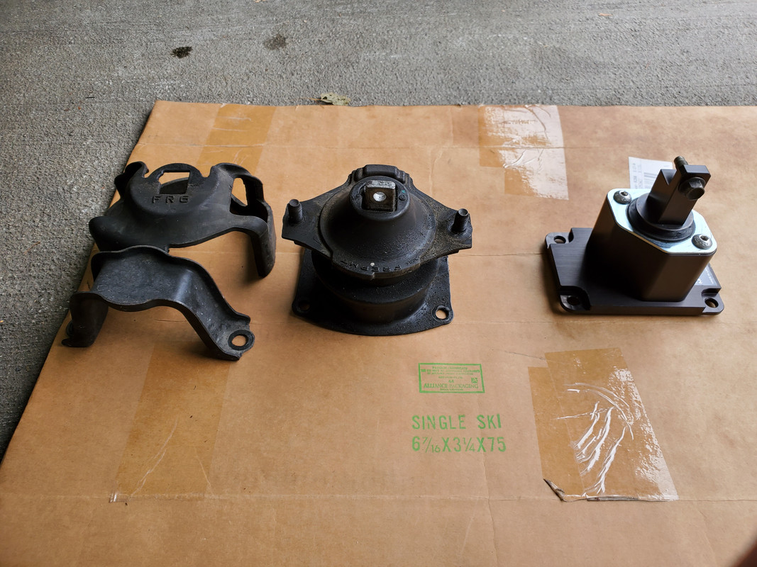

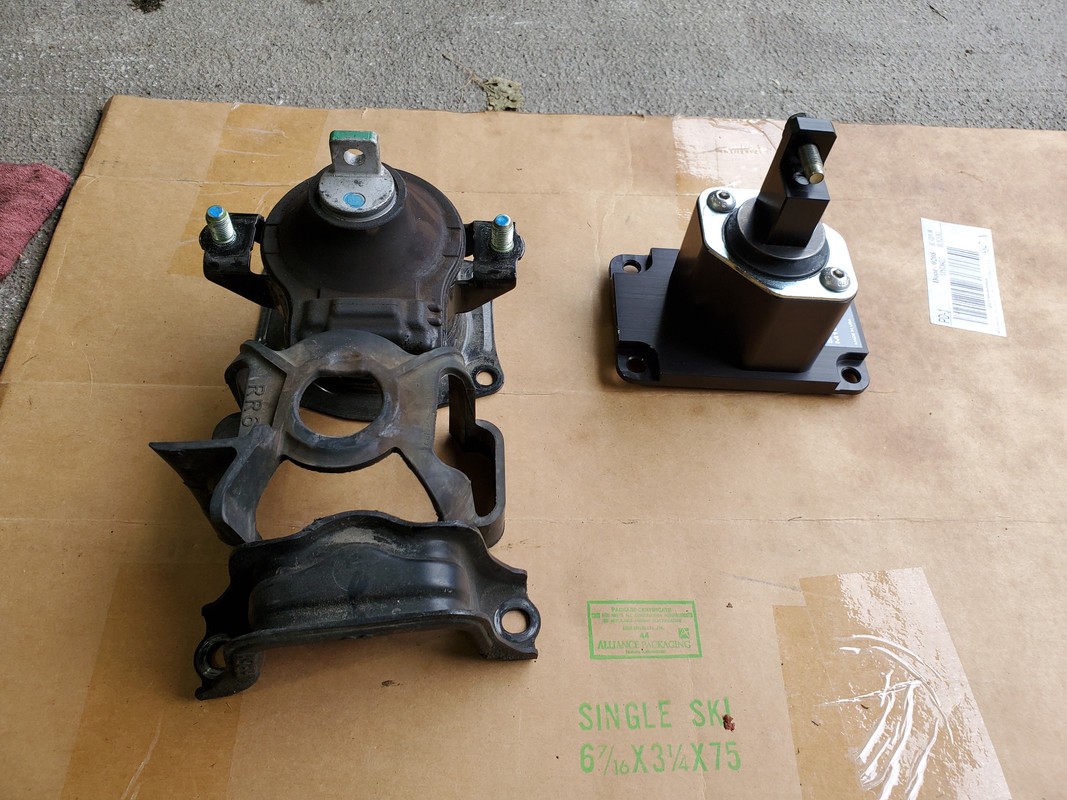

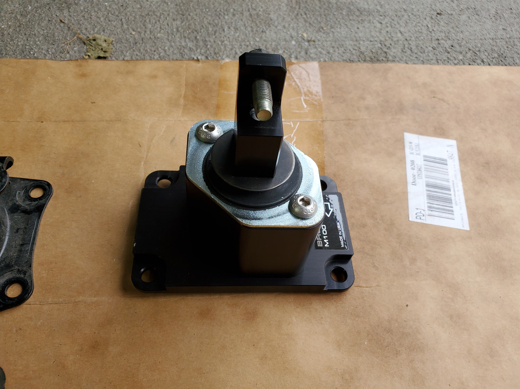

Engine Mounts
OEM Engine Mounts
So, for this I went with all OEM engine mounts. There are 6 in total - Front, Side, Rear, and then three on the transmission side. I highly recommend you replace these engine mounts on your car if you care about how well it drives and how well it shifts, it genuinely makes a huge difference. The reason I chose OEM mounts is that most of the times I've ridden in cars with solid mounts, I haven't liked the increased vibration transmitted to the cabin. For those out there with a stronger stomach than I, by all means go with one of the aftermarket choices available for stiffer mounts. I think the only mounts I would consider not replacing with OEM if I could do it again are some of the lower transmission side mounts - one or two of these has quite a lot of play in stock form and would probably be worthy of an upgrade for a trade-off of the increased NVH.

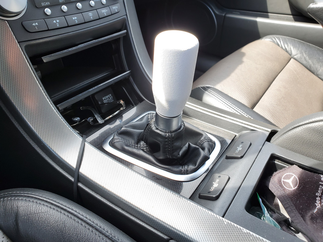

Shift Knob
Superklasse Runabout Shift Knob
Many of the aftermarket knobs that I see for Hondas are metal, and I'm just not a very big fan of a metal shift knob. As I mentioned above, my hand is prone to slipping off the shifter, and metal would likely makes this worse. My original plan for a shiftknob was a Flossy Grip Rod in white with a Spoon font pattern etched on top, but my experience with them as a business was a bit underwhelming, so I went elsewhere. The knob I ended up choosing is one modelled on the Supra/MR2 shift knob of the 90s weighted to perfection at 350 grams. This is really a dealers choice kind of mod, I'm sure the Fastline Maven counter-sunk shift knob I've seen popular here is also absolutely lovely.

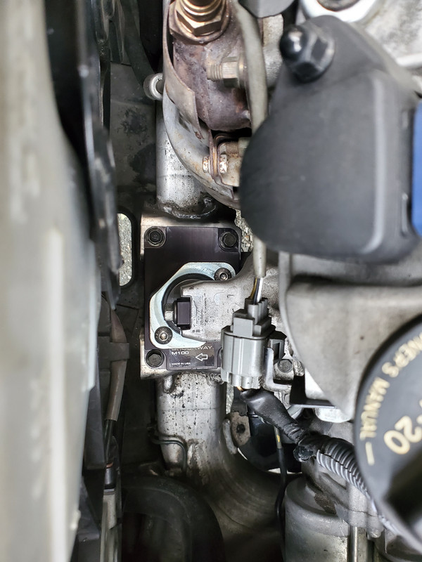

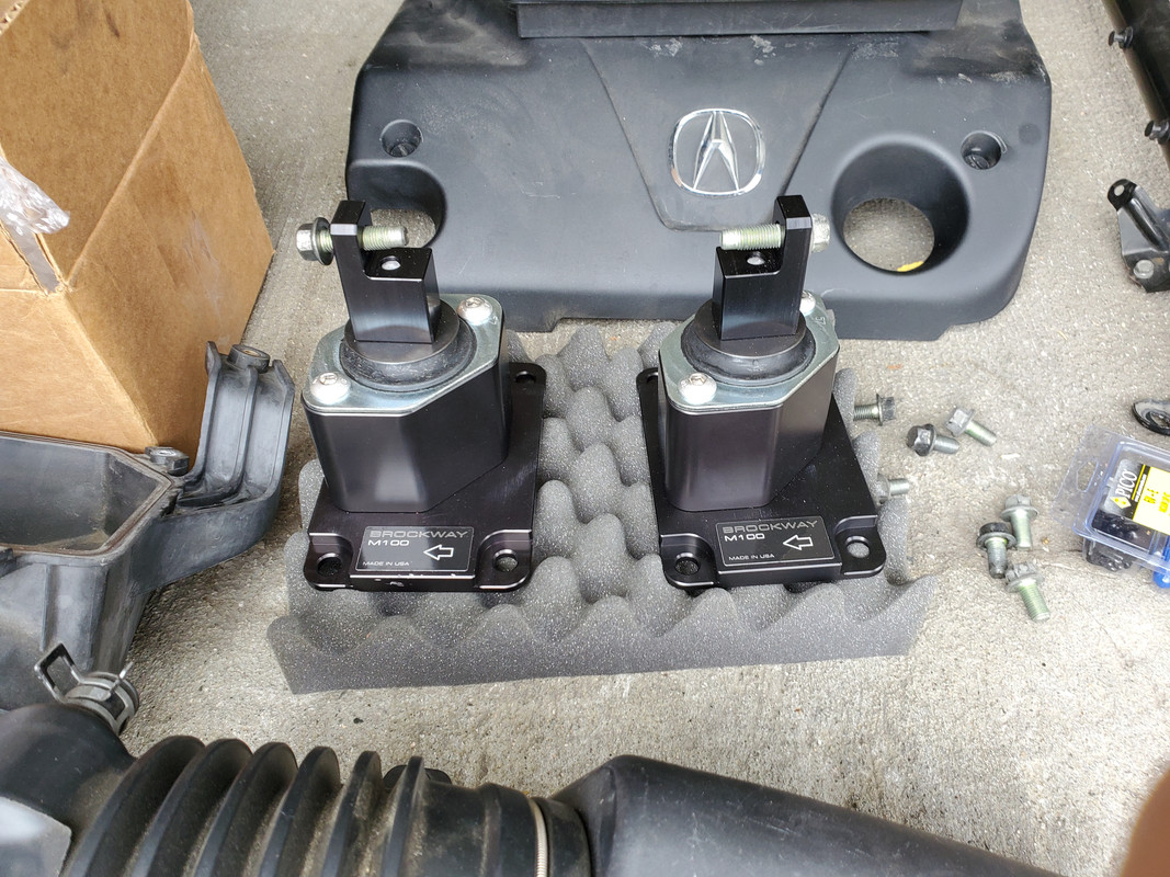

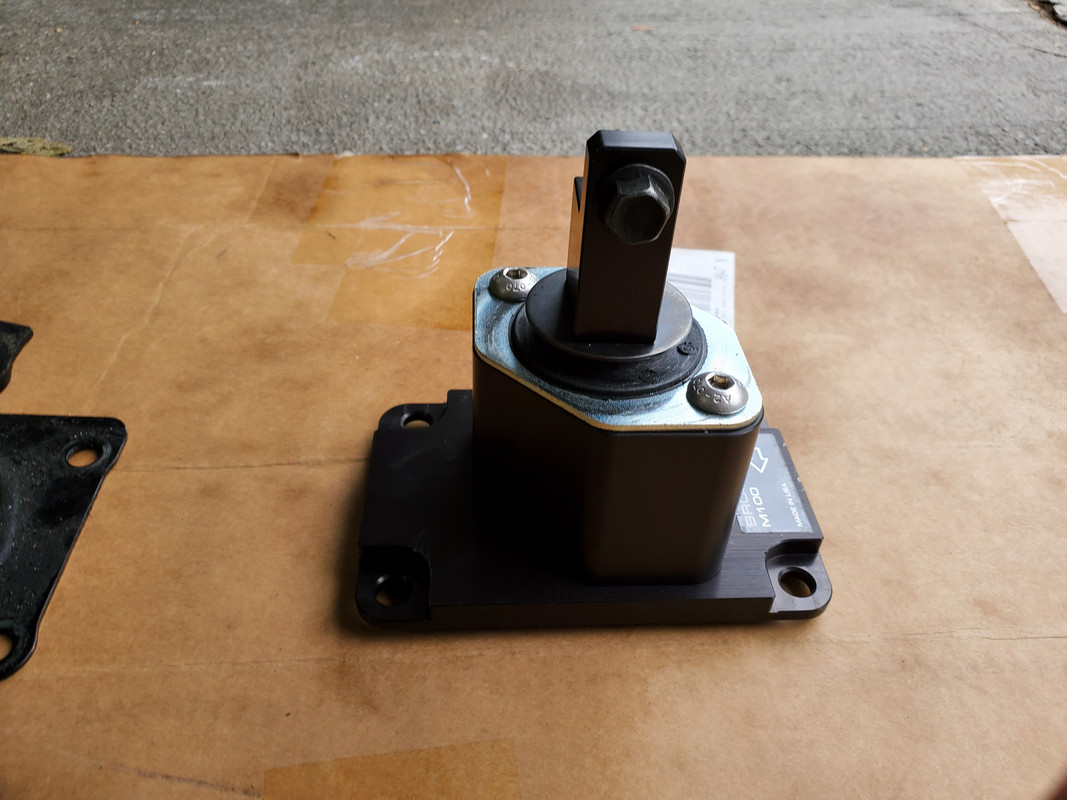

Well written and detailed post! On the subject of OEM mounts, the biggest issue is they tear. Just by changing the passenger side mount to an Innovative urethane mount, I haven't torn one since. And the minimal vibration is only noticeable in drive with the a/c on if your hands are on the steering wheel. With a manual transmission car it would probably be less noticeable. Something to consider if you've had issues with them going bad.

Seeing as I'm a legendary forum user, I feel compelled to add some comments.
Trans Fluid. I was using Redline MTL previously but I'm using Motul Gear Competition now. It's better.
Engine Mounts. Since engine mounts made with urethane are a joke (urethane is NOT an isolation material),
I designed a very nice set of mounts using natural rubber. Approximately 33% stiffer than stock mounts. The
engine vibration is noticeable now, but not at all objectionable. The powertrain movement is much better
controlled now. A very nice improvement overall.

I wish there were more appealing choices available for engine mounts to reduce movement. Most of the aftermarket choices for our cars seem like they would be harsh.
Any engine mount made with urethane will be harsh. You won't see urethane used for any OEM engine mounts.
Aftermarket companies use it because it's cheap and easy to source. I have some parts on order for a few sets
of engine mounts. PM if interested in a set.

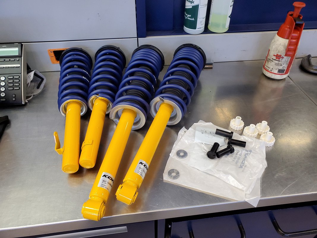

Suspension
Koni Yellow shocks / H&R Sport springs
When I bought my car it was on Function Form Type 1 coil-overs, and I really, really did not like them. The ride was offensively stiff, and even after adjusting them to the top of their height adjustment car was still way too low. I reverted the car back to a stock suspension setup (out of a base manual TL) just to get the car off the ground. It was clear to me that this stock setup was quite tired and also a bit too soft for my taste, the car pitched back and forth quite dramatically off and on throttle, and the other changes to my car didn't help (flywheel, lack of damping, etc). So I set out to pick a suspension setup that was one, brand new, and two, the right balance of stiff/comfortable. As I've seen many, many times on the forums here, most people recommend just going coil-overs. It gives you the ride height adjustability, lowering, and is actually cheaper than buying a shock and spring combo as I inevitably did. These are compelling points for a lot of people, and I respect that, but I can't stand the stiff ride quality of coil-overs and don't really care that much about how low my car is or adjustability. I knew I would be the most happy with a set of springs and shocks, so that's what I went with.
I eventually decided on a set of Koni Yellows and H&R Sport springs, specifically the 50106 part number, which is the sport variant for the Type-S specifically. Additionally I bought all new top hats, mounts, bushings, dust boots, bump stops, etc. The entire assemblies top to bottom are brand new.

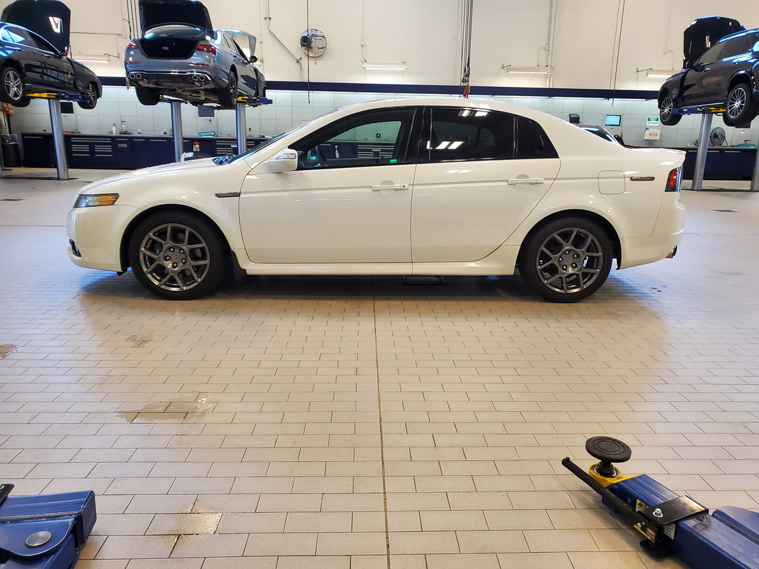

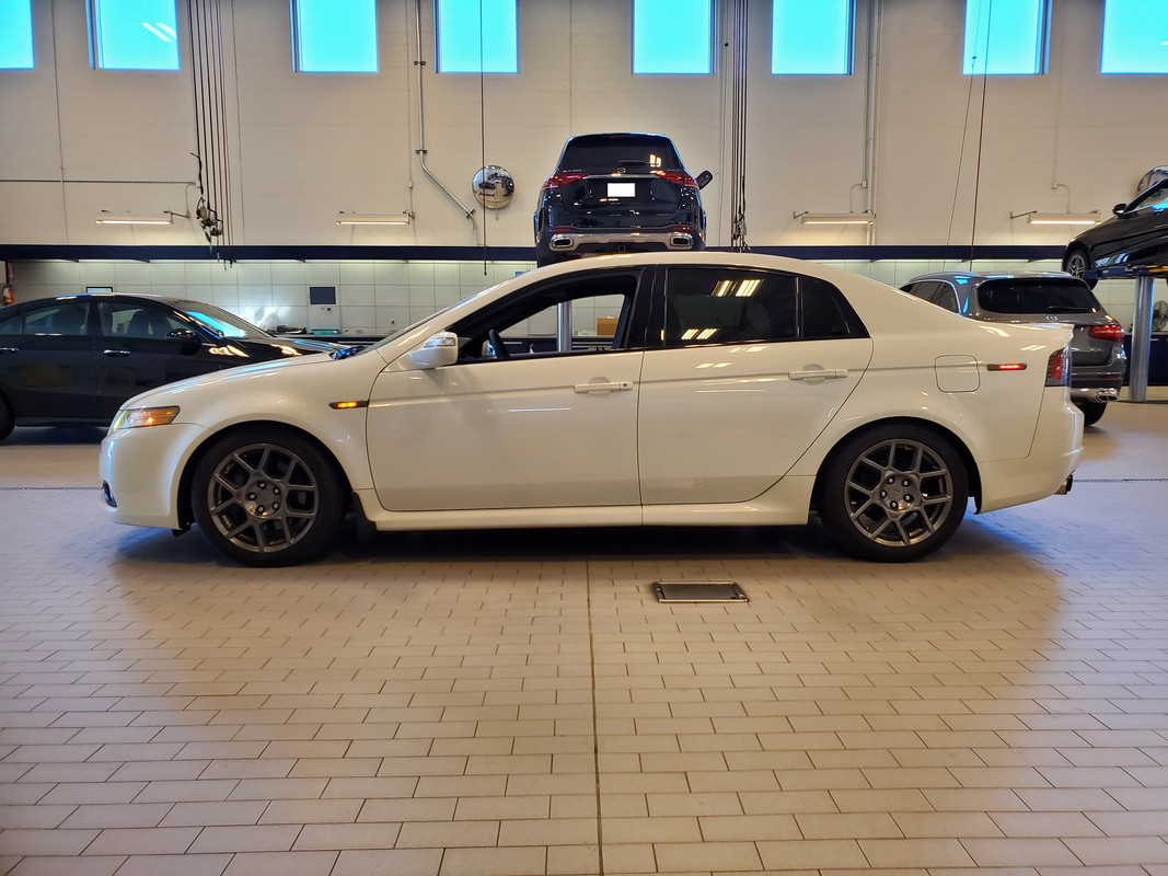

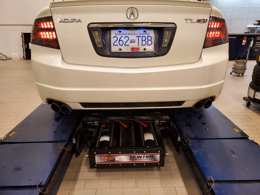

Stock ride height:
H&R Sports / Konis
For quick reference - my perch settings for the Konis are the higher of the two in the front and the lowest of the three in the rear. I spent a lot of time with my rear seats removed while I was playing with the damping settings, and settled on +2 in the front and +1.5 in the rear (they go from 0 to +4).
In terms of ride height I'm really happy. I think it's really even front to back and is a nice mild lowering that hasn't comprised the cars usability. No scraping or rubbing. The ride quality I initially found a little bit too stiff for my taste, but I have gotten used to it. I think this speaks more to how sensitive I am to ride comfort, but I want to highlight that these springs are not as comfortable as stock. I think many would say it's pretty much the perfect stiffness for a sporty daily, but if you have a sensitive stomach like me I'd maybe consider something even milder. I mainly wanted additional stiffness to combat the back and forward pitch sort of sensation that softer or worn suspension has and it definitely delivers in that regard. Car feels firm and composed.
Unfortunately I had some quality control issues with my Koni yellow shocks. The damping adjustment on my left front shock was completely seized out of the box. I had to pay Koni 50% for an advanced replacement which I have yet to receive a refund for, and also my time to remove and reassemble the faulty shock. After I replaced the faulty left front, I attempted to adjust my shocks damping only to find that now my right rear shock was also seized. Before going through a warranty claim, I attempted to un-stick this shock by removing it from the car and an attempting to adjust it - the leverage available with the shock installed is not great. Luckily, I was able to unstick the right rear shock relatively easily once I removed it from the car, but it was more time and effort to remove it again.

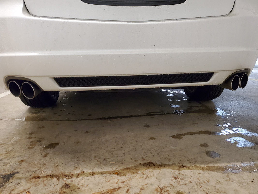

Exhaust
Rear muffler delete
Story time. I bought my car with an obnoxious setup which was basically cats and one aftermarket resonator and that's it. Lots of drone and quite unpleasant. I found a local fellow with a nice original OEM TL-S exhaust for reasonable $$ and installed that. Unfortunately my car underwent some Unauthorized exhaust modification in 2020 while parked in my underground parking lot which resulted in most of the system being replaced with brand new OEM bits. Not the easiest or most cost effective solution to what happened, but I'm a little crazy about stuff like this if you couldn't tell already. One side effect of having the exhaust replaced was that now my rear muffler tips were way out of alignment; they looked absolutely awful. The day I drove my TL sans third cat made me miss having some sort of noise from the exhaust and so I seized the opportunity of the tips of my new exhaust being miss aligned to have an exhaust shop one, relalign the tips, and two, delete the rear mufflers. I had never heard one of our cars with just the rear muffler deleted, but it had been a happy medium for me personally on a lot of my previous cars. I'm extremely happy with how it turned out, my exhaust tips don't look like dog shit anymore, and the car has a subtle, appropriate amount of noise. I've had friends compare it to the volume of a stock E46 M3, but I think it's slightly louder than that.
Crooked tips
After the rear muffler delete
Shift knob
Shift Solutions SB Series (SS 530G)
I have since swapped to a different shift knob as well since my original post. I generally don't like metal knobs as I previously mentioned, but I ended up getting one with a rough powder coated texture on it, which solved the things I usually don't like about metal knobs. The main reasons I ended up switching were the extra weight, the shape, and the texture. I like this new knob a lot more than I expected I would, and have had a few other people drive the car and express the same sentiment. Currently I'm still running the stock shift boot and little silver ring so it looks a bit goofy, but I intend to get a new shift boot from redline in the future and I think it will really 'pop' in the interior.
Engine Mounts
Brockway Engineering M100 Engine Mounts
Ohhh boy. After replacing the suspension in my car with a newer, stiffer setup, I was chasing that improved feeling 'high' and ordered a set of Eric's absolutely beautiful mounts that he posted in this thread. Not only are they absolutely gorgeous, I can confirm they also do what they promise to do - greatly reduce engine movement with a minimal hit to NVH and vibration. I absolutely love these mounts, and don't think I can say enough good things about them, or the dude who made them. My setup is now these mounts for the front and rear, OEM for the side and trans mounts, and an XLR8 ETD. If you have an aftermarket clutch/flywheel setup or intend to get one I highly recommend getting stiffer aftermarket engine mounts, it really make a monumental difference. If you want the best mounts available for our cars, these are it.
