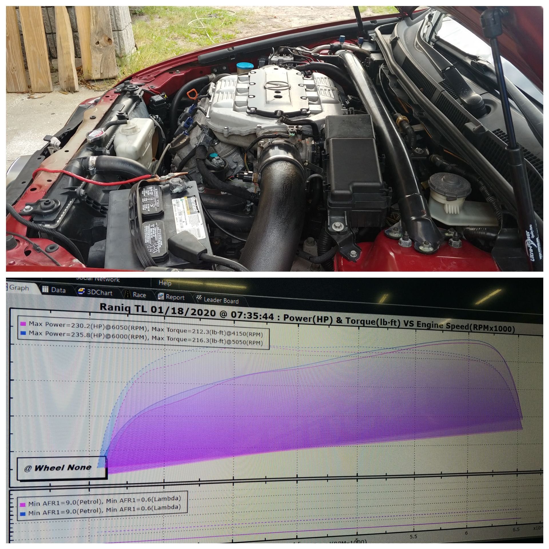

Reviving an old thread but here we go
TL model: 07 Base Auto
Mods: RL Cam swap, 3.7L Intake manifold & TB, 3.5" intake pipe. Untuned
Dyno: Dynocom 5000FX
100% Stock - 214whp @ 205ft lbs
After Mods - 235whp @ 216ft lbs

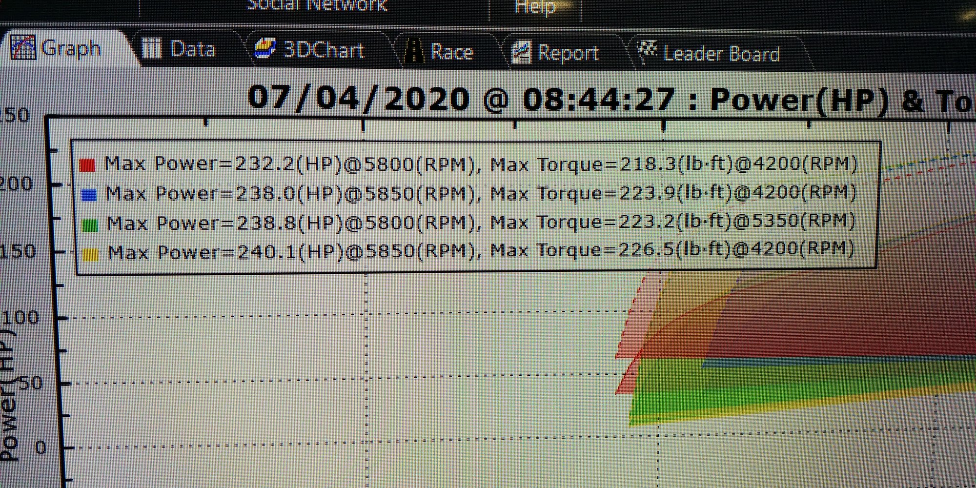

Mild update.
Since the last post I got an MDX manifold spacer, gutted the pre cats, left the 3rd cat and installed a stock diameter Ralco RZ lightweight crank pulley. Bumped me up to 238-240whp. Gunna get exhaust and try the ported runners and see how far I can get untuned.
