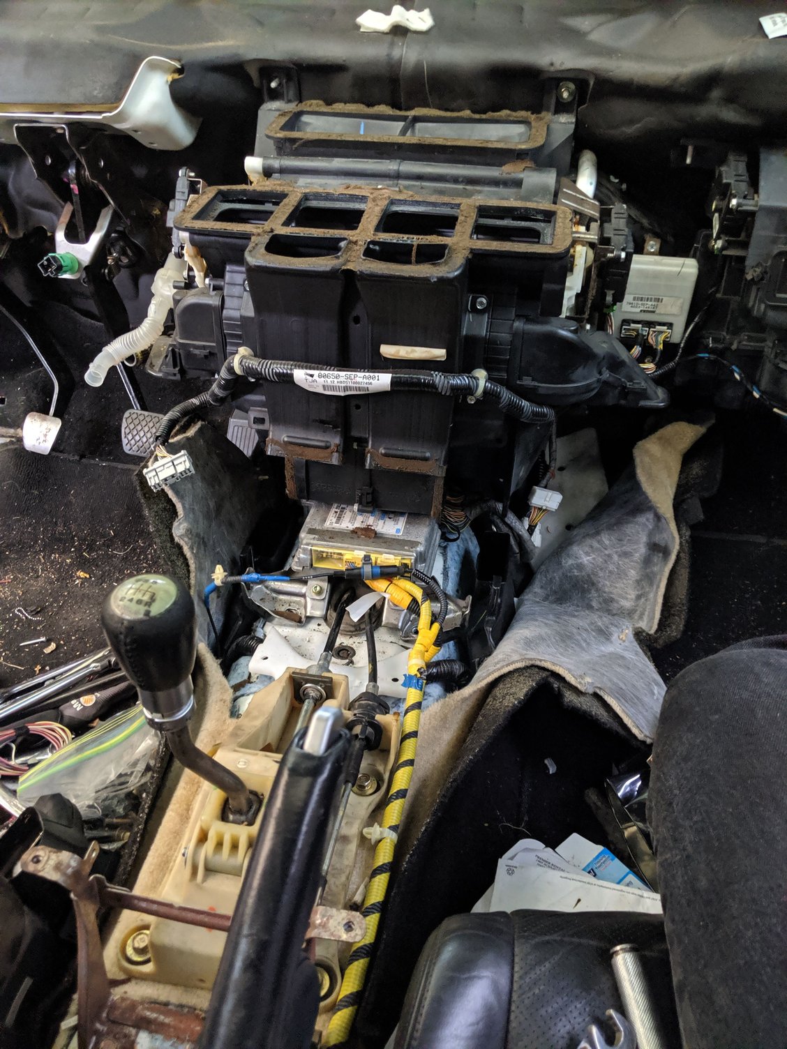

Empty engine bay
Engine with Auto tranny removed

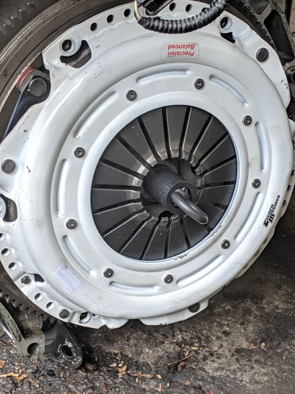

Clutch Master FX250 clutch
pedals are in
Have to deal with the stock shifter for now

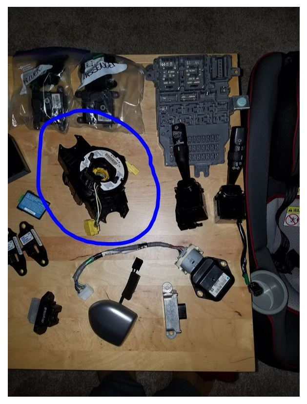

Yeah it works just more clock spring I have to replace spun the wheel around and and broke it
I have a clock spring from my 05 AT. Not sure if they are interchangeable but let me know if you are interested.
