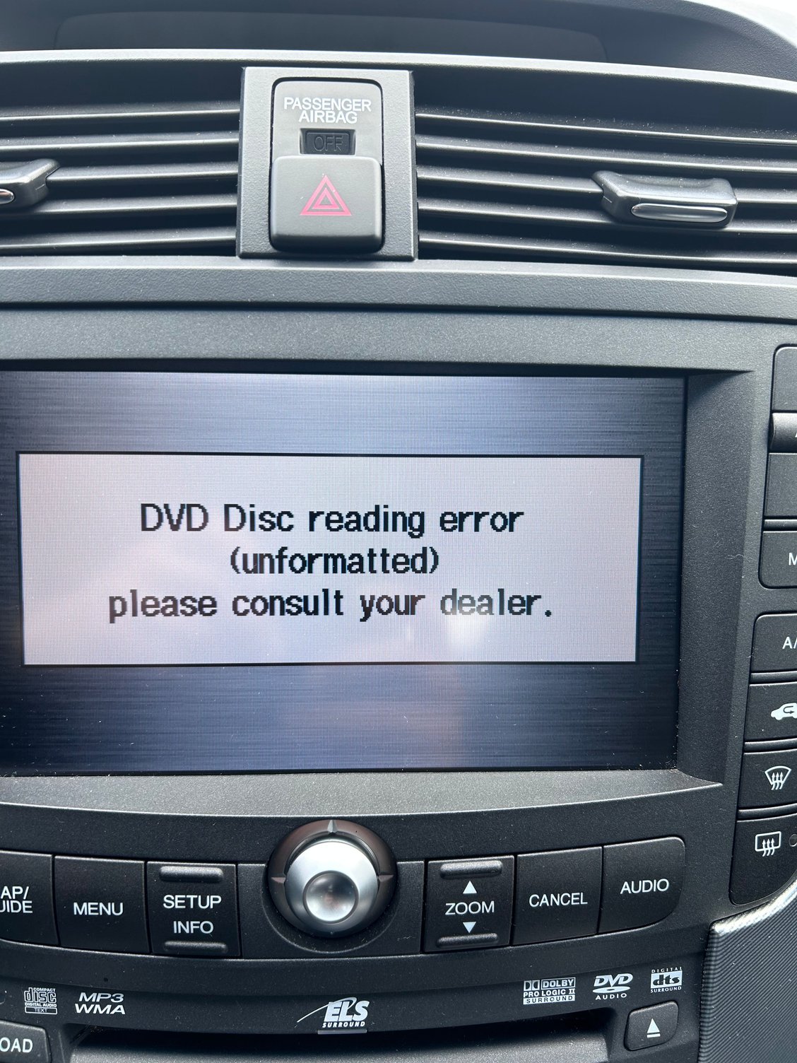

Hello!
who could tell me if this relates with the DVD disc or the DVD rom player? Thanks

check if the disk is scratched. If not, then the DVD drive has failed and needs to be repaired or replaced.

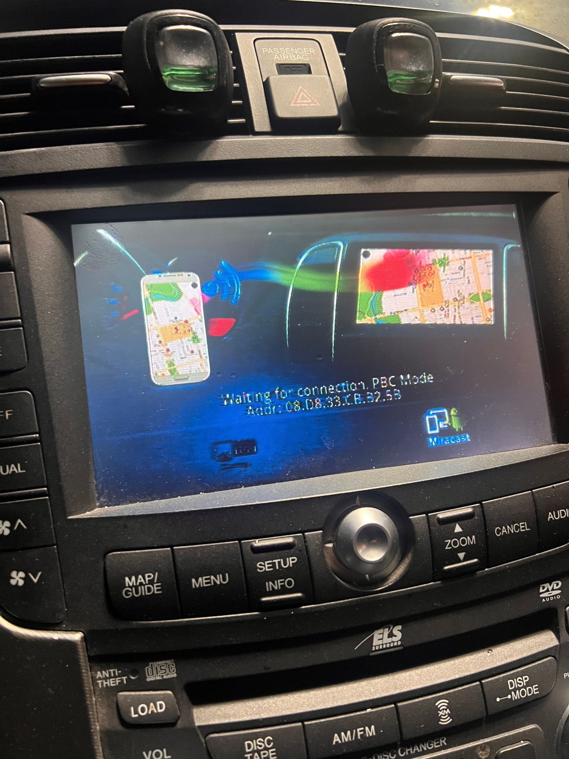

Navi says waiting for connection pbc mode
I bought my Acura tl a few weeks ago and Navi has been displaying this message from a Miracast waiting for connection pbc mode with an addr : 08.D8.33.CB.B2.5B
hey cs!
this is JimHow4545. I am driving my old 2007 TL while the X is in the shop.
The DVD is scratched. Any ISO image can be burn?
That, 100%, is not factory. Looks like some sort of aftermarket "screen mirroring" dongle or app, which didn't even exist in '07
You'll have to pull the radio out and see what doesn't look factory/OEM, and disconnect it. It'll be pretty obvious.
