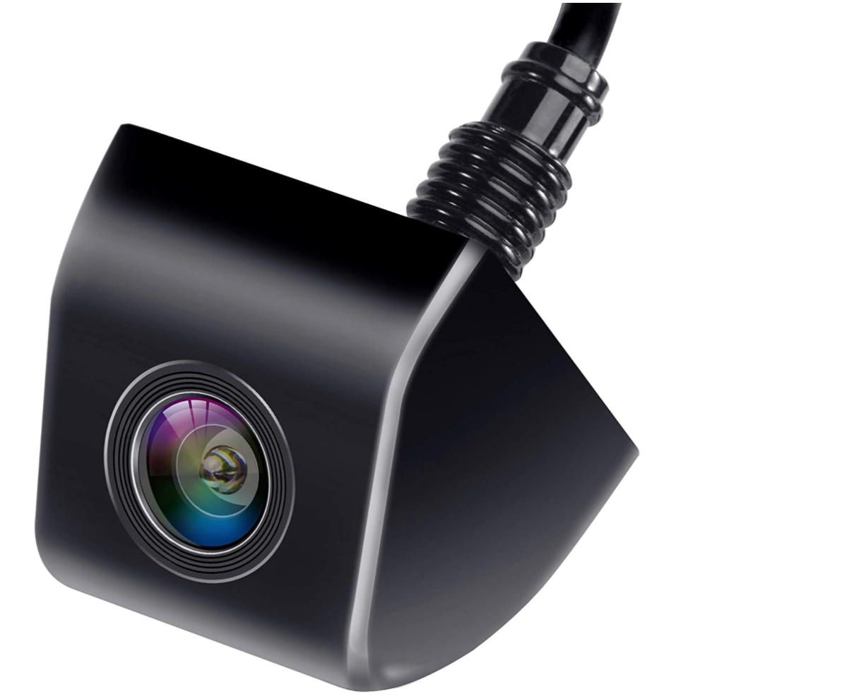

Where to mount backup camera?
[QUOTE=DMZ;16684524]Got tired of waiting for Acura to get off their asses, so I purchased a '07/8 screen and Nav DVD drive on ebaY. Got an adaptor for the screen from Martin in FL to be able to plug in (retrofit) the newer screen. What a difference! Not only does the clock and calendar now work correctly, but the new graphics and functionality are a dream. It's much faster on bootup too! I highly recommend those of you out there with an '04/5/6 TL with Navigation to do the same thing. You'll NEVER look back! An updated 2021 version of the white disk is coming out next month to boot!
I'm now have a TL with all the things we were supposed to have for 2004. Daytime running lights, a Backup Camera, '07/8 Turn Signal Mirrors, and the '07/8 Nav system.
could you please tell me where you mounted your backup camera? I have 2004 tl and bought a navtool navrgb 2.0 backup camera harness. Thinking of following ur suggestion to go with 2007 set up for nav and nav dvd. Per my instructions the backup camera harness works with 2007 to 2008 tl set up. Thanks for your posting.
Before drilling holes in trunklid for camera mount,
want to make sure I don't mess up. Thx
Paul, our star master mechanic here in Nawth Jerzy made a custom mount right above the license plate frame.

Where did you mount your backup camera pls?
Could you please tell or show me where you mounted your back up camera? I have a 2004 tl nav and am thinking of trying to put the 2007-2008 nav screen and dvd player in as you suggest. Thanks much for your post.

I bought one of these cameras from Amazon, then the whole frame where the license plate is I took it part. near the license plate lights I drilled a hole for it to mount.
Paul, our star master mechanic here in Nawth Jerzy, made a custom mount for the camera.
