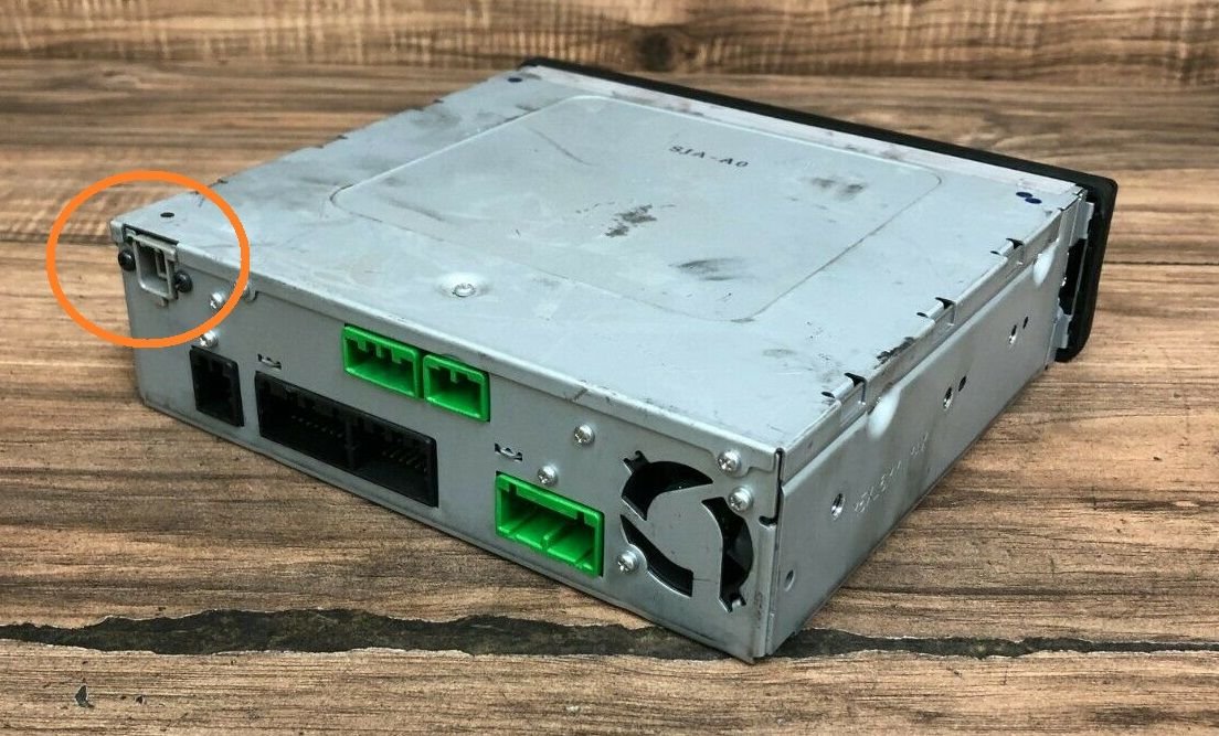

With the Navi firmware hack, yes... currently it just adds 20 years, which is close, but not quite correct. The hardware hack I did ( https://github.com/pdaderko/PIC-Proj...vi_Clock_Fix.X ) adds 1024 weeks, giving the correct date and time (though obviously significantly more difficult to install than popping in a new firmware update disc).
Regarding the GPS cable, the antenna is the small coaxial cable in the corner with a gray connector (circled in this pic grabbed from an ebay auction).
