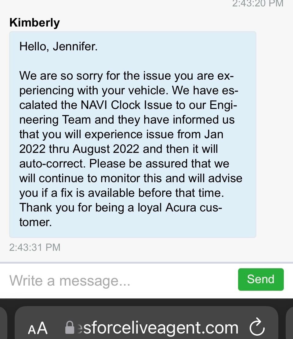

Acura already said there is no fix for it yet, just wait until august and it should be back normal. The real question would be August of what year? 2035 or 2050? Meanwhile are you interested on purchase the new Integra? LOL
lol exactly.
Us '04 owners got the same answer about it being 'looked into' and they were 'aware of it' years ago. nothing was done about it
Now Acura is resorting to 'put up with it to such and such a date and it will fix itself'. AKA 'we arebt going to do aything about it'
And if it doesnt fix itself, Im sure there will be more years of the 'we are looking into it' response.

Originally Posted by Velocifero
Please be assured that we will continue to monitor this and will advise you if a fix is available before that time. Thank you for being a loyal Acura customer."
I replied "Strange," to which she replied: "Yeah, if a fix becomes available you will be notified."
'IF' a fix becomes available? Thank you for being a loyal Acura customer?
Just how many of us so-called loyal customers do they really think are likely to stay loyal after this?
This kind of thing is something Lexus would swoop right down on and have a fix post-haste, or better yet, would properly design their systems to never have this problem in the first place!

Chatted with Acura about issue
Originally Posted by Dan King
Same here. Never had issue before last time change and always able to manually adjust the time through the navi menu. Tried reset as well manual adjustments don't do anything. Clock on navi menu just says 00:00. A resolution would be nice.
Seems there will be a fix in August

https://acurazine.com/forums/third-g.../#post16791159
So based off the latest bulletin there is no fix from Honda/Acura other than to disconnect the battery or wait until August?
Old Jan 25, 2022 | 02:11 PM
  #436
Posts: 48,312
As expected.. they'll just sit on their hands and tell us to "wait until August". what a joke
Old Jan 25, 2022 | 02:25 PM
  #437
Mizouse's Avatar
Posts: 64,124
Likes: 3,377
Also is it only an 07-08 TL issue? What about 04-06 TLs with Navi?
Old Jan 25, 2022 | 02:49 PM
  #438
ex_hacker202's Avatar
Joined: Feb 2009
Posts: 91
Likes: 11
Thanks for the link to that service bulletin Mizouse - odd that you have to disconnect both battery terminals at exactly 12:40 pm and reconnect at 1:00 pm to get this procedure to work. I have a sticky note in my car manual labeled "bad things that happen when you disconnect the battery", will have to look thru it to see if it's worth having to change all those settings back to where I want them just to correct the clock. Also saw this is the SB - DST automatic adjustment will be broken forever?
What can we do to avoid the time changing to an incorrect value again after August 17, 2022?
The automatic DST function will not work properly causing the incorrect time at the perceived DST date. We recommend
that after August 17, 2022, the client sets the “Auto Daylight Saving” function to “OFF” and adjust the DST manually.
