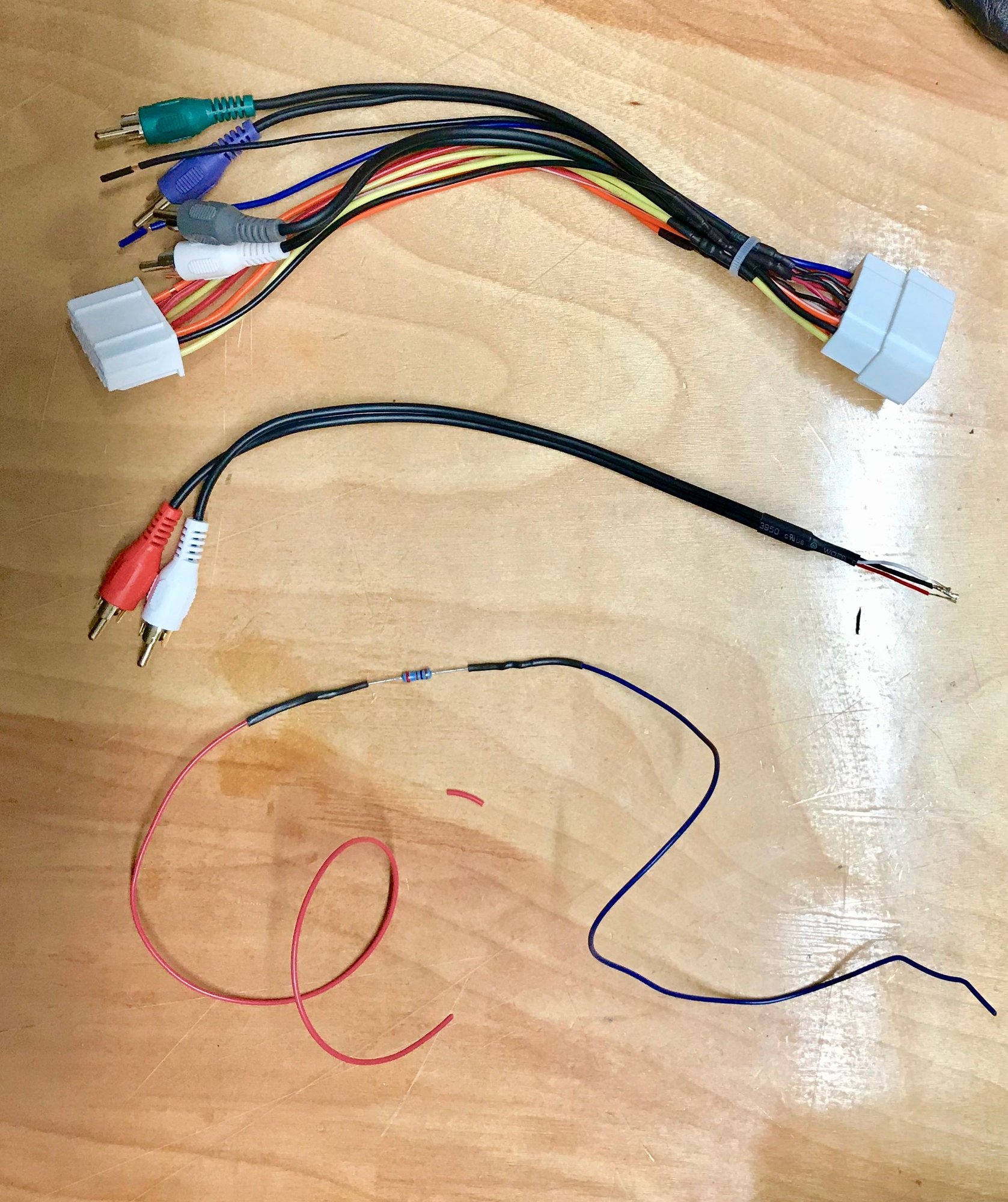

ii have a wiring kit that I never used. I also soldered up a 100 ohm resistor which is needed to get the navy to work. This kit will use the preamp outputs from your head unit only. Includes the cable to go to the factory sub. Also has the face plate and mounting brackets.
for the steering wheel controls u still need to get a separate interface kit
if interested pm me.

BillMFD3,
Any particular reason you are using a 100 ohm resistor instead of the 68 ohm resistor that has been mentioned in multiple threads.

Originally Posted by wlbolton
BillMFD3,
i have various resistors and a bunch of 100 ohms on my work station and it worked for my own car. Got my nav working without issue on 2005 TL and pioneer head unit.
