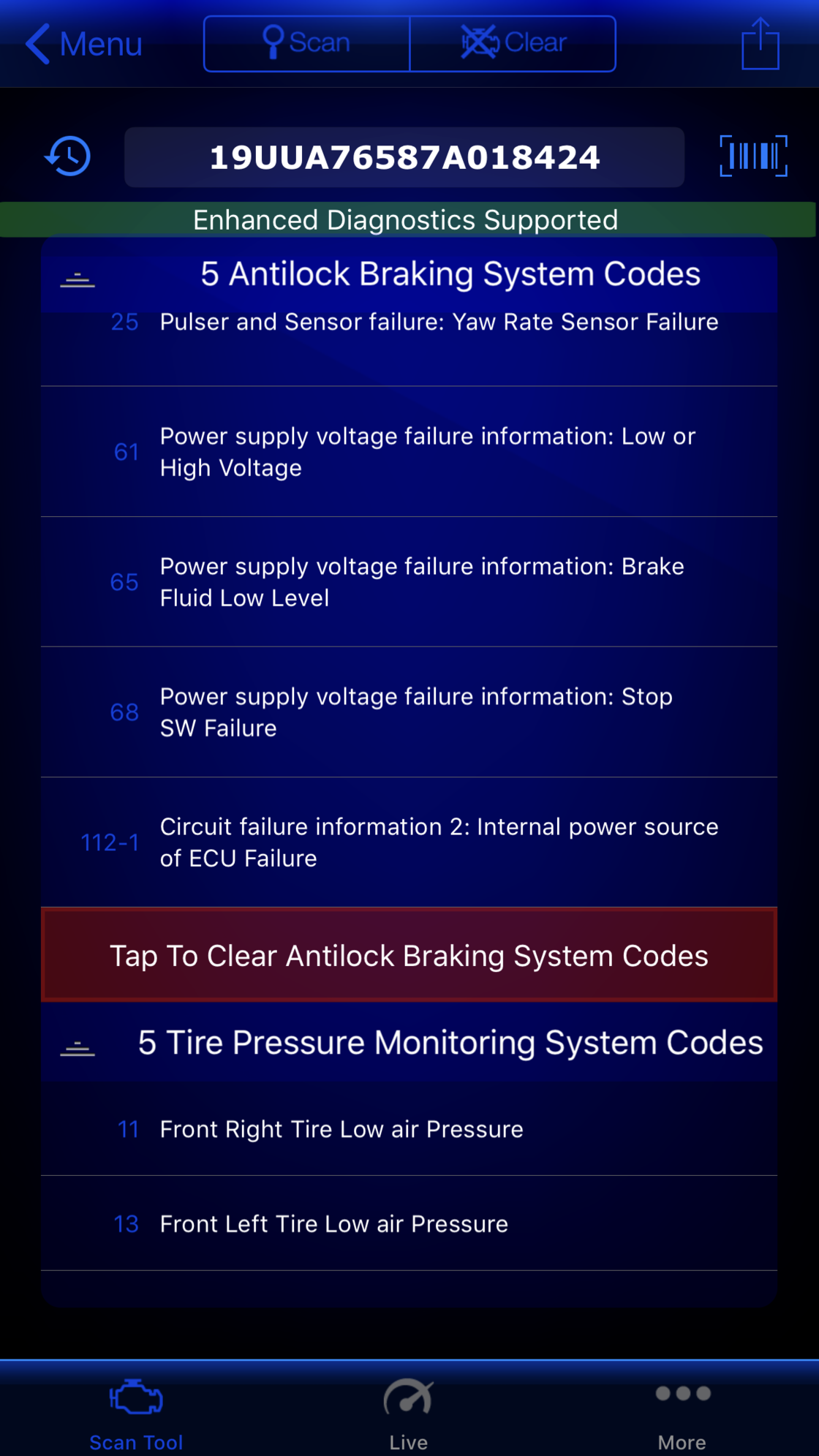

So I recently purchased a 2007 Acura TL type s automatic with 90k miles. The engine and tranny were very well kept but I have electrical issues. First I have 5 abs, 5 tire pressure monitoring system codes, 3 memory seat codes which I’m not worried about because I know my mirror actuators are bad. And 1 Honda information platform code which is my hands free link that I disconnected. I really just want to know how to fix the abs codes and tire pressure codes. Any advice will help, I’m really having buyers remorse and I feel sick to my stomach every time I look at the codes.

I would start with checking the battery, alternator, and all of the cables before doing anything else. Low voltage can cause some seriously wonky codes to be thrown. Once those are confirmed to be good and stable, then you start digging deeper to the other codes.
