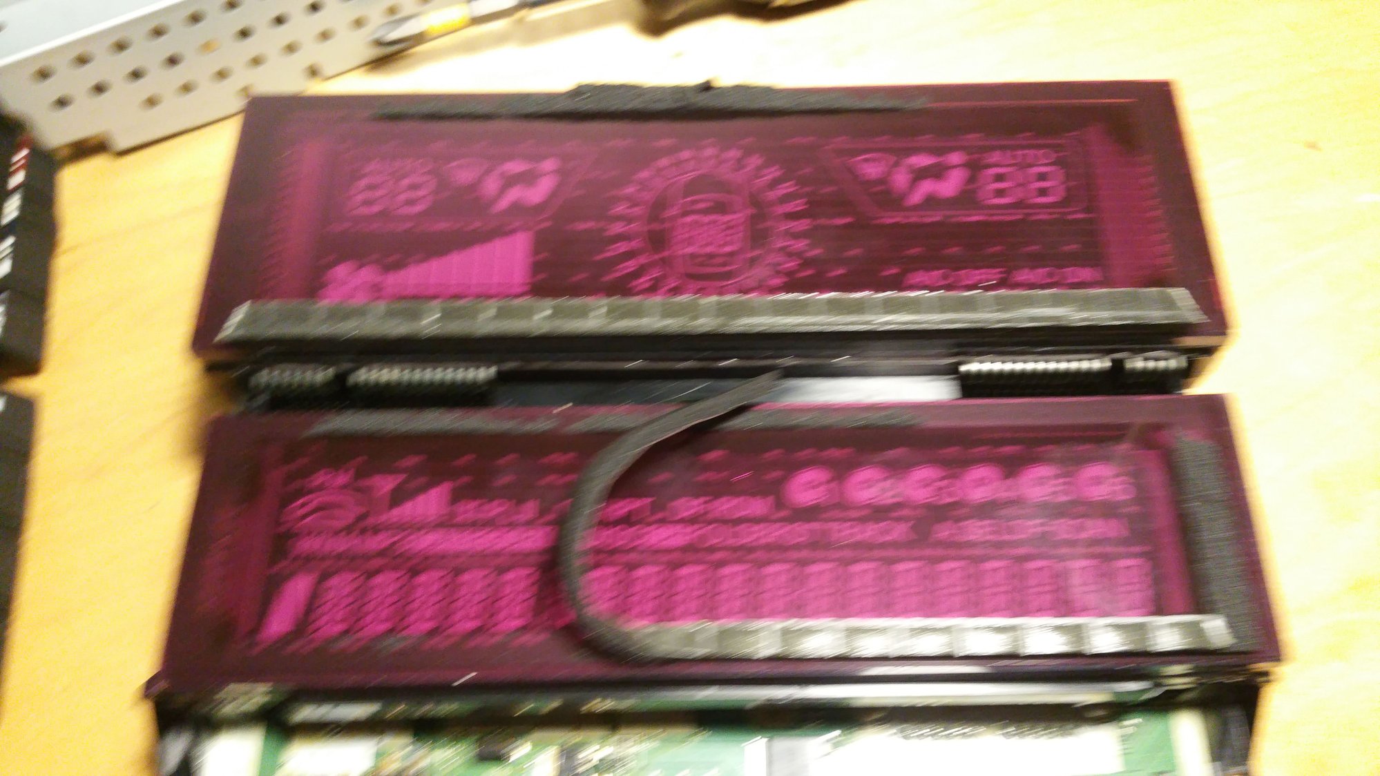

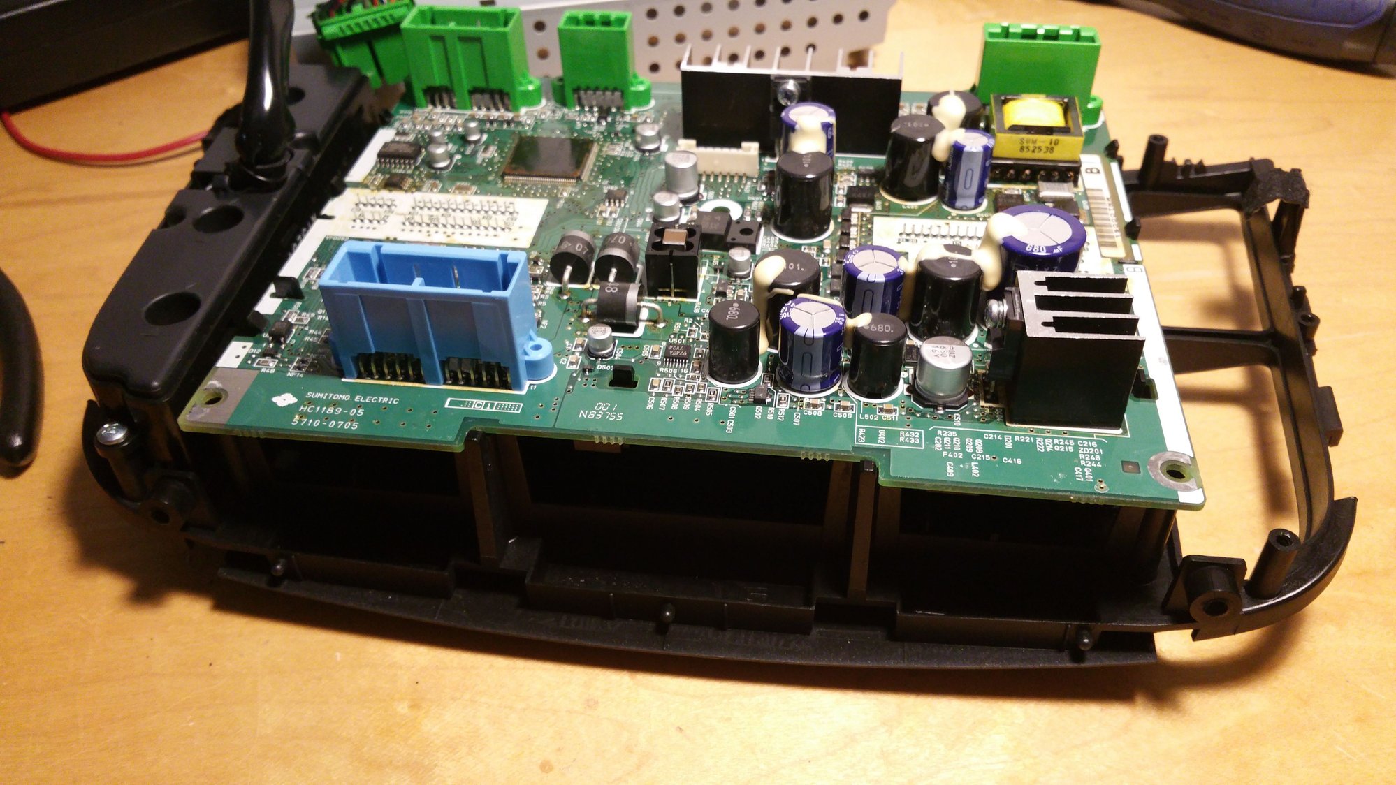

How did you separated board with displays from the plastic bezel? I'm sitting on this step and I'm kind of afraid to pull it harder - don't want to break anything.
Old Dec 15, 2016 | 04:29 PM
peter6's Avatar
Joined: Apr 2016
Posts: 1,552
Likes: 498
Never mind. Displays are hold by double sided tape. I removed the plastic cover and pushed them out by placing fingers directly at the display. They are actually protected by some plastic so it doesn't get damaged.

Relocating the old display is the hardest. Not the soldering part, but trying to fit plexi to fit the bezel.
For now I did cut out displays and I'm trying to figure out how to put plexiglass to the rest. I tried to heat it and bend it but without good form it will be ugly. I will do it flat like the projectwidow.
From my plexi square I have three attempts. Tomorrow I will try to cut them out and grind edges with sandpaper until its shape will be same as bezel left after the drawers.
I'm making a lot of photos, but most likely I will post them in this thread
'07 and '08 displays are easier - it seems like backlight is included in the display (no leds on the board), and some of the pins are connected with each other (meaning less wires).
