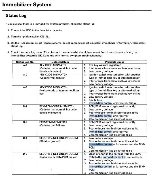

There is another option, try the in town Honda dealer again.
Here is my point:
The image below comes from the Acura 07-08 TL factory service manual.
If you look at #3 in the process of checking the 'Status Log' below it states specifically:
'On the HDS (Honda Diagnostic System) screen, select Honda systems, select immobilizer set-up, select immobilizer information, then select status log.'
It (HDS) does not distinguish between separate Acura & Honda systems only one Honda system (used for Acura as well); therefore, one would think the (HDS) Honda Diagnostic System that your 'in town' Honda dealer employs daily IScapable of solving your issue.
You just need to talk to the right person.
I would go to the Honda dealer, in person, and explain your situation & make a point to talk with a service supervisor / manager to see if they can help you.
